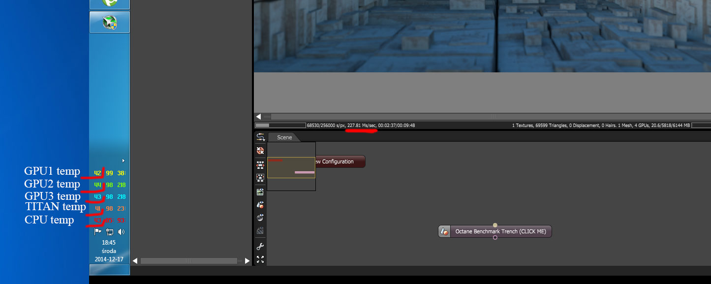

DL, coherent ratio 1, path term power 1, octane 2.14
GPUS OC: 1228mhz on core, 7000 mem
227.89 ms/s
temps 41-44C, water temp 35C
