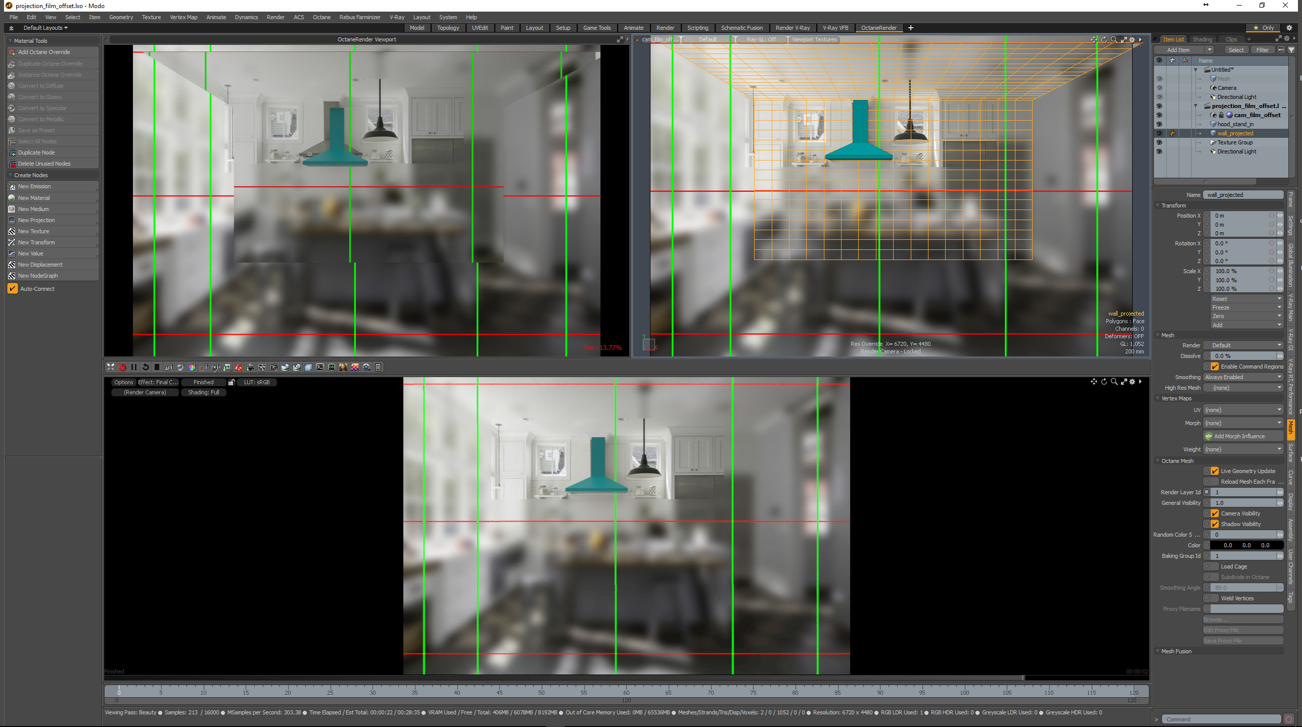

Camera projection error. Camera is projecting on a mesh and it is also the render camera. The camera has a film offset and Octane is set to use the MODO camera film offset.
In the viewport OK
In Preview OK
In Octane it's wrong.
Example scene included. Really need this functioning properly to hit a deadline.

face_off wrote:camera projection film offset support has never been supported by the plugin, so expecting a new feature to be implemented so that you can meet your production deadline is asking a lot :-)
Paul
Paul,
In previous bugfixes dealing with the projections I must have read into things too much and understood that film back support would also be available on the projection camera in addition to the render camera. It's a fringe feature but important as soon as you have film offsets on the render camera, most projection workflows then depend on it.
Whatever you can do would be most appreciated.
In the viewport OK
In Preview OK
The following build will hopefully resolve this issue for you. A huge "thank you" to Funk who worked out the formula to correctly calculate the texture offset from the camera film offset.
https://render.otoy.com/customerdownloa ... _64bit.exe

- The Modo Camera Film Offset X & Y channels are now applied to Front Projection textures

- Resolved issue where the Modo FOV was not being taking into account when camera projections with film offsets

Paul and Funk thanks so much! Exactly what I needed and fast fix too !
The projections are now working correctly with film offsets. This is going to be very useful to match real world tilt shift lenses.
