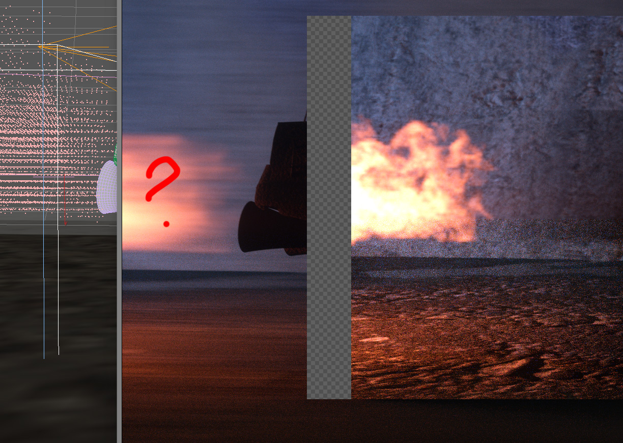

There is also another problem with vdb when it is attached to a moving object. It does the opposite motion blur. When vdv is attached to a moving car, for instance, and a camera is also linked to the car then flames should not have any mb but they do. The same problem was with itoo forest. Thanks

Temporary issue with the Phoenix license; nevertheless, I have forwarded your issue to the developers.

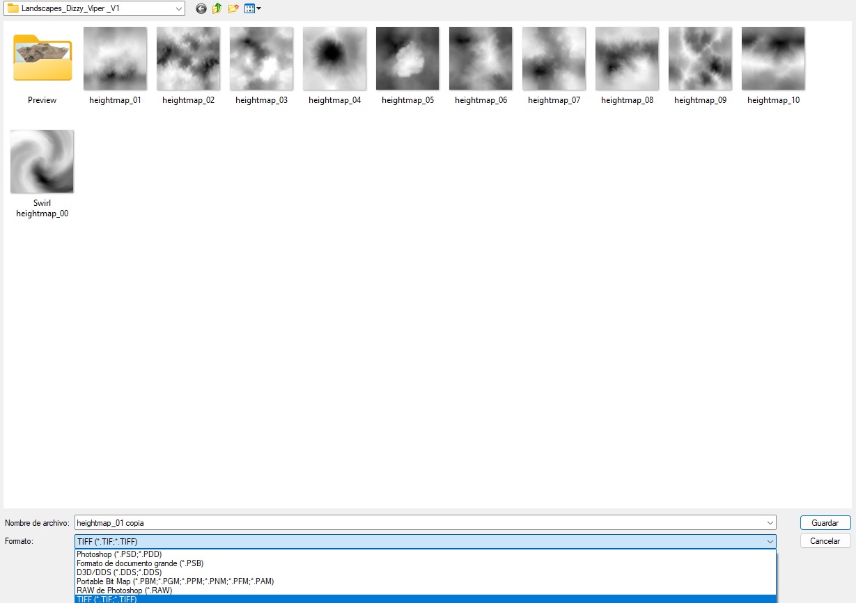

coilbook wrote:
merid888 wrote:Does anyone have this problema with heightmap ?
Appear Image I/O error
Thank you if someone can help me
Try jpeg instead of tif
Hi coilbook I can't save the original map like jpg or png, Photoshop don't have this options in your format.
Add image like reference.

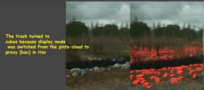

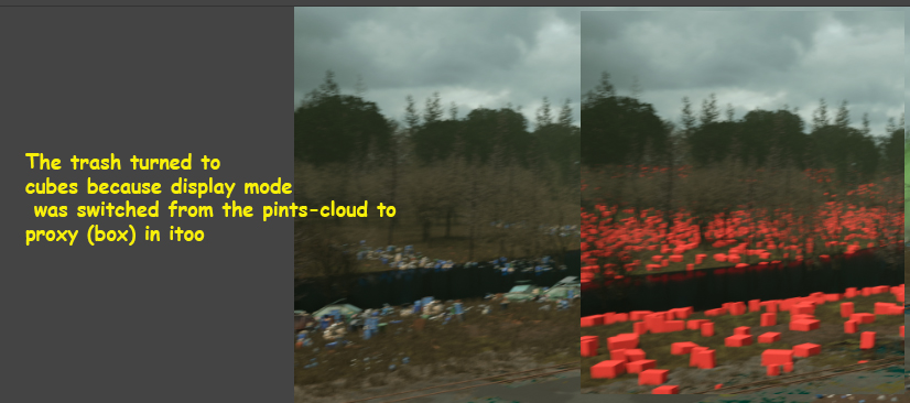

1. Sometimes during complex scenes octane crashes network adapter in the master. Not sure if they cannot handle too much of octane data transfer (net traffic is minimized). We tried 3 different adapters they crash during complex scenes.
2. Bug with itoo sometimes octane renders itoo as actual itoo proxies if points-cloud not used as a display mode. When using legacy mode for itoo sometimes it wont even render itoo unless you refresh. Direct mode is slow due to rebuilding and eval times every frame

merid888 wrote:
Maybe collapse the layers and try to save as jpeg or find tif to jpeg converter
