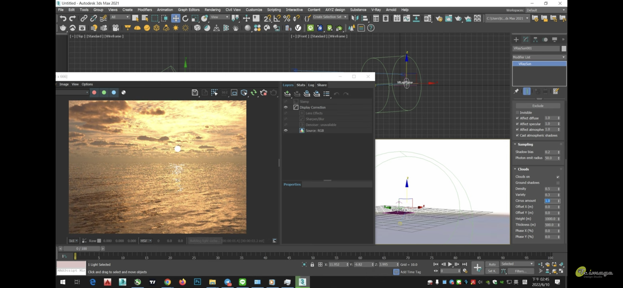

Any hopes to get procedural layered fog and cloud system? You already have mesh too fog in place. Vray has cloud atmosphere and blender got layered fog.
Vray has a very nice easy to use cloud system. Would be nice to have the same.
Thanks.

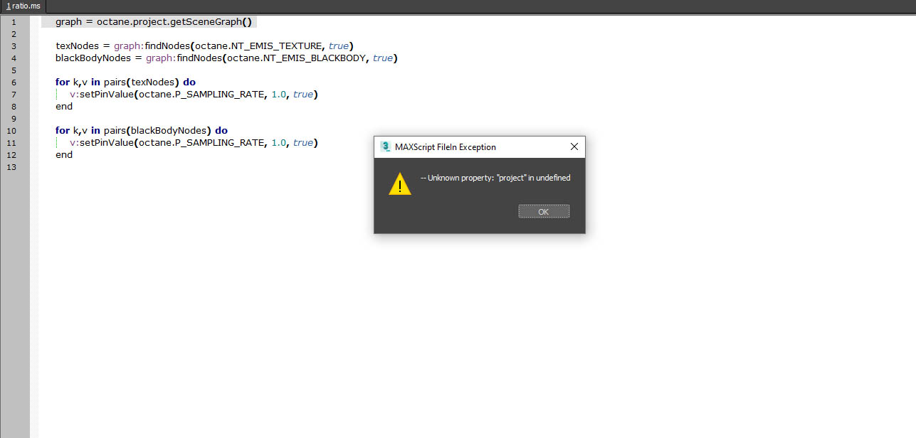

coilbook wrote:Hi Karu,
Can you please add a checkbox next to AI light set all lights sampling rate to 1? That way if we have noise problem with manual sampling rate per light we can try ai light and default all lights in the scene sampling rate to 1 including light textures Thanks
This is not my area of expertise; maybe someone else can chime in on any plans in this area.
@coilbook unsure if this is helpful, but you can use this script to do that in the mean time.
Code: Select all
graph = octane.project.getSceneGraph()
texNodes = graph:findNodes(octane.NT_EMIS_TEXTURE, true)
blackBodyNodes = graph:findNodes(octane.NT_EMIS_BLACKBODY, true)
for k,v in pairs(texNodes) do
    v:setPinValue(octane.P_SAMPLING_RATE, 1.0, true)
end
for k,v in pairs(blackBodyNodes) do
end
I get this error

coilbook wrote: I get this error
The script posted earlier is not a MAX script, it's a Lua script for Octane standalone.
