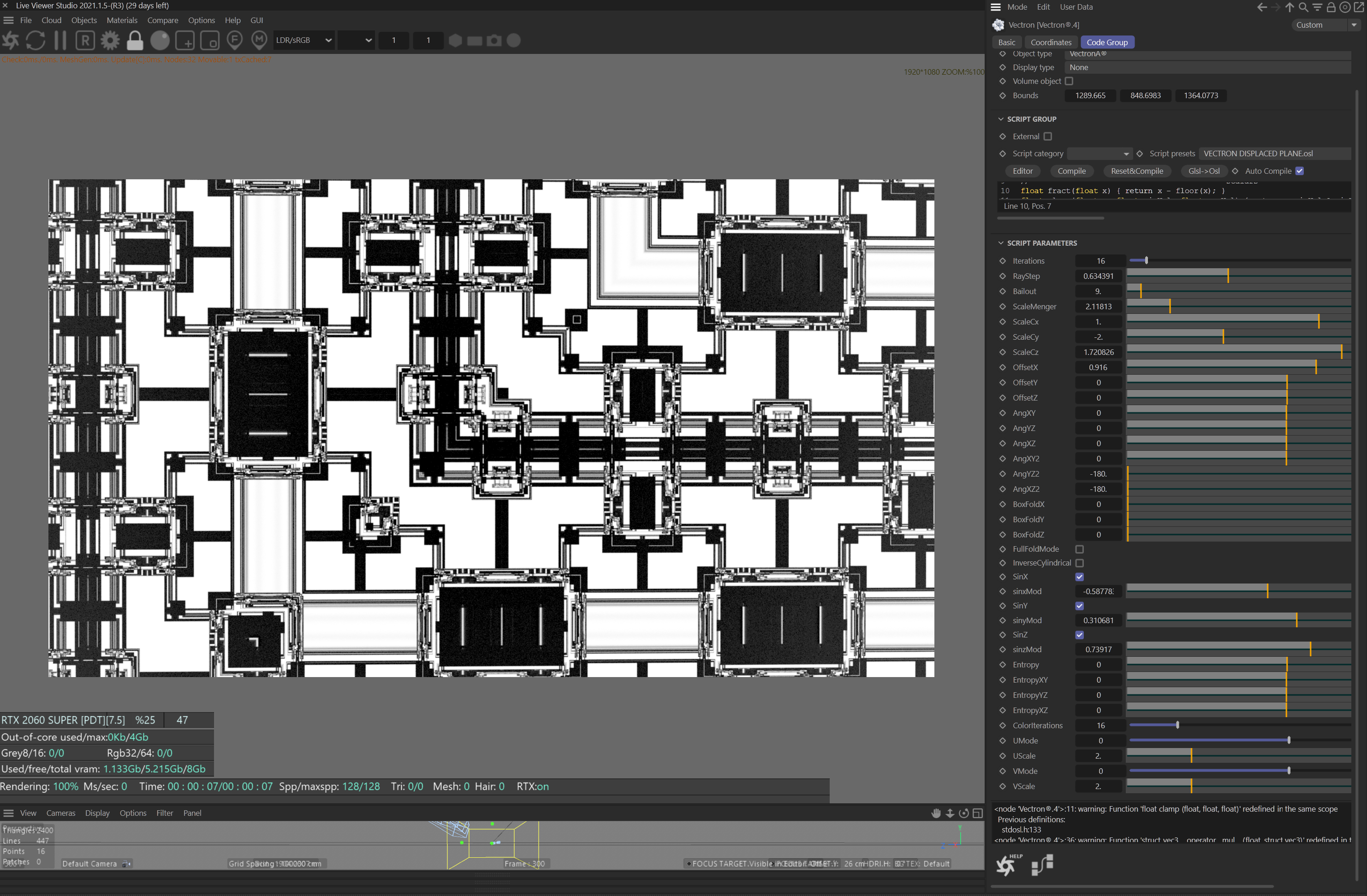

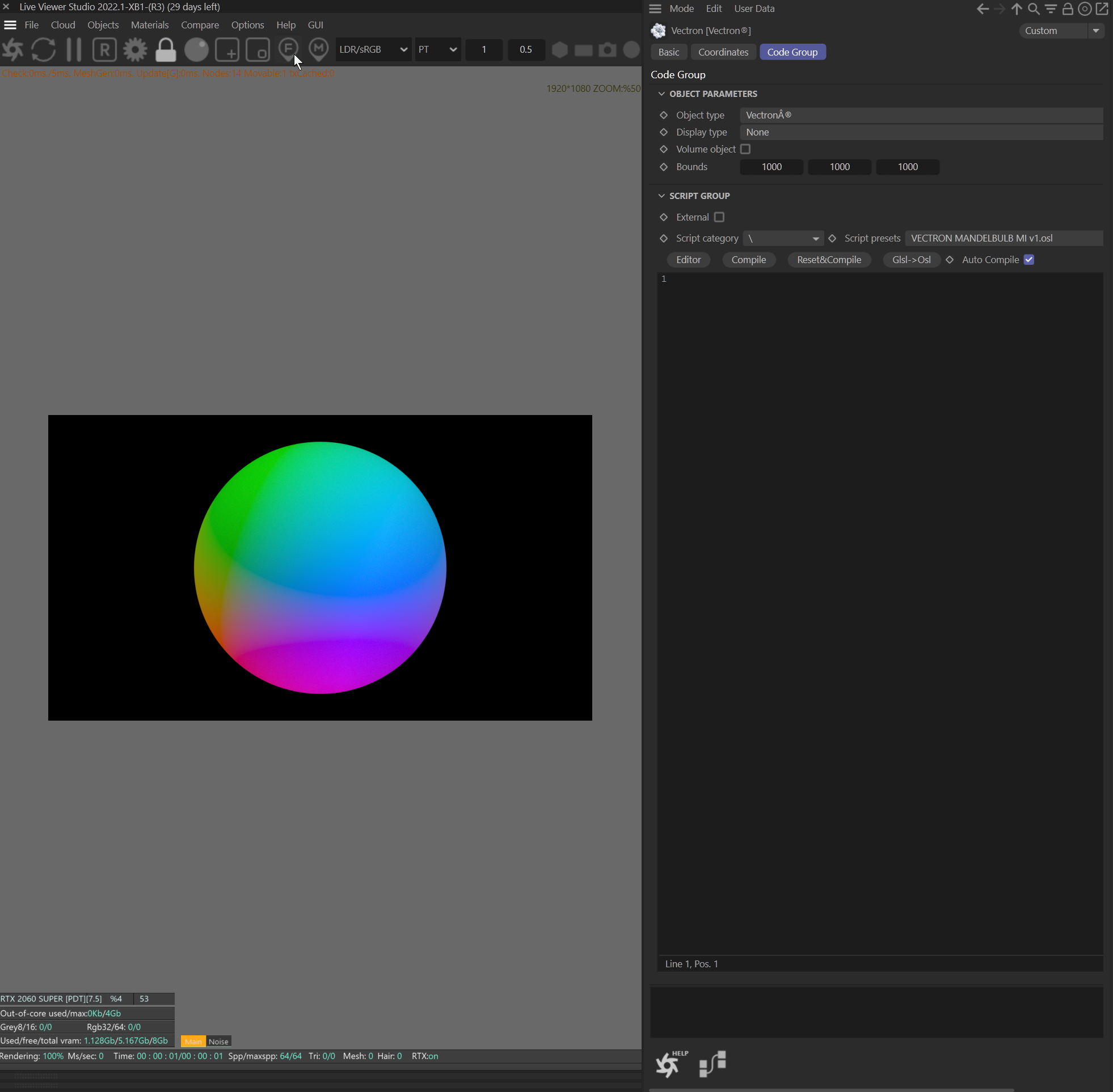

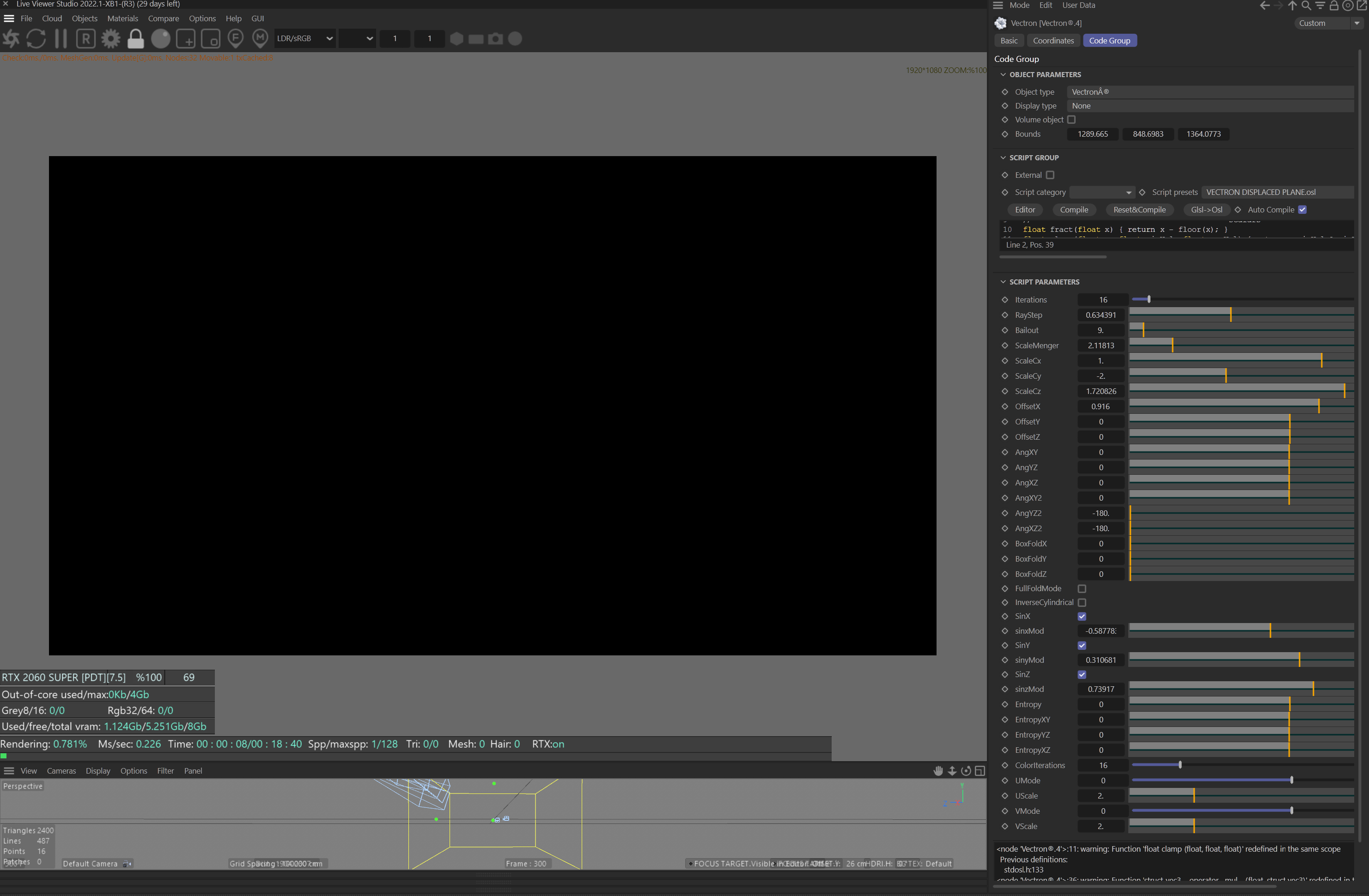

2022.1 XB1 C4D seems to break all my Vectron projects that work in 2021.1.5 R3, and just doesn't want to load Vectron scripts period besides the init sphere. Also, when the compiled Vectron script has a bunch of parameters, it shrinks the code entry window which can't be resized, is that fixable?
loading scripts not working
same project doesn't work in 2022.1 XB1 R3
working Vectron 2021.1.5-R3
Posts: 16068
Location: Türkiye
GXGsynth wrote:2022.1 XB1 C4D seems to break all my Vectron projects that work in 2021.1.5 R3, and just doesn't want to load Vectron scripts period besides the init sphere. Also, when the compiled Vectron script has a bunch of parameters, it shrinks the code entry window which can't be resized, is that fixable?
Do you know the writing OSL or just copy/paste something? Did you check the log output to see results? Just send me your project with PM if you don't know to check.

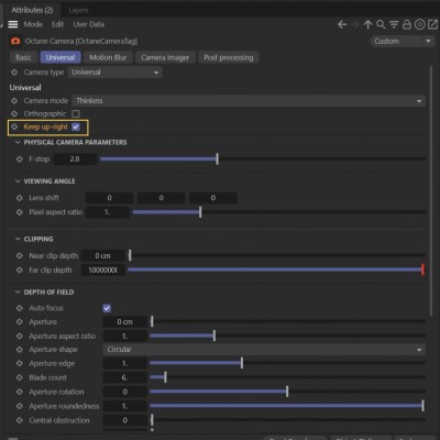

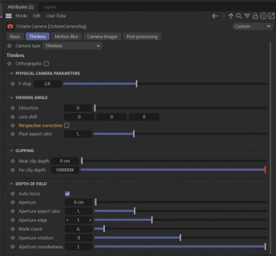

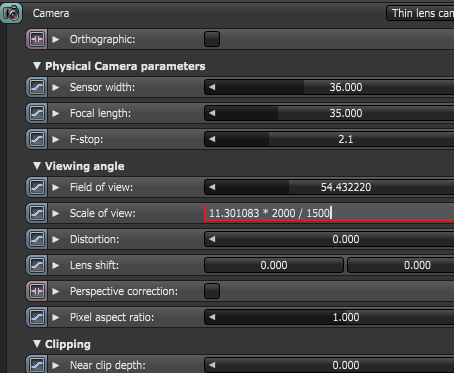

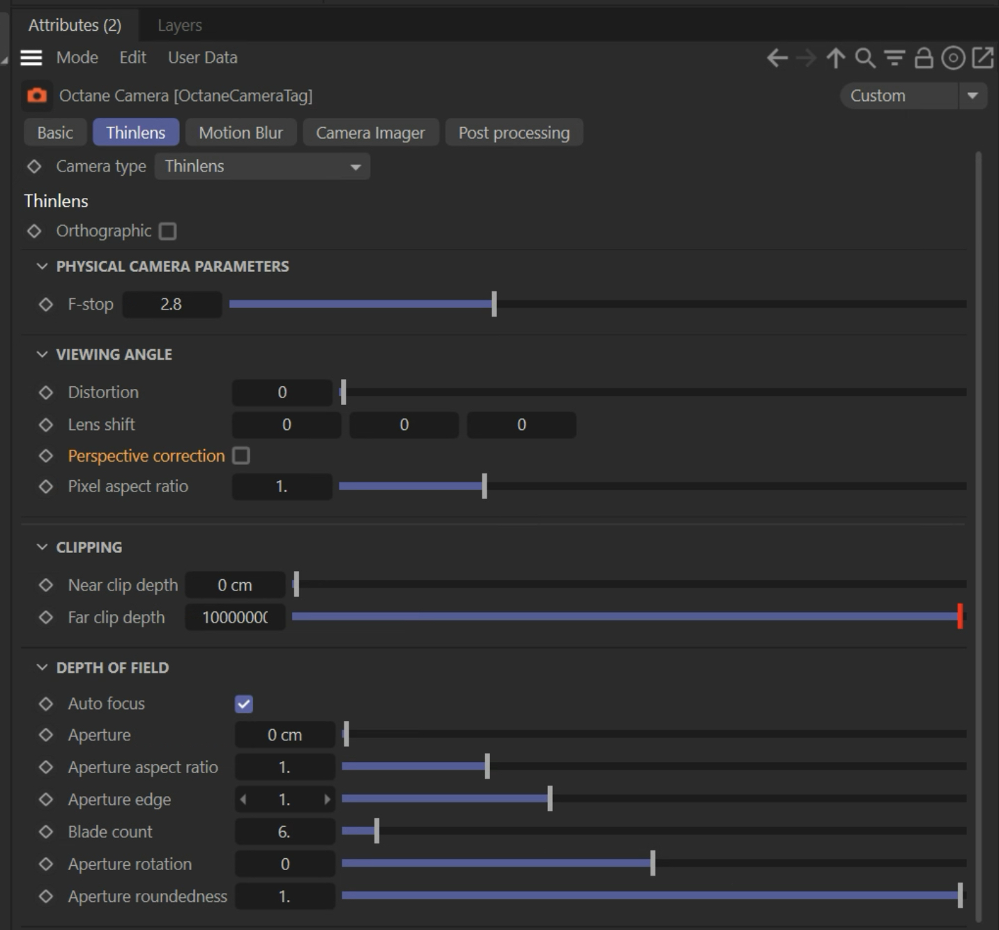

I noticed that C4D plugin doesn't have two camera options from Standalone - Perspective correction in Universal Camera and "Scale of View" which can help using overscan feature.
Architectural Visualizations http://www.archviz-4d.studio
Posts: 10646
About Perspective Correction, you can find it under the Viewing Angle section of the Octane Camera tag:
About Scale of View I have already answered you here:
viewtopic.php?f=9&t=79909#p412938
ciao,
Beppe

bepeg4d wrote:About Perspective Correction, you can find it under the Viewing Angle section of the Octane Camera tag:
ciao,
Beppe
Hello Beppe, he is talking about a universal camera, and you give an example with a thinlens camera. There is no perspective correction option in the universal one.

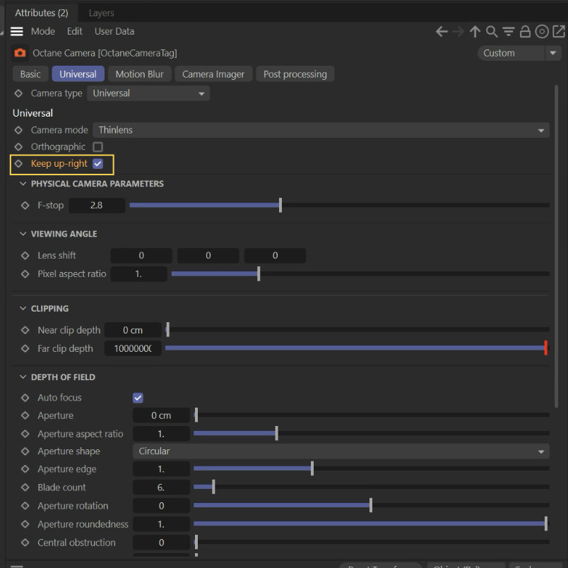

The attachment A89493CF-63D2-4B11-94AB-A05F65B66433.jpeg is no longer available
ciao,
Beppe
Oops, sorry, didn't notice it was about Universal camera.
In this case, the Perspective Correction is named Keep up-right:
ciao,
Beppe
