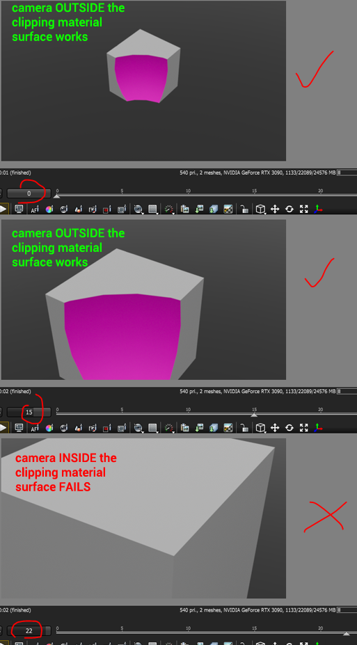

BUG: Clipping material stops working if camera is inside surface
I have an example with an animated camera moving closer to an object, which eventually goes INSIDE the surface that has the clipping material.
Once the camera is inside the surface (frame 22), the clipping material stops working
clipmat_001.orbx
(126.18 KiB) Downloaded 270 times

funk wrote:BUG: Clipping material stops working if camera is inside surface
I reported this behavior in closed BETA. The team told me fixing this could potentially increase rendering times. I suggested a switch to turn on/off rendering clip when camera is "in". I don't know if they plan on implement it.

wallace
Posts: 194
Joined: Sun Dec 18, 2016 10:38 pm
Regards,
EDIT: What I wish to see, in addition: to have Octane default materials set intersection priority to "0". It is easier to set one clipping material to a value higher than "0" than to reset individually all scene's materials bellow 100...
The camera will be fixed before the final stable release.
For your last point, the materials' default do have a priority of 0 by default (not 100), only the clipping material has a default of 100 priority. At least this is the way standalone is doing it.
