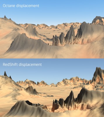

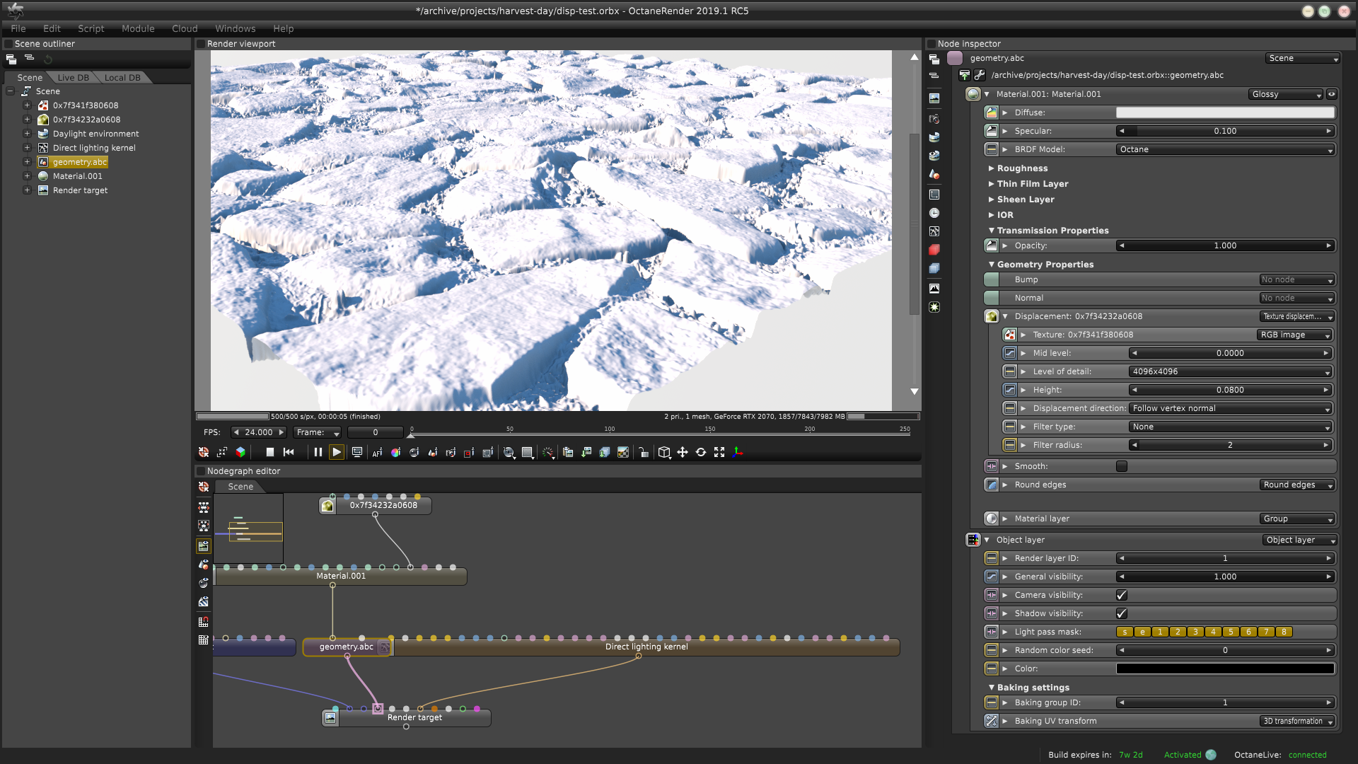

Looks like you have the level of detail set too low, here it is set to 256x256:
Here it is set to 4096x4096:
Adding subdivision will not affect it as Octane is scaling the displacement image and applying the displacement after.
Jason
Jason
Linux Mint 21.3 x64 | Nvidia GTX 980 4GB (displays) RTX 2070 8GB| Intel I7 5820K 3.8 Ghz | 32Gb Memory | Nvidia Driver 535.171
No, in this example i use 8k texture and 8k disp level of detailgrimm wrote:Looks like you have the level of detail set too low, here it is set to 256x256:
Jason

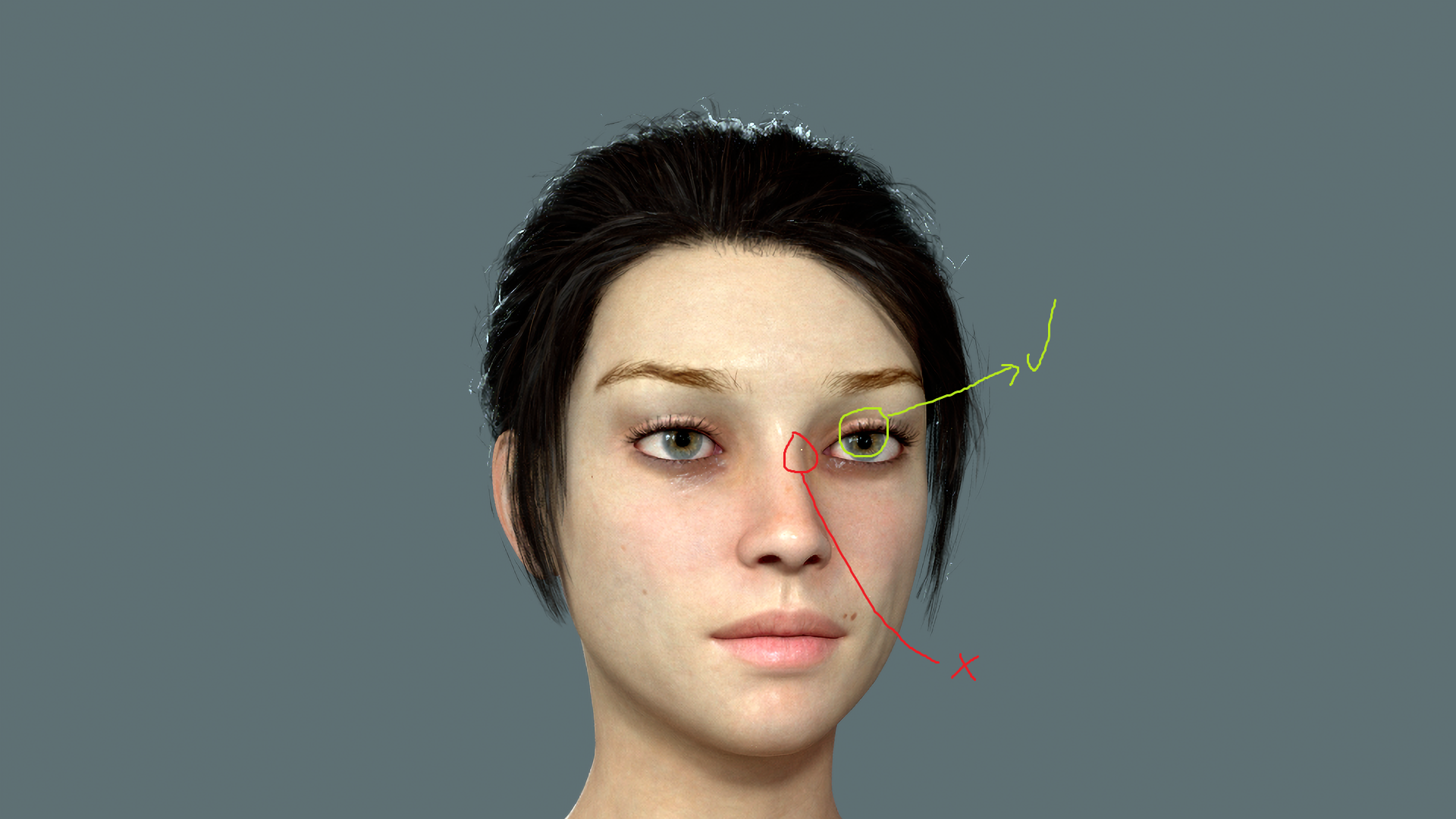

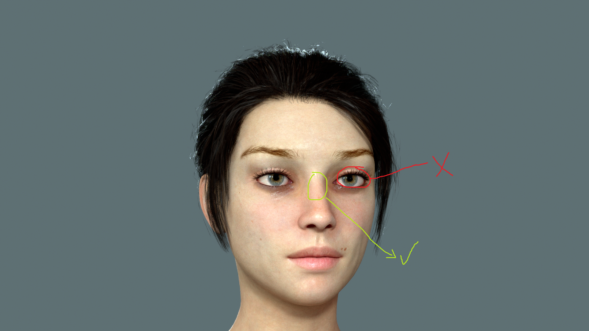

Hey Otoy - how about this...
Could we have a material option to allow for Hotpixels, with Hotpixel at Max (0.00)?
Could be a boon for animating frames at max speed with a lower sample count.
Sometimes if I have character renders I get spec hot pixels on skin (accidental) and also on eyes (purposeful).
Now, if I reduce HotPixel in Imager for the skin, it also then reduces spec for the eyes.
These renders took me 1 second with 2x2 upsampling and denoising
But - if there was away to tell the Imager to exclude reducing hot pixels on certain materials, (ie the eyes)...
OMG!...this would solve a lot of issue with trying to balance render time and denoiser and 2x2 upsampling.
Because you could crank the HotPixel removal for the whole scene and then still have sparkle-spec on the eyes, you know?
Or more!!!!
Could we have a layering of Imagers????
Where certain materials could get Imager-1, and then the other materials could get Imager-2.
That way you could apply denoising and hotpixel removal on some parts of your render, but not others!!!!
I am going to FAINT imagining this!!!!
Or more!!!!
Mobo: 1 Titan RTX, 1 Titan Xp
Plugs: Enterprise
Plugs: Enterprise
PS - next release - if I had these, I could DROP DEAD tomorrow and be HAPPY!!!!
