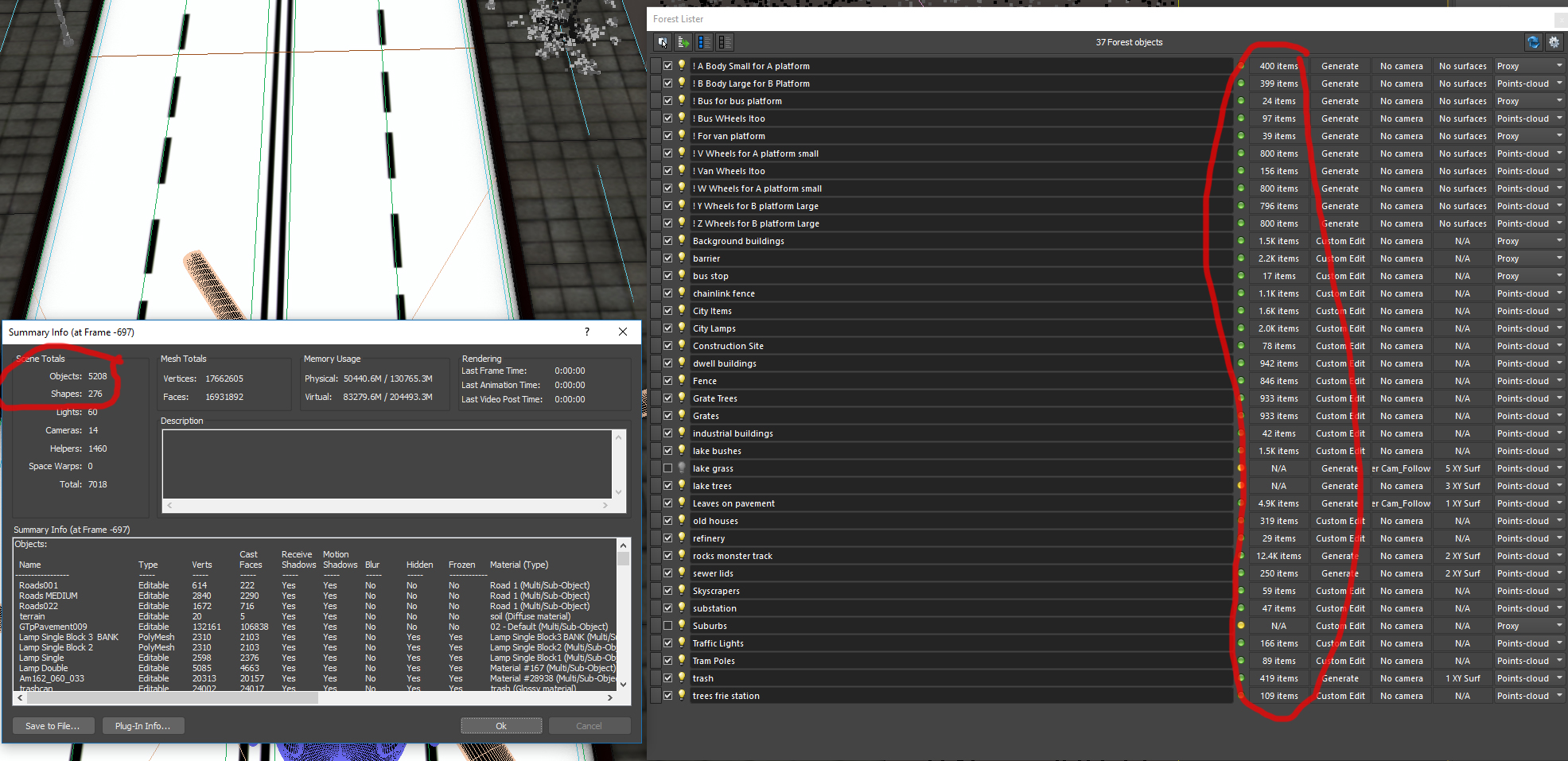

coilbook
Posts: 3176
Goldorak wrote:
coilbook wrote:
Goldorak wrote:
This is like octane 3 performance. Brigade had no eval times in fly though camera videos Thanks
Unless your scene is 100s of millions of unique primitives (in which case the copy to GPU will be the limiting factor), this does not seem normal. How big is your scene? Can you export to standalone/ORBX and confirm that it also happens there?
Thank you. The scene is massive. 2.3 gb just 3ds max. I will send it to you as PM. Maybe you can test it in 3ds max.
I really dont know how to export to ORBX I tried before it never worked.
How many unique primitives in this scene?[/quote]
The scene is pretty light 5208 objects plus some forest instances. Please see the image attached. So i don't understand why processing is slow. We do have some cars in the city that move. it is 25 seconds per frame to process. Thanks
