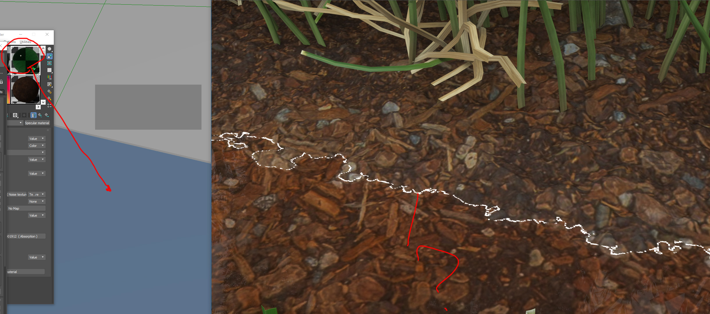

coilbook
Posts: 3176
Hi Octane always had this problem since version 2. When water plane touches shore there is a white line where two planes intersect.
HHbomb
Posts: 1438
Do you have alpha channel checked ?

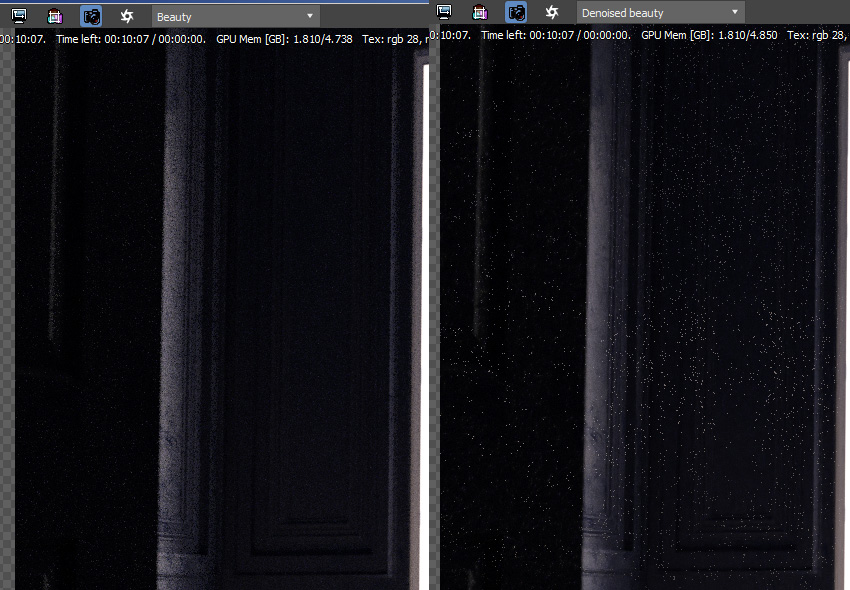

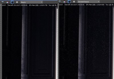

Posts: 585
Joined: Sat Feb 27, 2010 8:01 pm
I never had such issue with the Denoiser so far as it now produce Fireflies, if this has been already addressed for the forthcoming update ( RC 5 ) please disregard , I exported the scene on the standalone ( RC 5 ) and had no issue as such....

coilbook
Posts: 3176
HHbomb wrote:Do you have alpha channel checked ?
Hi Yes
it seems that when a water plane (specular material) intersects terrain I always get this white outline.

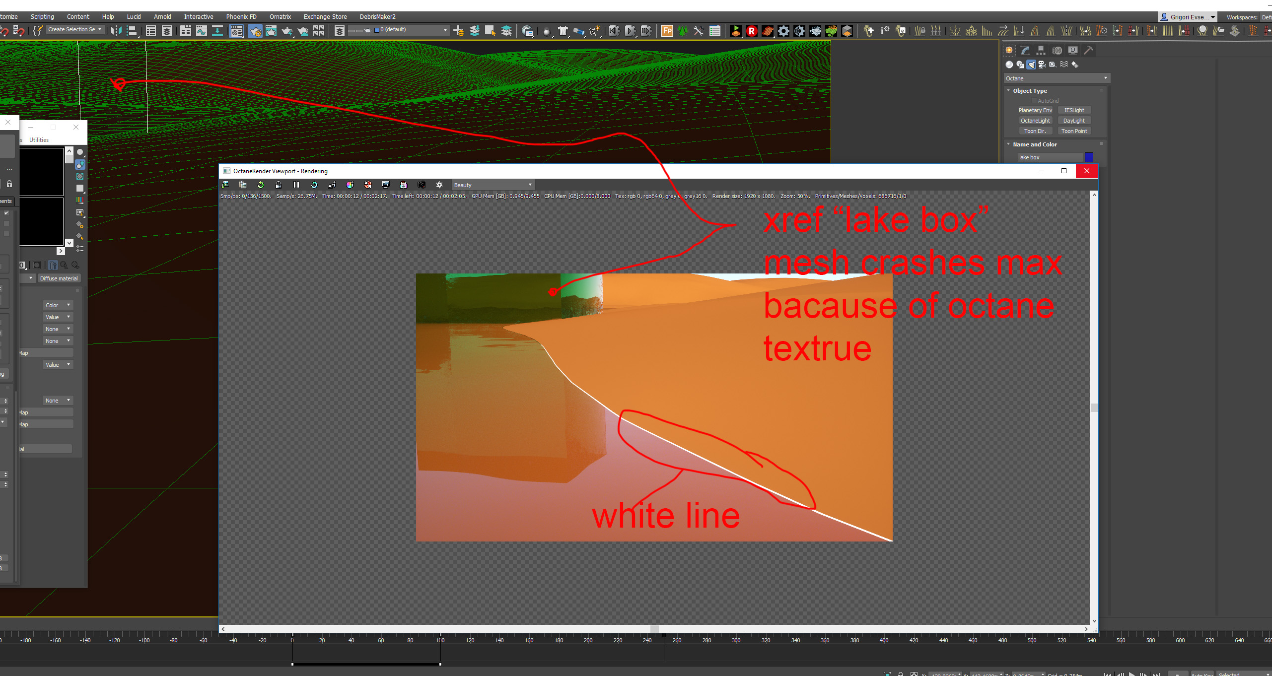

coilbook
Posts: 3176
Hi Paride
here is the scene.
There are 2 problems
1.You can clearly see white line where water and terrain touch each other.
2. If you xref object the cube in the scene called BOX LAKE max will crash because of octane texture. Not sure why.
xref crash white line bug.zip
(14.69 MiB) Downloaded 376 times
paride4331
Posts: 4001
coilbook wrote:Hi Paride
here is the scene.
Hi coilbook,
1 adjusting ray epslyon, but your scene is 38Km x 38Km and you are making a close-up camera render, you could work with two different scenes.
2 I suppose your Xref uses Octane 2.x material, so you should check 1.9 conversion system (Render Setup > tools) or check "disable XREF Material Converison" (Octane Global Preference > Prev. Versions).
Regards

coilbook
Posts: 3176
here is the scene.
Hi coilbook,
Regards
Paride
Thank you.
I hope otoy will get rid of this limitation with ray epsilon. I am not sure I've ever seen other renderers where you have to mess with ray epsilon and have two separate scenes for close up and a full scene view
