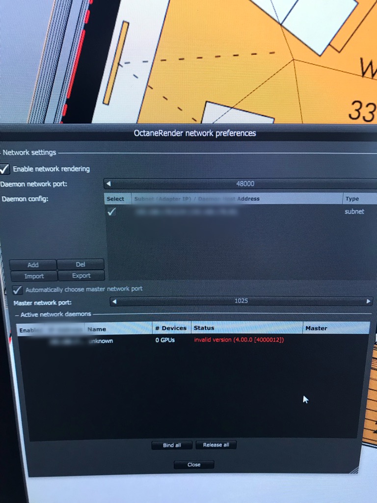

Plugin for Cinema 4D...invalid version

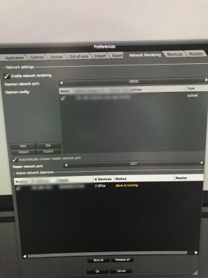

Standalone - slave is running, but why???
