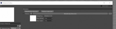

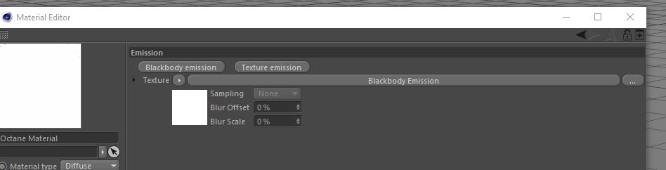

Hey Aoktar, can I possibly request a slight UI change with the emission channel?
A lot of the time when I mean to click on the texture input shader/button, I accidentally miss it and click the "blackbody emission" or "texture emission" buttons instead because they're so close.
This deletes the current shader and replaces it with a blank new one. Ctrl+Z doesn't work undo this, so the only option is rebuild the shader or close Cinema and go back to your last save.
Is it possible to to make this action undoable? Or just add some space between the texture shader button and the blackbody/texture emission buttons?

khdownes wrote:Hey Aoktar, can I possibly request a slight UI change with the emission channel?
I added UNDO for those. It will be available in V4-RC2-R1 build.

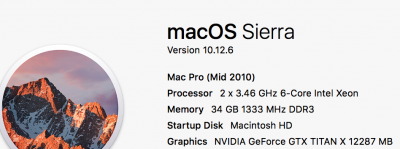

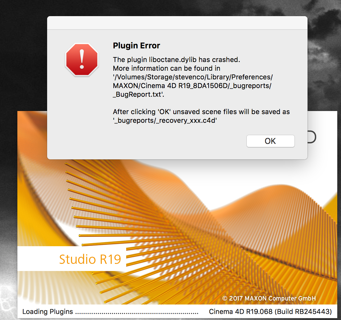

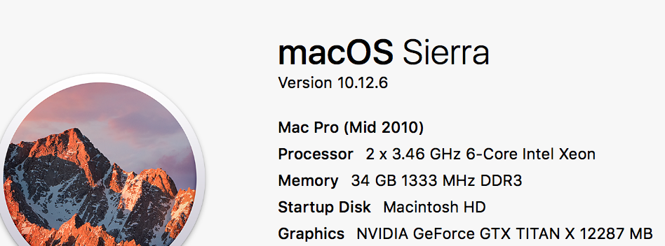

Still just crashing when trying to open C4D...
what would help sort that out? Nvidia and Cuda drivers are up to date.
Posts: 10587
Hi SRCOBB,
there is an issue in 4RC1 SDK with CPUs older than 2011, but has been already solved in 4RC2, so next version of plugin will not have this issue.
ciao Beppe
