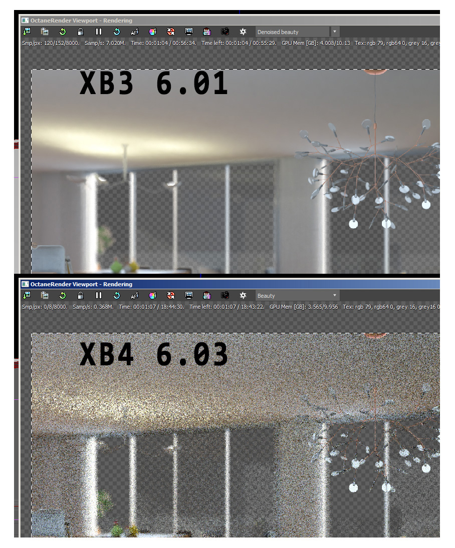

I have an another problem.
With XB3 6.01 I can render my scene very fast and I'm very happy.
With XB4 6.03 my render is very slow and I even can't go to denoising phase as it is too long.
( I test in XB3 6.03 and I have the same problem ) perhaps 6.03 is a wrong number ?
EDIT : after remerging all scene in a new fresh file, all is back and octane works as expected ( ???? )

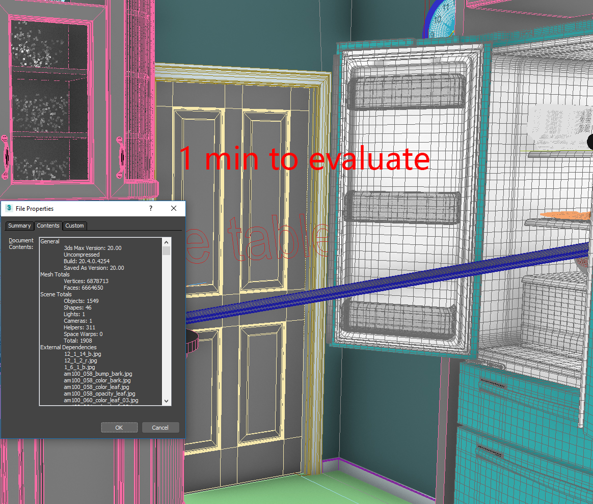

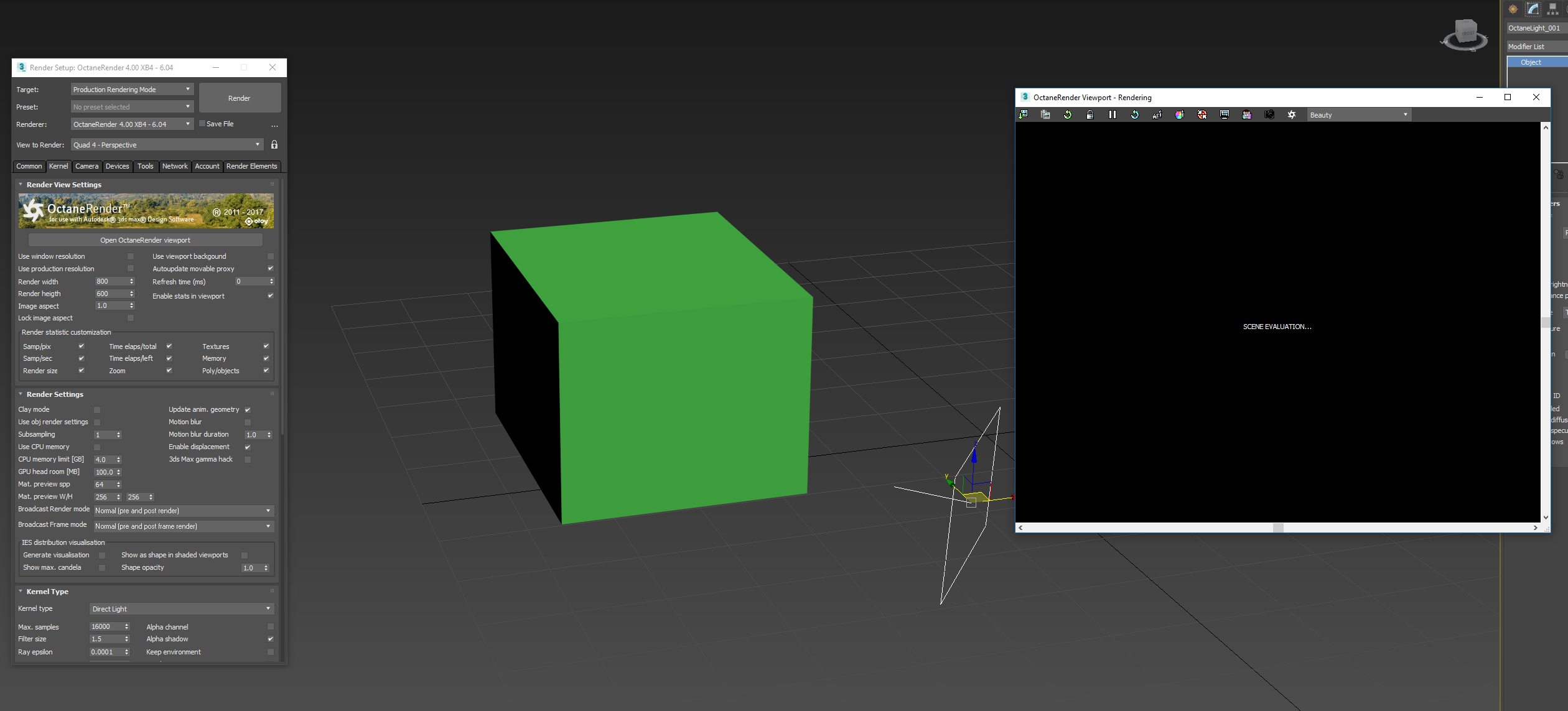

1. xb4 is not opening at all octane viewport
octane 3 scene opening 51 sec
xb3 scene opening is 24 seconds with Use obj render settings off
it has 15 mil polys with phoenix ocean mesh i really thought it would open quicker than 24 seconds. Could you guys add phoenix when you test your scene evaluations?
2. I also have another scene with 1549 objects in it and total just 6.4 million polys. Even with Use obj render settings off it takes 1 min for scene evaluation.

My octane viewport works using your file.coilbook wrote:why cannot i open even viewport with octane 4? is it a bug I just have one box and one light
Regards
Paride
Hi Paride, where is "save the denoised beauty instead of the main beauty pass" located?paride4331 wrote:My octane viewport works using your file.coilbook wrote:why cannot i open even viewport with octane 4? is it a bug I just have one box and one light
Regards
Paride
It seems that XB4 opens way slower than XB3 like 5 times slower

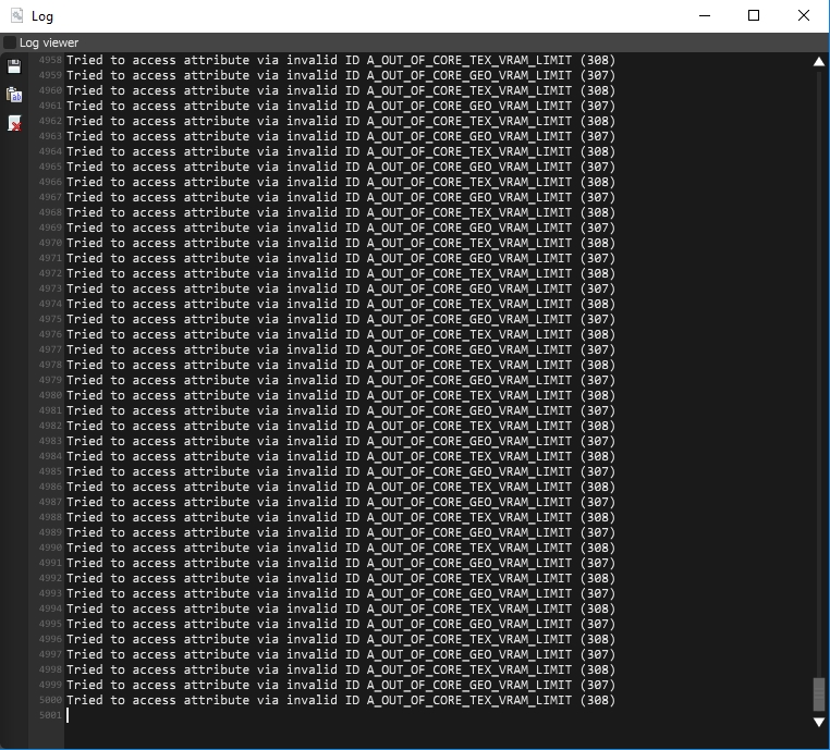

Facing the same issue. I opened an old scene which run on V3 fine and tried to render it with this release.clicky wrote:Trying to set some scene in V4, because in V3 its not possible because of the out of core limit.
Its a pretty large scene with about 25 UDIMs and displacements and such
After a while I ran into this error:
Render failure in Viewport Rendering: GPU Failure
this is from the log:
Tried to access attribute via invalid ID A_OUT_OF_CORE_TEX_VRAM_LIMIT
Tried to access attribute via invalid ID A_OUT_OF_CORE_GEO_VRAM_LIMIT
Seems like there still is some out of core limit, or not?
screenshot in attachment, anyone know what this may be?
In V4 I was prompted that system ran out of memory, so I tried to use Out of Core feature and received same GPU failure and octane log errors
Cause of that some of my textures are rendering completely black
Win 10 64 | RTX 3090 | i9 9980XE | 64GB RAM
