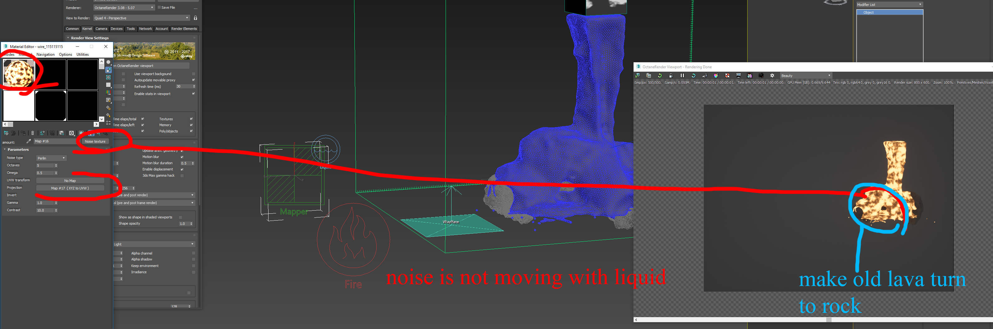

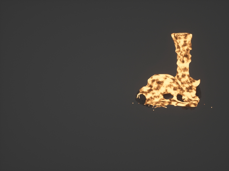

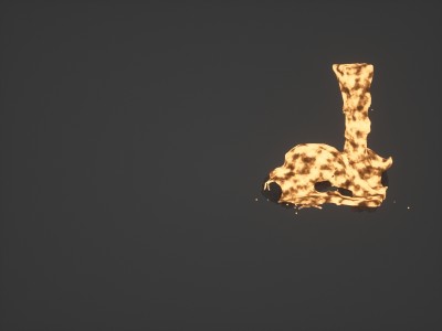

Hi Paride,
do you know by any chance how to change phoenix fd liquid texture overtime in octane. Phoenix now has variable viscosity and we need lava that solidifies to turn to stone and stop glowing like in this example https://youtu.be/91DnI9GDI5A?t=1m2s scene attached
2. And on more problem Can noise stick to the moving liquid. Seems like liquid moves but the noise is independent (similar t othe problem I had with breaking rocks as one mesh) I added projection but noise is not moving with liquid topology
Thank you!
Thank you!

Hi coilbook,
I did some tests, unfortunately in this case lava is made up of particles and object space does not solve this issue. I did some tests using phoenix with vray, but issue is like with Octane. I tried exporting simulation to .ABC as mesh or baking texture but no good result. I think, it needs something to get with velocity, age or viscosity ID info, but I'm not sure what I'm saying, I'll ask developers for a tip.
Regards
Paride
Regards
Paride
