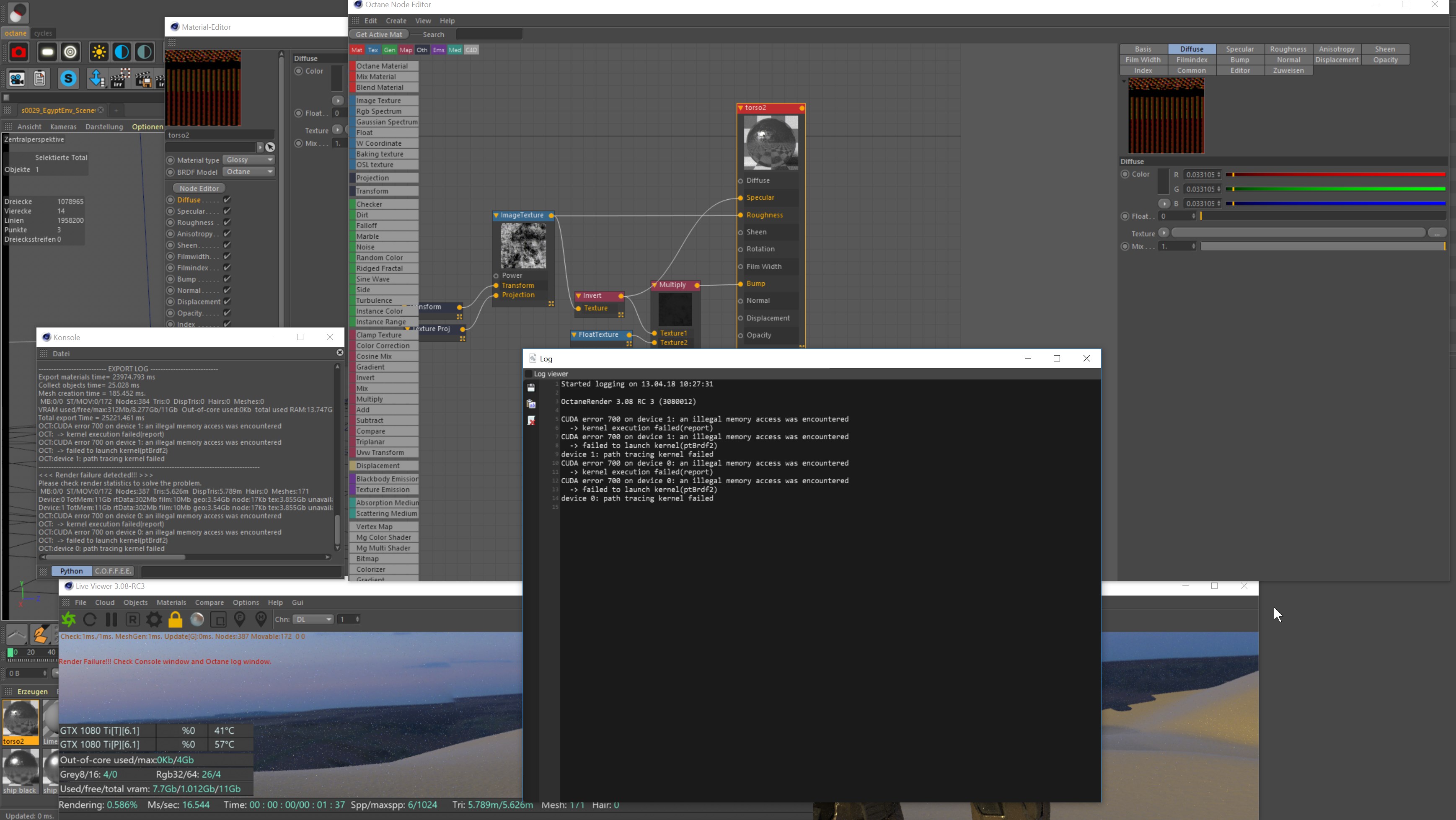

y81r
Posts: 65
Joined: Sat May 06, 2017 10:23 pm
I have many of these errors.
also the material preview is broken as soon as I work in the nodeeditor
Maybe the screenshot helps.
Nvidia 391.01
useruser
Posts: 142
Joined: Wed Jun 02, 2010 9:37 pm
i recognized a lot of errors ( cuda-errors) even with following combination:
octane 3.07 and Nvidia 391.35
so for testing purposes i switch back the display-driver to 388.59 which works pretty much "error-free" the last months.

Posts: 16068
Location: Türkiye
useruser wrote:i recognized a lot of errors ( cuda-errors) even with following combination:
I believe that latest drivers are big headache me too. I've tried a lot of clean reinstall. I had got many crashes frequently even without C4D open. Finally i made a clean install in safe mode with 391.24 and now i feel it's better.
