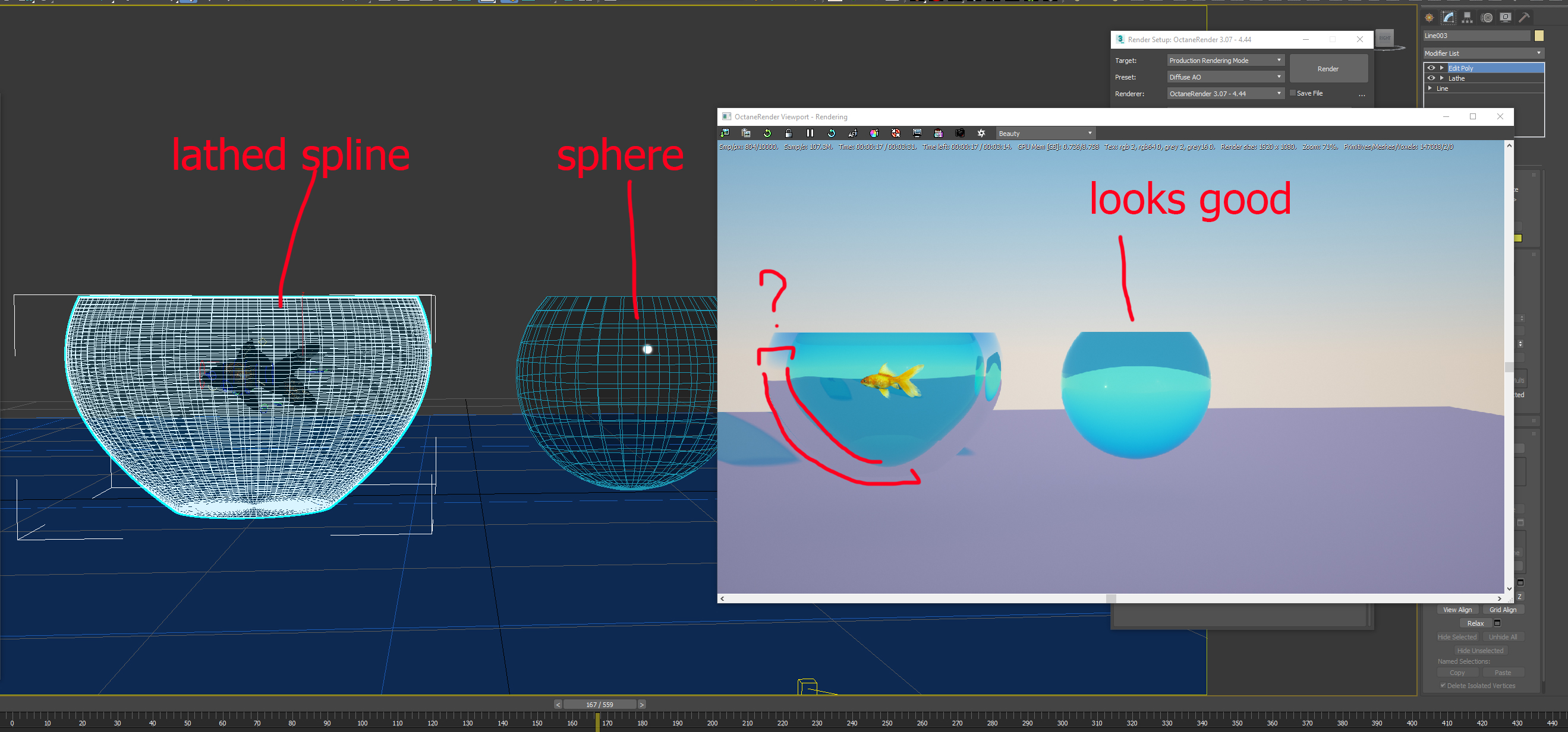

why does lathed mesh from splines has different look than a similar sphere. Lathed mesh is closed and all vertices are welded. Thanks

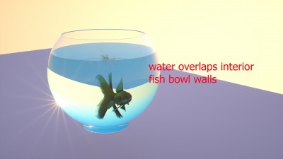

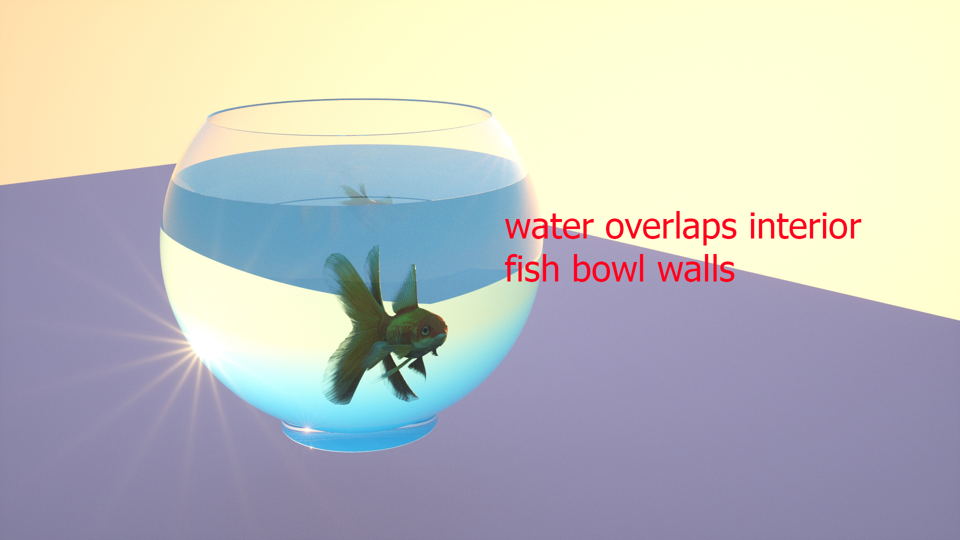

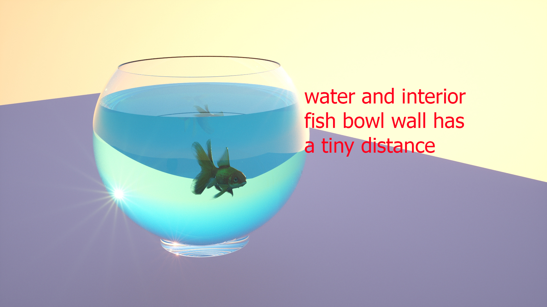

also i red that water must overlap glass a bit but this makes fish very distorted. When water does not touch water tank walls fish look better What is a proper way for water and glass container ? Thanks

Thanks. Also could you please take a loot at fish bowl bug file attached above. OCtane does not like objects made as lathe. Thanks
Hi coilbook,
you flipped the normals.
3dsMax command panel > modify > normal
Regards
Paride
coilbook
Posts: 3176
paride4331 wrote:
Hi coilbook,
Regards
Paride
wow thanks

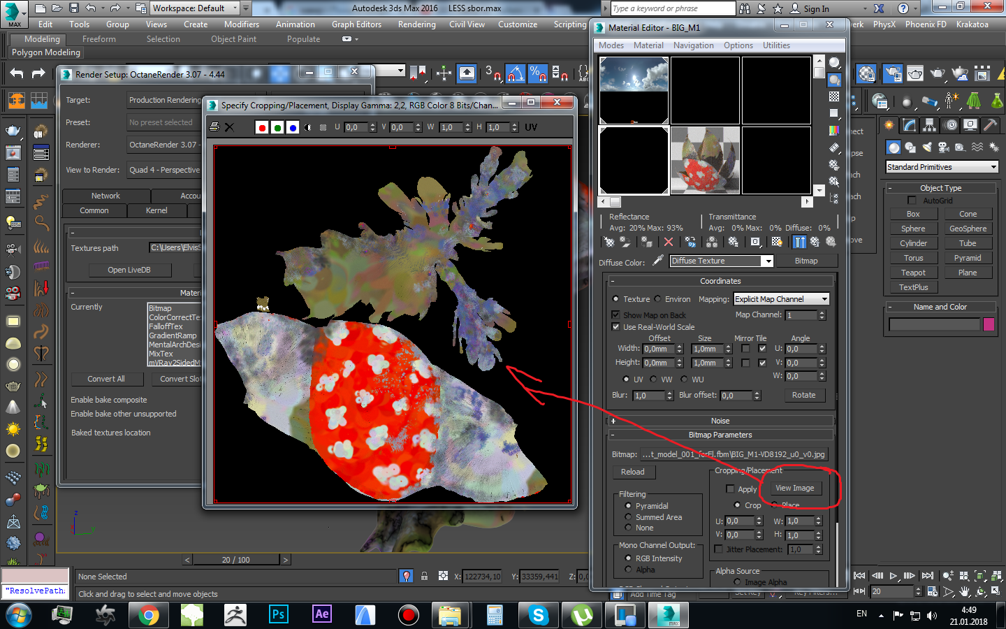

add View Image
