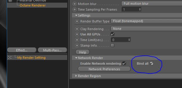

It's a new feature aoktar added when I noticed the slave render stations weren't being activated when using commandline rendering. (Picture viewer never worked for me with the remote stations so now I build in LV and then render at the desktop. )
Don't know if it will help you, but I've attached a picture to show you where the checkbox is to activate it. It did fix my problem.

Oh, thanks. I really missed this checkboxBCres wrote:It's a new feature aoktar added when I noticed the slave render stations weren't being activated when using commandline rendering. (Picture viewer never worked for me with the remote stations so now I build in LV and then render at the desktop. )
