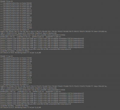

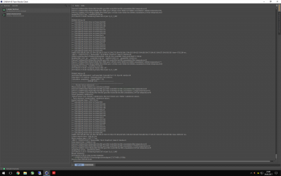

The only issue we get is that we get "render failure detected" errors (see attached screenshot) in Team Render every few hours on our machines.
Whenever this error occurs all card are reported to have 0 MB of available memory.
It does not seem to be related of what content we render - after a reboot the same image renders just fine.
We can not reproduce this error - we can just observe it many times over a day and then reboot
This occurs on all of our machines - three of them equipped with 7 Titan X (Pascal) card and five more equipped with 1-3 1080 Graphic and 1-2 Titan X (Pascal) cards.
Some of the Systems are water cooled others are air cooled. All of the air cooled ones use the NVidia reference design for air cooling.
We use on all machines Windows 10 and the latest Nvidia driver.
Please advise what we could do to give you better hints what this is all about.

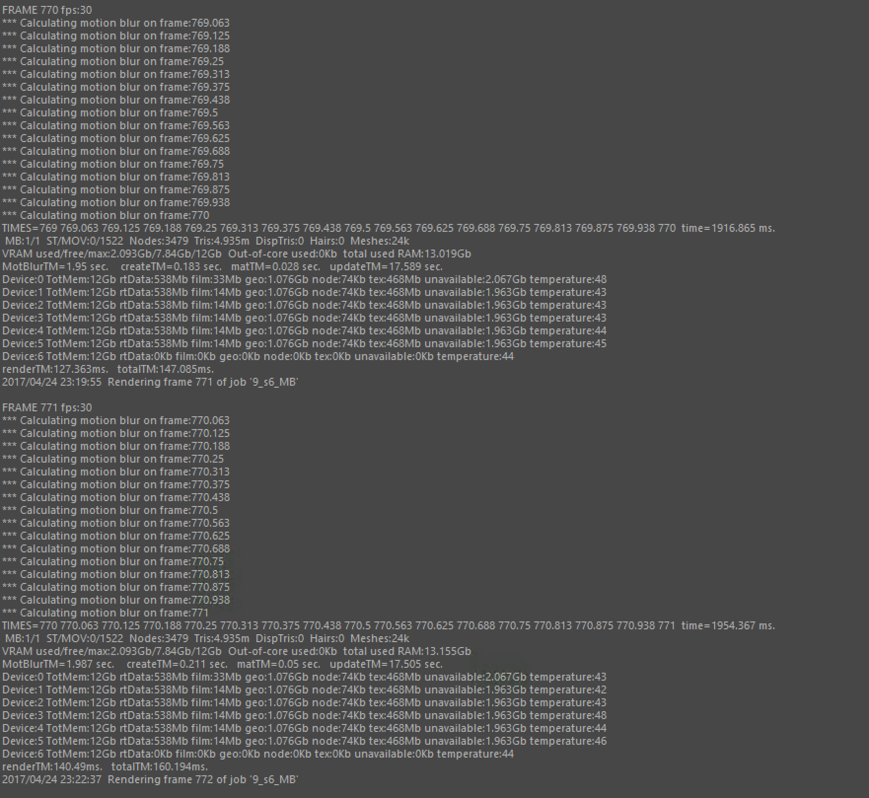

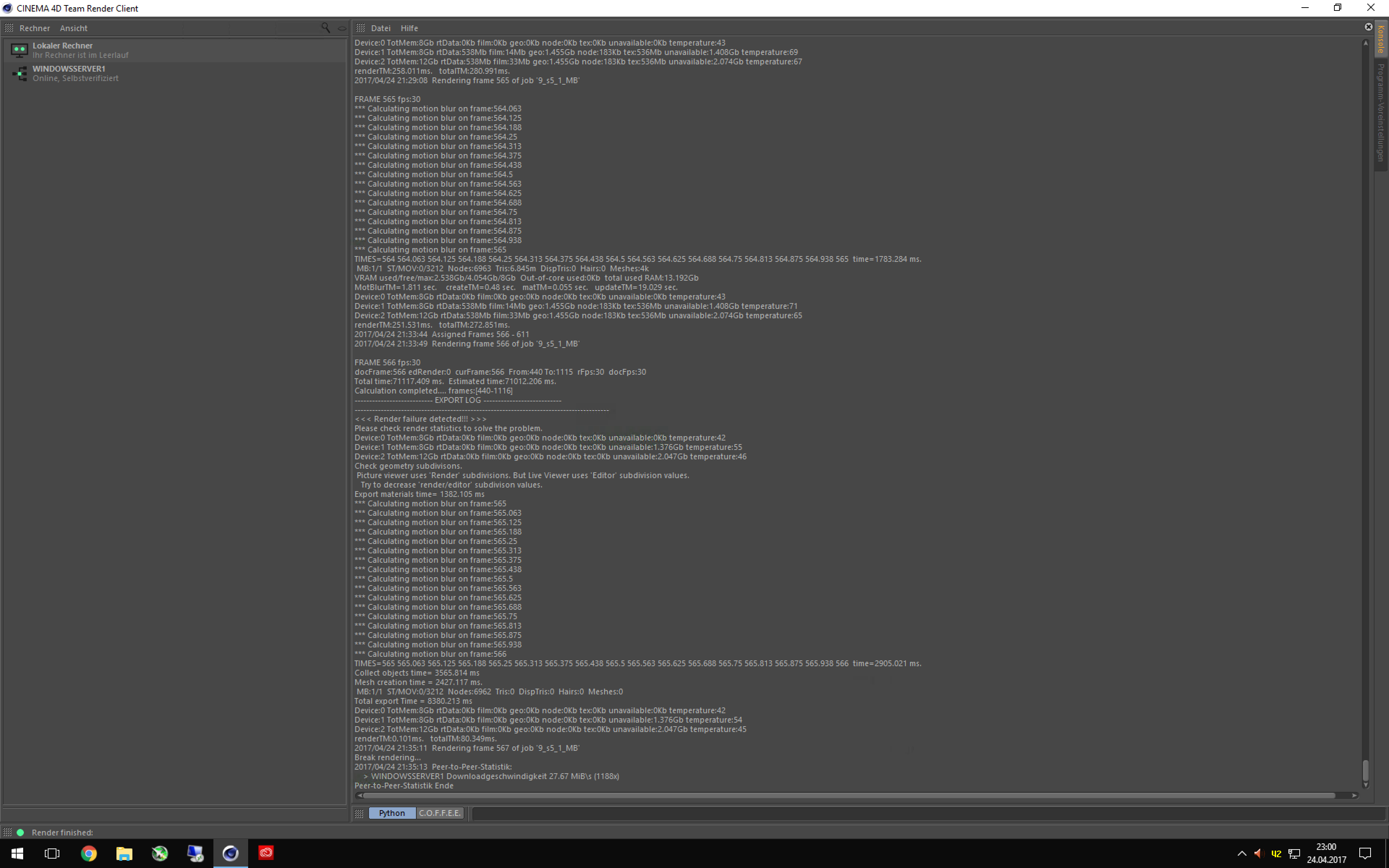

Attached another example from a water cooled machine with 7 Titan X (Pascal) Cards that are rendering some heavy animation.
In this case only the last card reports 0 MB of memory. The machine continues to render on just fine with 6 remaining cards. And after a system reboot all seven cards are up and running again. Sometimes it tehn runs fine for only 15 Minutes and sometimes it runs just fine for 8 hours in one go before any next failure.
Again, it does not seem to matter what we render - some thing easy that renders a few seconds / frame or something super heavy needs several minutes per frame.
In other cases all seven card will report 0 MB and the we get the render failure message.
