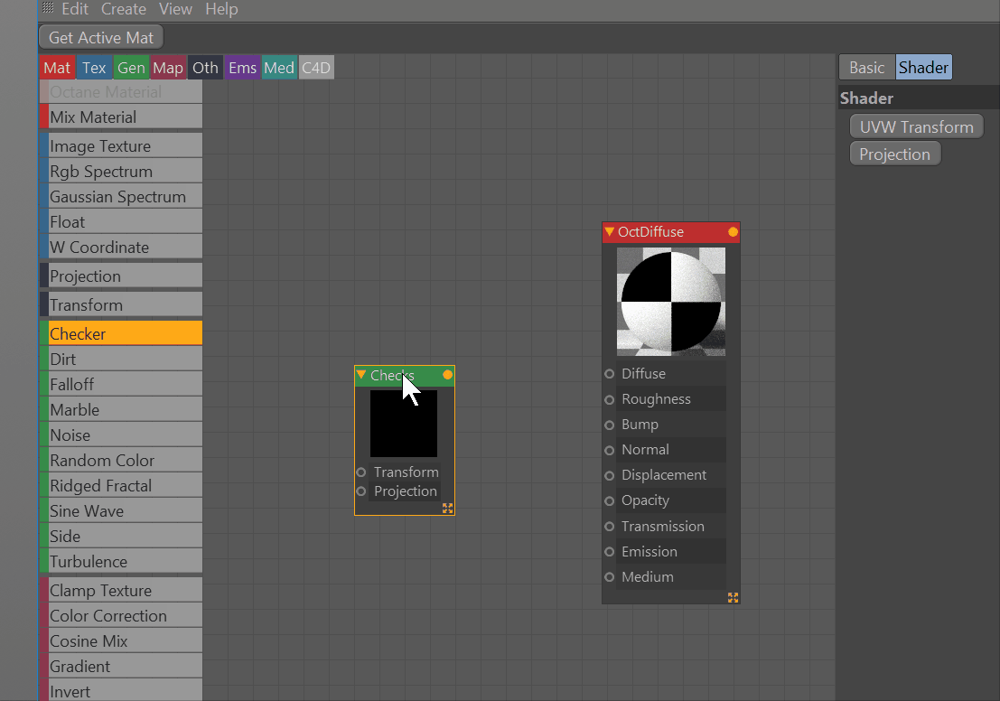

- please add UNDO to the "Octane Settings". For example to the "White Point" Color Picker
- I also notice a "lack" (waiting time), when I add a ImageTexture Node to a Material, until I can choose a Bitmap, or work on. (since 3.05.3)

moebius wrote:- please add UNDO to the "Octane Settings". For example to the "White Point" Color Picker
1-It's not possible right now.
2-What do you mean? It should be at same speed for first time and faster for next.
Posts: 16068
Location: Türkiye
eyeonestudio wrote:Alt Gesture - Insert Still Buggy... :(
Ok thx! It's fine on me.
moebius
Posts: 95
Joined: Tue Mar 17, 2015 2:18 pm
aoktar wrote: 2-What do you mean? It should be at same speed for first time and faster for next.
Hi aoktar
first time it takes almost 3 minutes and C4D freezes for that time. BUT: I figured out, it takes so long time when I do it in the Material AttributeManager. It's much faster in Node Editor!
Posts: 16068
Location: Türkiye
Hi aoktar
Like a joke! What are you using to freeze that soo long? Nothing should be longer than milliseconds

moebius
Posts: 95
aoktar wrote: Like a joke! What are you using to freeze that soo long? Nothing should be longer than milliseconds
I found the reason: I had in the C4D preverences all Harddrives. Ctrl+E > Files > Texturepath
thanks aoktar :-)
