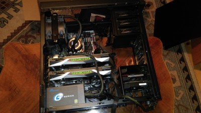

Hi guys,
Just stuffed a 1080 Ti founder next to a Maxwell Titan Z and I am comparising them.
The first test was with the Octane Benchmark Trench 3.05.3.
I Have rendered the scene to 4000 maxsamples and the and the Ti just beats the Titan Z with 43 versus 44 seconds
Later I will post my findings for perfromance difference in my own projects as a workflow comparising,
because for me that is all that counts in practical way.

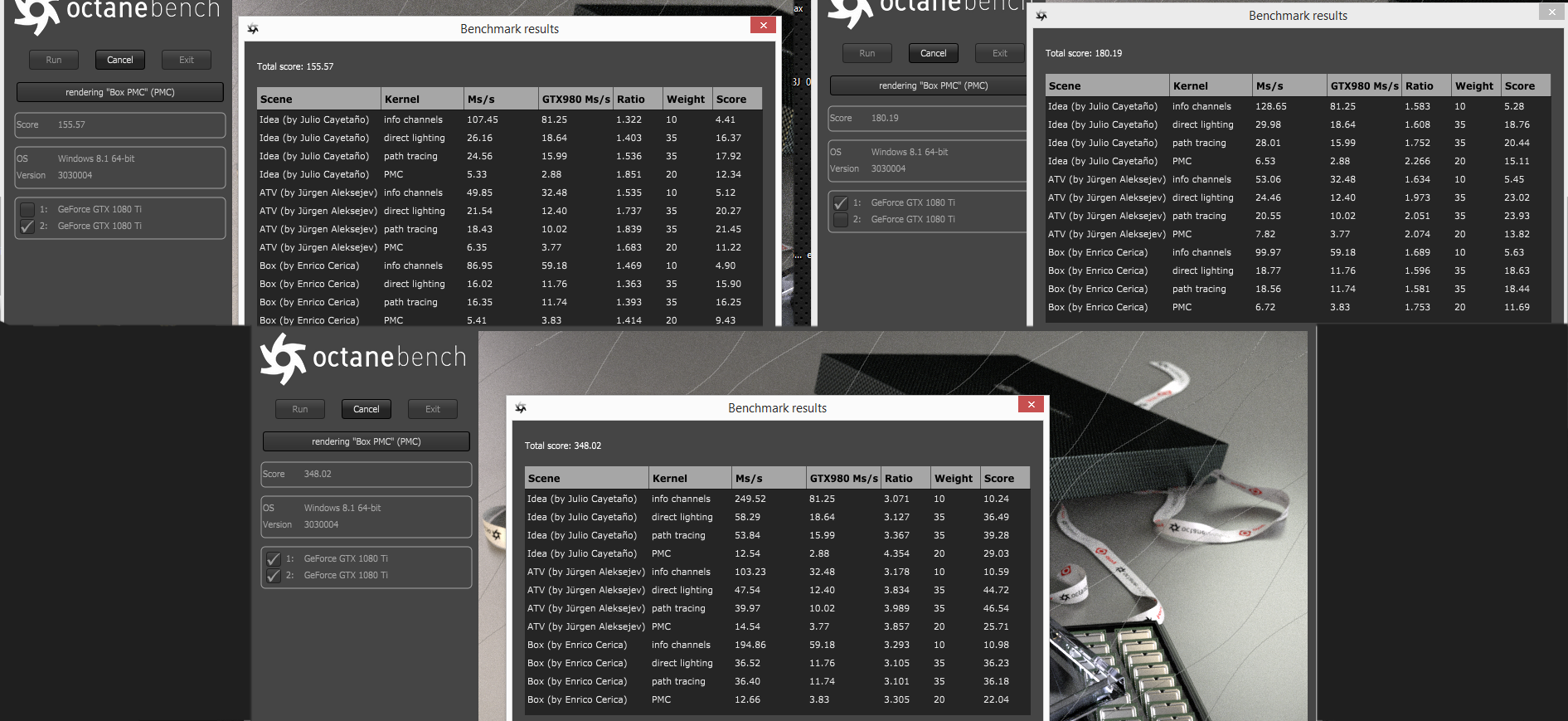

strange thing, v3 behaves a bit different & thus when I'm running with pair of cards I always get lower than separately.

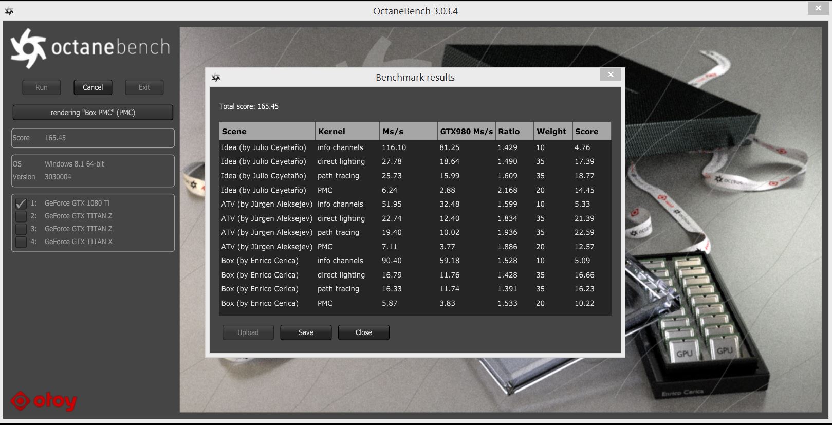

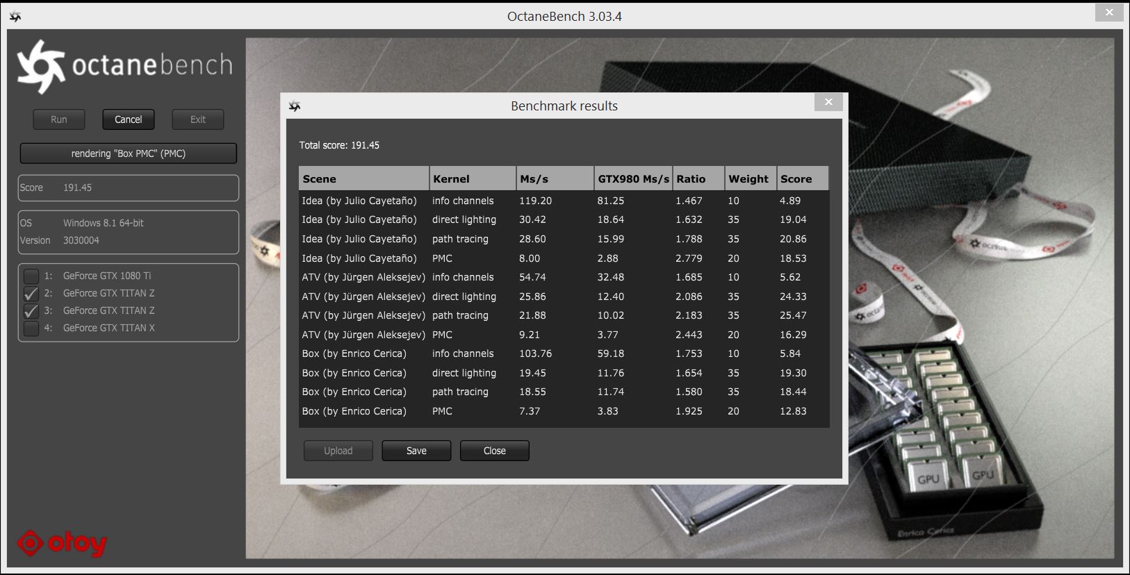

Hi glimpse,glimpse wrote:Yeah, 2.17 does not support Pascal based cards, but You can run this one:rappet wrote: The OctaneBench is 2.17 and does not support Pascal, right?
or do you mean another OctanBench...? I have read about an unofficial or 'cracked' OctaneBench somewhere around this forum.
viewtopic.php?f=9&t=56108&p=289082&hilit=1080#p287699
would be very thankful if You could Run TitanZ; 1080TI & then both =)
TitanZ: 191.45 / 1080Ti: 165.45
1080 Ti ran at 1822 mhz, no overclock, 74 Celsius.
The precious TitanZ is still king with +15%
cheers,

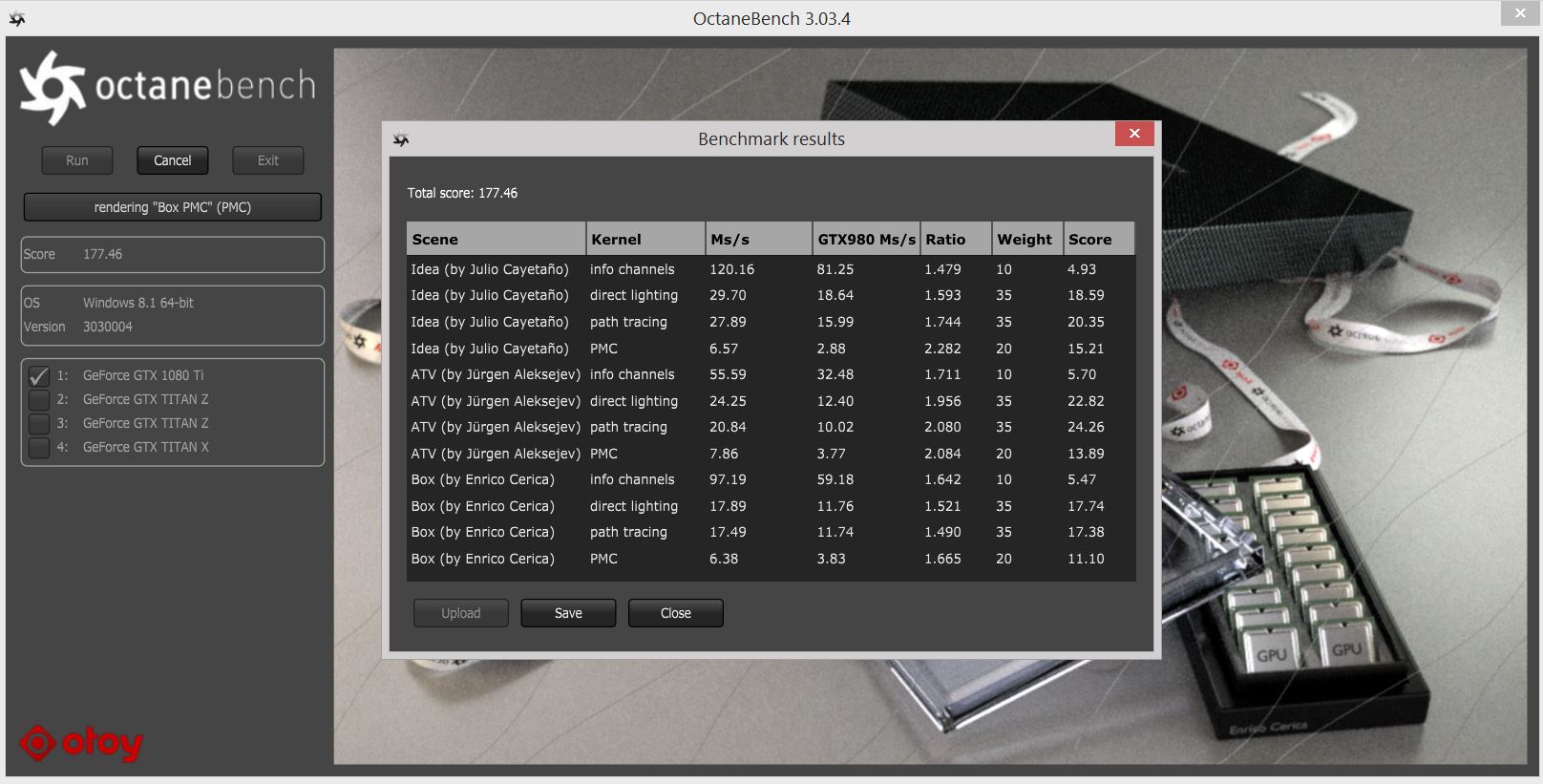

Hey T,
I did the overclocking +200 GPU Clock and +500 MEM Clock on the 1080 TI.
that gave 7% more performance: from default 165 to 177 on the Benchmark.
the fan was on auto, and the temp was max 75 celsius

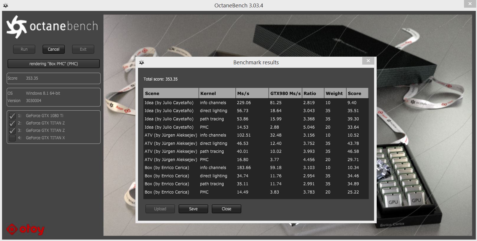

And I also did the Titan Z and 1080Ti (default) together; result is 353
Compare adding numbers was 191+165= 356, so that is about the same.

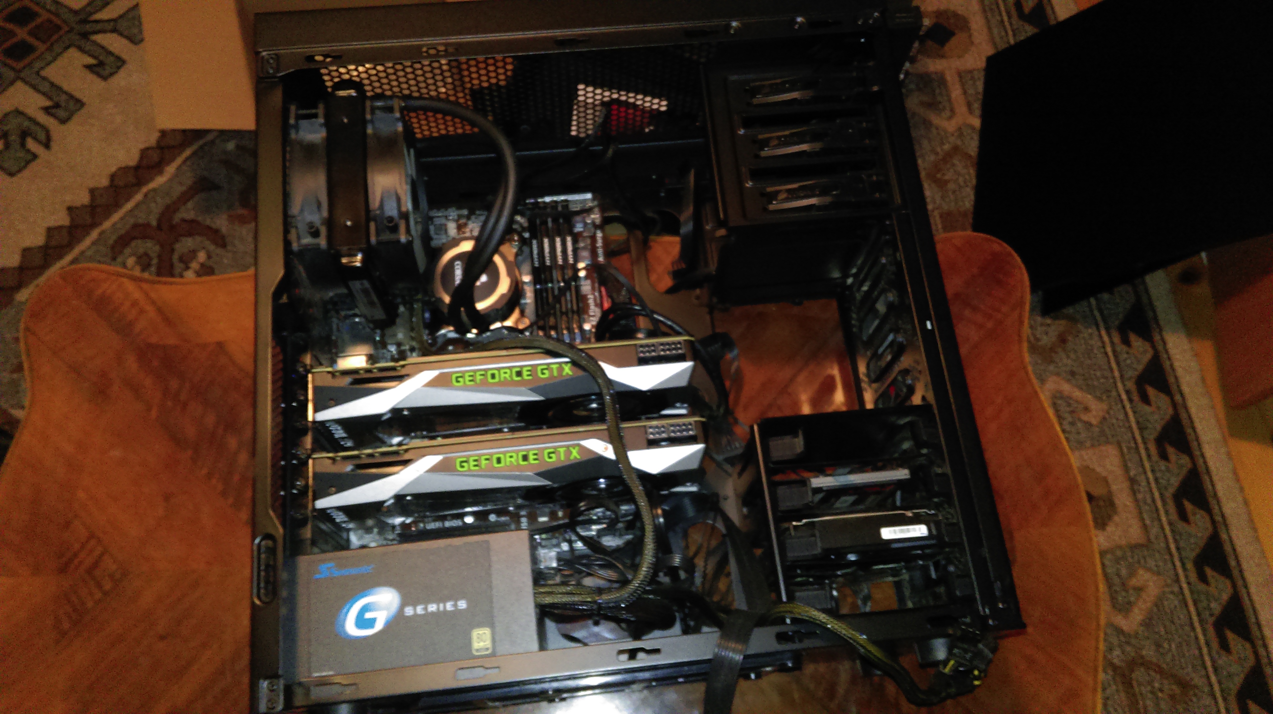

The temp on the 1080TI now also was >80 celsius,
fanspeed of the 1080Ti was about 2000 rpm.
Gpu clock was 2012 mhz

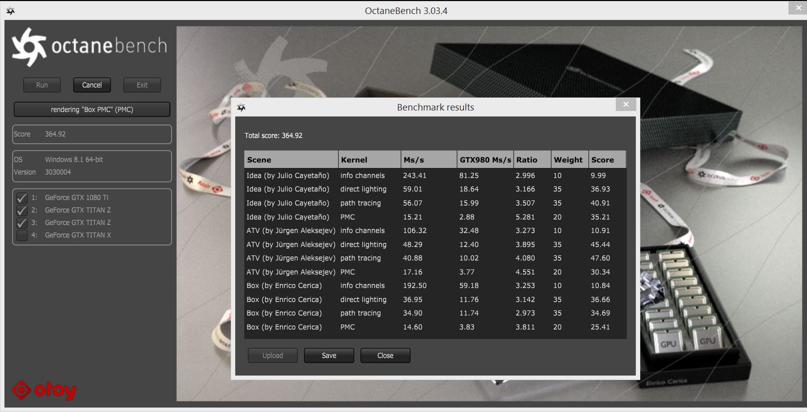

Then I also did the Titan Z and 1080Ti overclocked together; result is 365
Compare adding numbers was 191+177= 368, so that is about the same.
The temp on the 1080TI now also was >82 celsius,
fanspeed of the 1080Ti was >2350 rpm.
Gpu clock was jumping between 1900-2000 mhz
the Titan Z is below the 1080Ti, so the heat spread form the Z surely influences behaviour of 1080Ti.

I did overclocking on the 1080 Ti seperately on Mem and GPU and it looks they rare not related in performance increasing:
+200 GPU Clock: 175 (+7)
+500 MEM Clock: 172 (+5)
(together they ad up from default 165 to 177)
