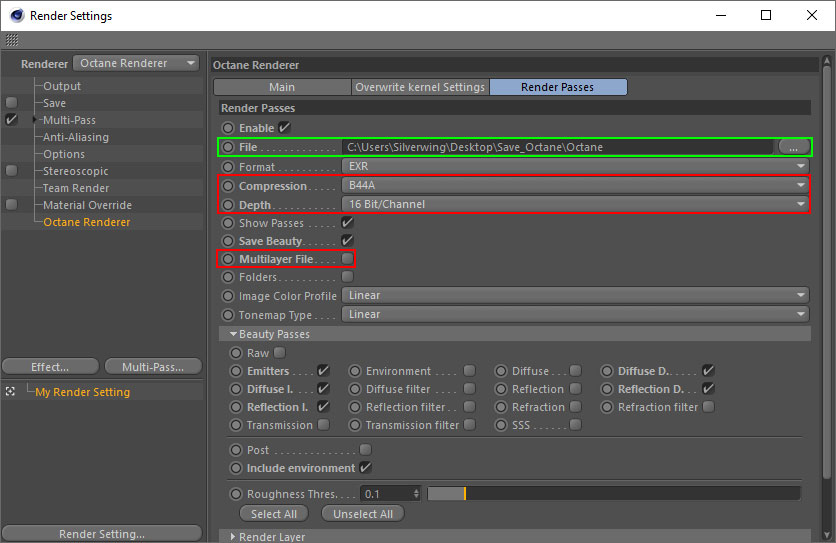

Hi there,
I am here to report some bugs today:
01: Octane ignores the compression parameter in the output if you save the pictures to seperate files
Works when saved to a single multi layer file though.

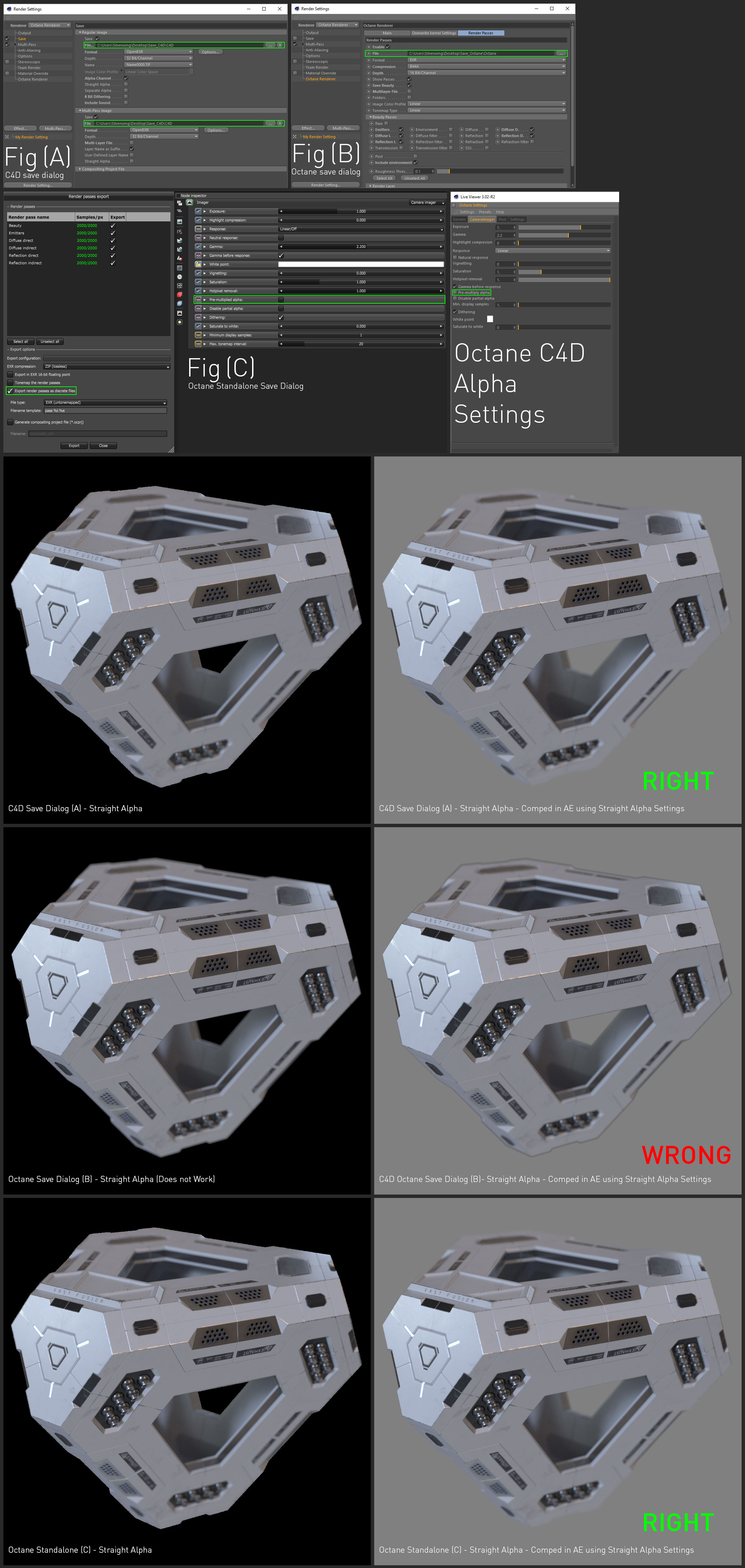

03: Octane does not recognize the unticked "Premultiply Alpha" when Saving thrugh the Octane Multipass Save Dialog (Fig B)
Notice the black line in the comp. Someone made me aware of this with this topic: viewtopic.php?f=30&t=55005
The more multi-pass beauty passes (as Reflection Direct, Reflection Inderect etc) you layer over each other with "Premultiplied Alpha" the more visible the error gets in form of a black line around the object.
Might also be working with single multilayer file but I do not have the software to test it.
