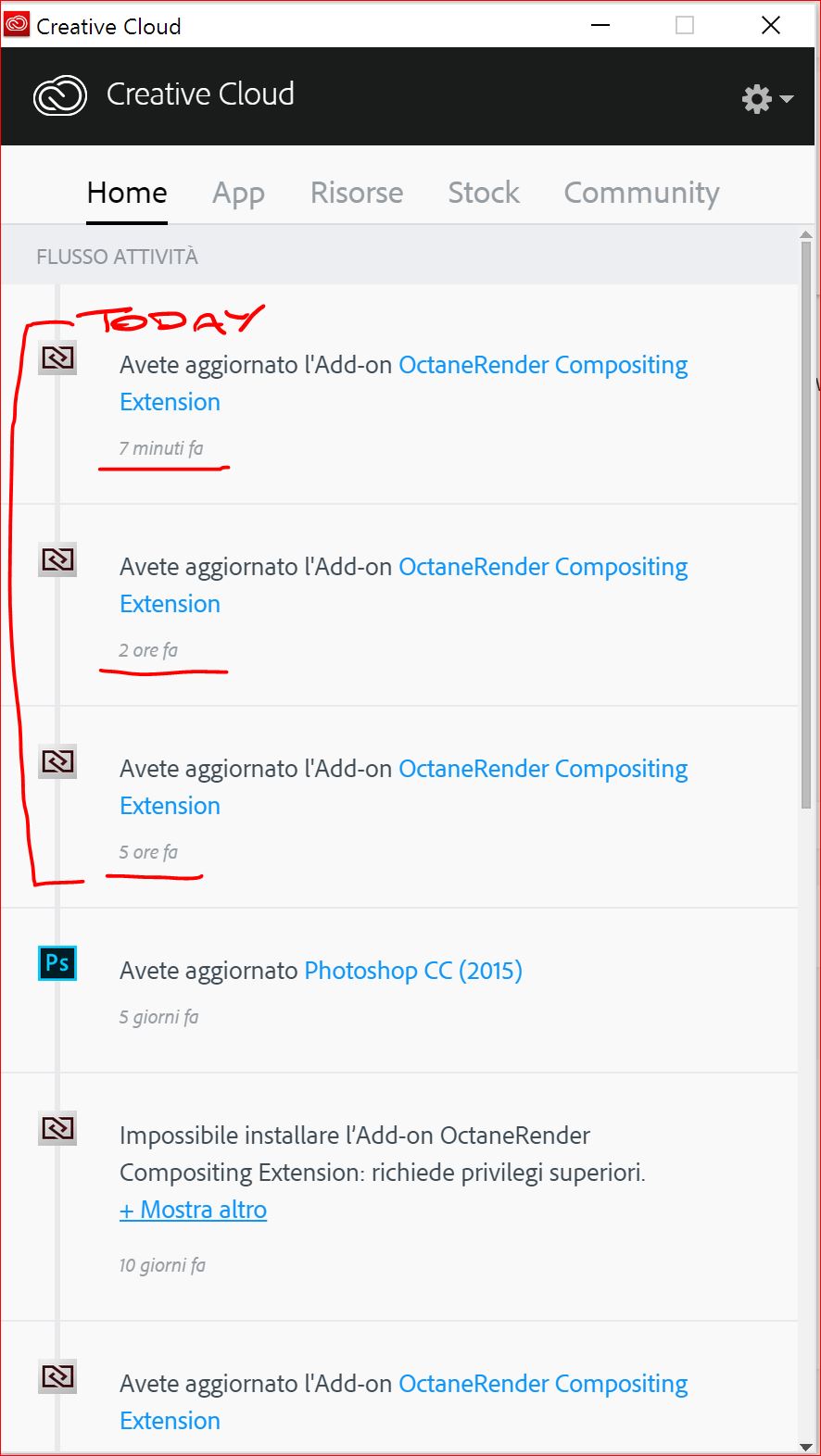

augdalmo wrote:Hi Abstrax,
I have installed some weeks ago the Photoshop plugin OR Compositing. Every few days Creative Cluod warns me of a new version to install, but on the last two days I was solicited many times in a day even if I confirm the installation and it was successfully installed.
Do you have released so much updates on so few days and lately on few hours?
Manu
Hi Abstrax,
no answer for my question? today I have received three upgrade of plugin from Creative cloud, all successfully installed, why so frequent update on few hours?
Manu
Posts: 10641
hi augdalmo,
there is already an answer for you from mojave in the secon page of this thread:
viewtopic.php?f=33&t=52332&start=10#p262811
ciao beppe

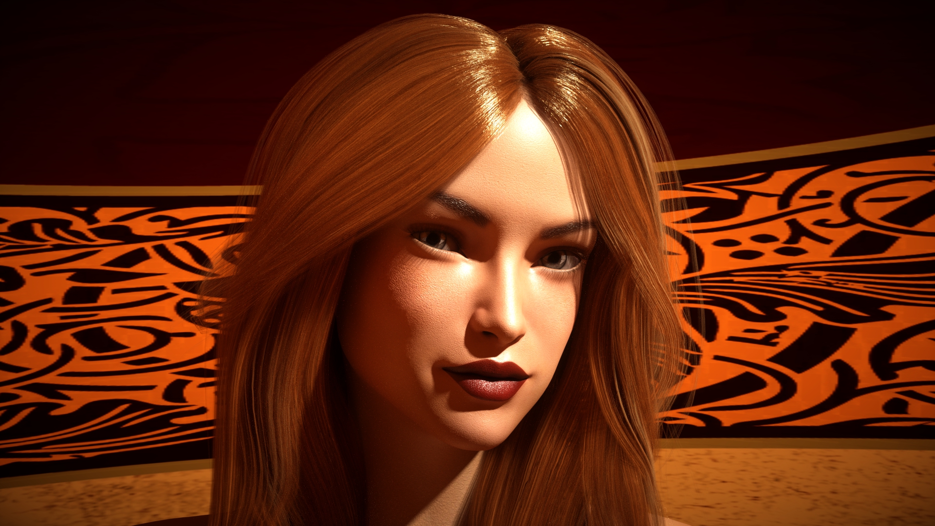

Marcus, just want to report on subject of PCI 1x / Baking Cam, I was running a render on Daz Studio plugin with a very high 'something' (I think displacement?), as there was a higher than normal hair definition of some sort that makes the render run much slower, and this presented the same freezing at higher resolutions. I could get through at low, but after 720p I was getting crashes. Also, when I ran, as alternate, only with my primary GPU Titan X (16x from motherboard), I was not getting any crashes. It was too similar to the baking cam experience, so I figure I'd bring it up. It may not be 'baking camera' per-say that is an issue, it may be a greater issue involving GPUs at PCI speed 1x with higher resolutions, kind of like the lag thing.
And here is the obligatory note, I am sure you guessed it already...it did not occur when rendered through the Version 2.x of plugin.
Here is image with hair texture that made V3 stop in its tracks with multi GPU at PCI 1x:
Playing hard to get with V3
Thx

Notiusweb wrote:Marcus, just want to report on subject of PCI 1x / Baking Cam, I was running a render on Daz Studio plugin with a very high 'something' (I think displacement?), as there was a higher than normal hair definition of some sort that makes the render run much slower, and this presented the same freezing at higher resolutions. I could get through at low, but after 720p I was getting crashes. Also, when I ran, as alternate, only with my primary GPU Titan X (16x from motherboard), I was not getting any crashes. It was too similar to the baking cam experience, so I figure I'd bring it up. It may not be 'baking camera' per-say that is an issue, it may be a greater issue involving GPUs at PCI speed 1x with higher resolutions, kind of like the lag thing.
Thx
Unfortunately, I didn't have time to look into the issue further yet. It would be a big help, if you could send me an example scene (preferably exported as .orbx package) that causes these issues on your hardware. I will then try to set up my system to run through a 1x PCIe bus when I have got time.
