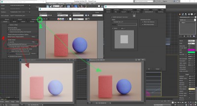

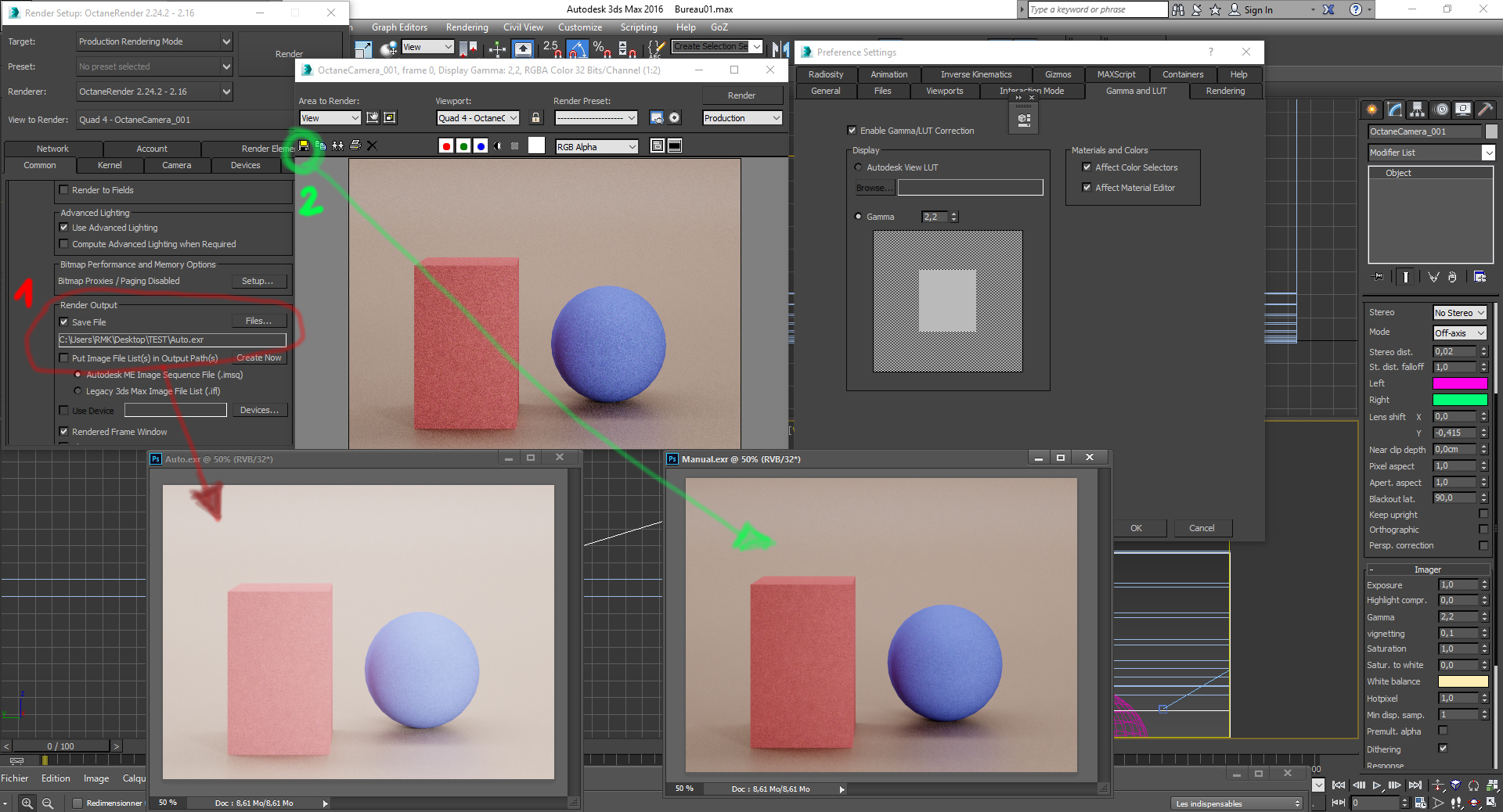

I also have trouble with the gamma of .EXR files.
When I save from the Render Output (1), with gamma set to "automatic (recommended)", my file will have gamma 2,2 applied twice.
When I save manualy from the MAX Buffer (2), with gamma set to "automatic (recommended)" , my file has the correct gamma.
That may be a 3DS Max issue, it's very frustrating while saving multiple render passes :)

I will check it, thank you for report. Looks like 3ds Max bug, 'cause in both cases 3ds Max saves the same its own internal image buffer holding the same data loaded by Octane plugin after rendering the image. Looks like in this case 3ds Max does not respect the gamma set in internal buffer info and assumes the buffer is always in 1.0 gamma. So I think the simple workaround here - just have 1.0 gamma in Octane imager if you save HDR image.

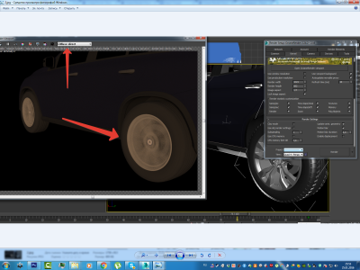

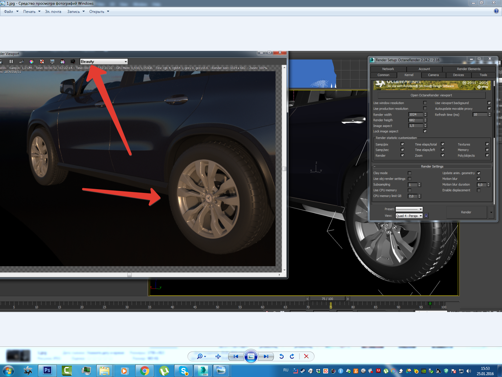

when use tone mapping stops working alpha channel ( enable gamma/lut correction - ON (2.2))
Elvissuperstar007
Posts: 2603
Location: Ukraine
bug MB
direct working
beauty does not work
