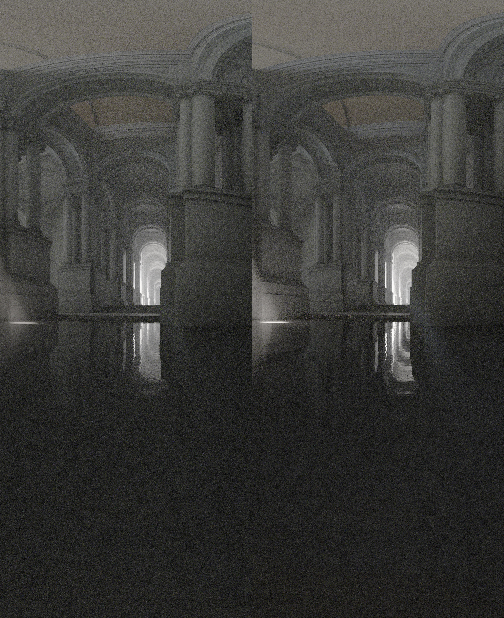

Check out the difference between left and right eye in the reflection.

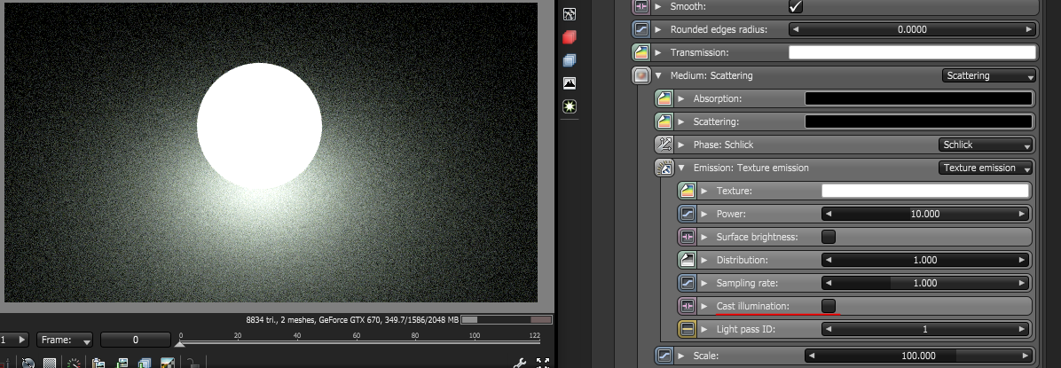

I'm just testing SSS and plugged an emission texture into it with "cast illumination" disabled. It's still casting light on the object around it though.
I tried this in octane 2 and see the same issue. I assume this is a bug?
