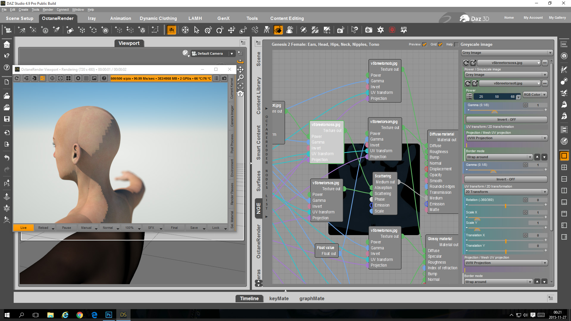

Steps to replicate this issue:
- Close DAZ Studio and restart it
- Add Genesis 2 Female to the scene
- start the OcDS viewport
- use the "Edit OctaneRender materials in the NGE" tool and click on the torso surface of G2F
- click on any of the torso map nodes attached to the scattering node
- hit the Delete Key on the keyboard
Result:
G2F gets deleted from the scene

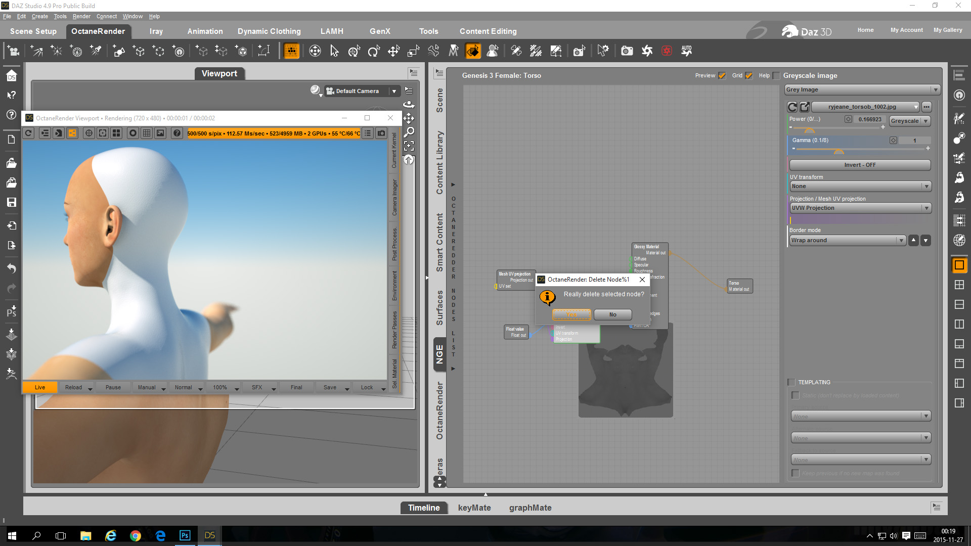

Other workflows tested:
- I was able to replicate this error with G3F and using the Delete key on a random node.
- This error is not triggered if the user right clicks on the map node and selects "delete".
Then the delete confirmation dialogue is triggered.
- After the confirmation dialogue was triggered manually pressing the Delete key on the keyboard will also trigger the confirmation dialogue.
