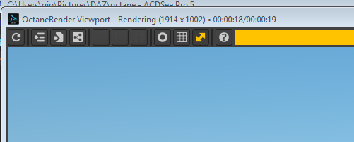

hello
maybe this was posted before but I get a random grey out on the focus buttens .
some times be deleting the cameras and when it jumps to a perspective camera.
I recreate a new camera and the buttens reappear.
but not always so its random , hit and miss

linvanchene wrote: If you delete a camera in the DS scene tab the DAZ Studio and the OcDS view may jump to "Perspective View" causing camera controls to be greyed out. Make sure to create a new default camera and also selecting it again in the OcDS viewport camera selection.
ah, nice tip, noted !

additional note: studio without ocds would let you operate even a deleted camera (as long you don't select another one), but obviously there is no more scene node and thus camera controls (apart from viewport navigation).
the plugin on the other hand can't synchronize settings with a camera that was actually deleted (even if it still seems to exist in some nirvana); and even if it could, the effect would be the same - the additional camera controls would no longer be available.
to avoid this (and other problems because of this behavior), the plugin forcibly switches to the next best camera if the current camera is deleted: any other standard/user camera, or, if there is none, the default perspective view is selected.
and as lin already wrote: the default perspective view as well as the other default cameras (top/bottom/...) don't support any other controls but basic navigation, so also ocds has no support for additional settings.
probably the best way - workflow-wise - is to let studio create a default camera (can be selected in studio preferences) - and to use the perspective view as "investigation" tool, i.e. to quickly control poses/morphs/etc. from another/closer/... perspective.
last one: the perspective camera also has dof completely turned off in octane, means you get a sharp view all over its viewing distance...
