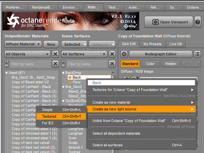

hmmmmm.... You should be able to see it. It's still there. But if you use it, it will result in a crash. So for the time being using it through the NGE is the only way to add an emitter. Attaching a screenshot of the version of the plugin with the options. It does behave a bit differently. You basically need to set everything up manually.

Oh thanks. It in the right-click menue
I always used in old plugin version the "selected" button. And there it is missing.
Possible that it behave different because is set it up manually different. Never done it before that way

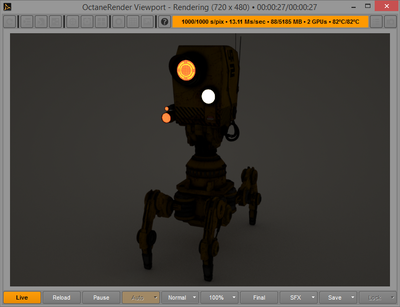

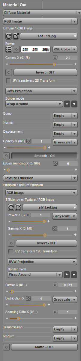

Hubby72, you can try the following. Add a 'Texture Emission' in the NGE. Then change the 'Emission / Texture Emission' to the same texture that is in the Diffuse settings. After that just adjust the power in the 'Emission / Texture Emission' to have enough light while still showing the texture details.
An example : Settings used : In the above image, the texture stills shows while it also glows. If you increase the power too much you will loose the texture details though it will light up the surrounding more.
You can play around with the settings until you achieve the effect you are looking for. Also in the 'Emission / Texture Emission' settings you can change the 'Greyscale Color' for the texture to 'RGB Color' to add a color accent.

Basically for the Emission, I don't think the diffuse settings matter that much. It is what you put inside the 'Emission / Texture Emission' node that matters.

Do not worry about how bright or dark the environment is when adjusting how the light emitting texture looks.rajib wrote:
- Just adjust the power setting of the light emitter so that the light emitting texture looks about right to you.
The complete scene will now probably be too dark. Thats ok.
- Go to Render Settings / Camera Imager and adjust either the Exposure or F-stop values to raise or lower the overall brightness of the complete scene to the right amount you want.
You could also use the ISO setting but that may also simulate some unwanted noise.
