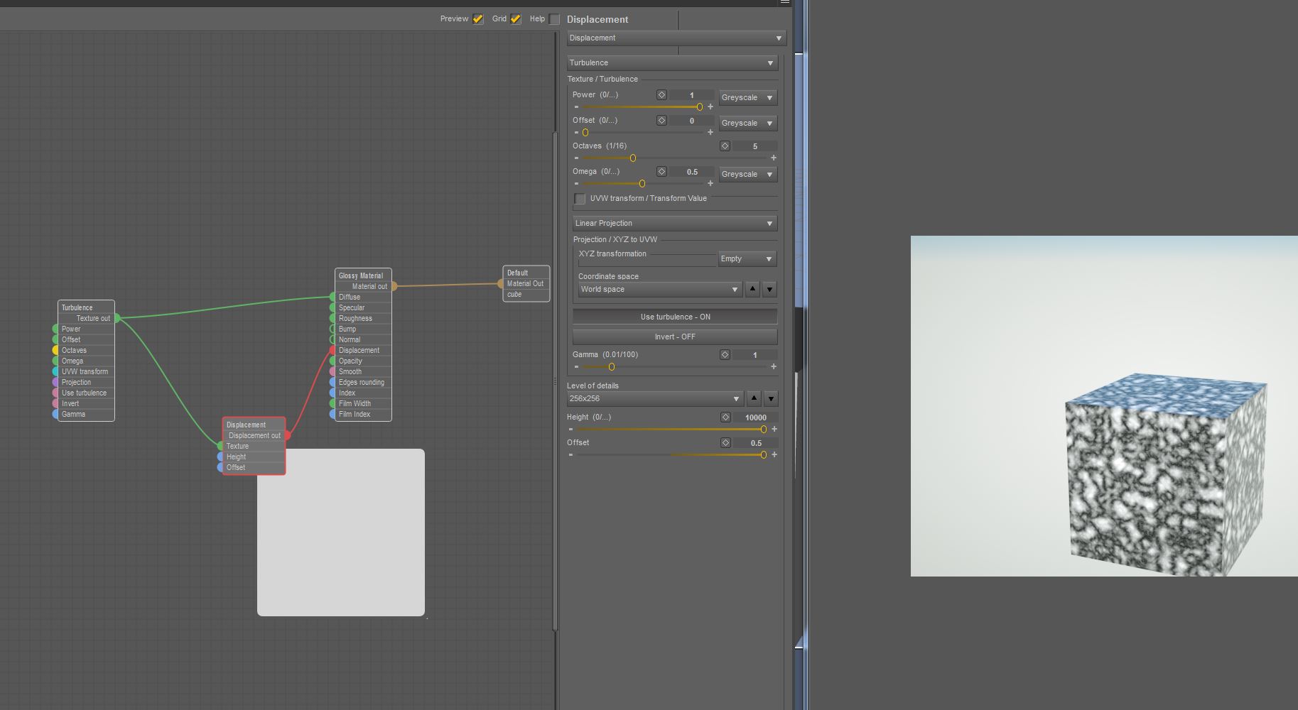

Anybody know where the "my presets" folder for materials is located? Or where I can set this?
Also, how can I use the displacement in the NGE? I set it up like this but its not doing anything:
