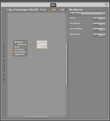

Anyone having problems with the material being loaded from Live DB with the new plugin ? I am getting everything as blank material.
I am attaching a screenshot. I used the tonysculptor Skin R20. Nothing is set for that. All settings are empty.
t_3, any ideas ?

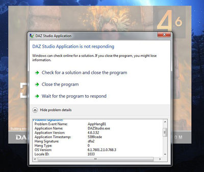

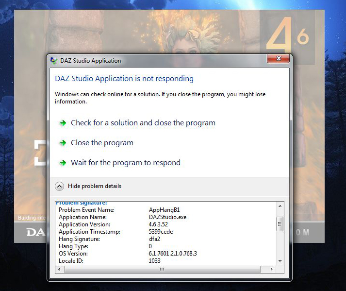

After installation of the 85mb 2.1 update Daz Studio does not open at all.
I still receive this error after re-installation of full installer version and re-installation of the 2.1 updater.

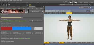

hamer66
Posts: 29
Joined: Mon Nov 25, 2013 6:24 pm
A quick test, with build 4166. despite some crashes having fun ;-). Also Really happy with the import options
