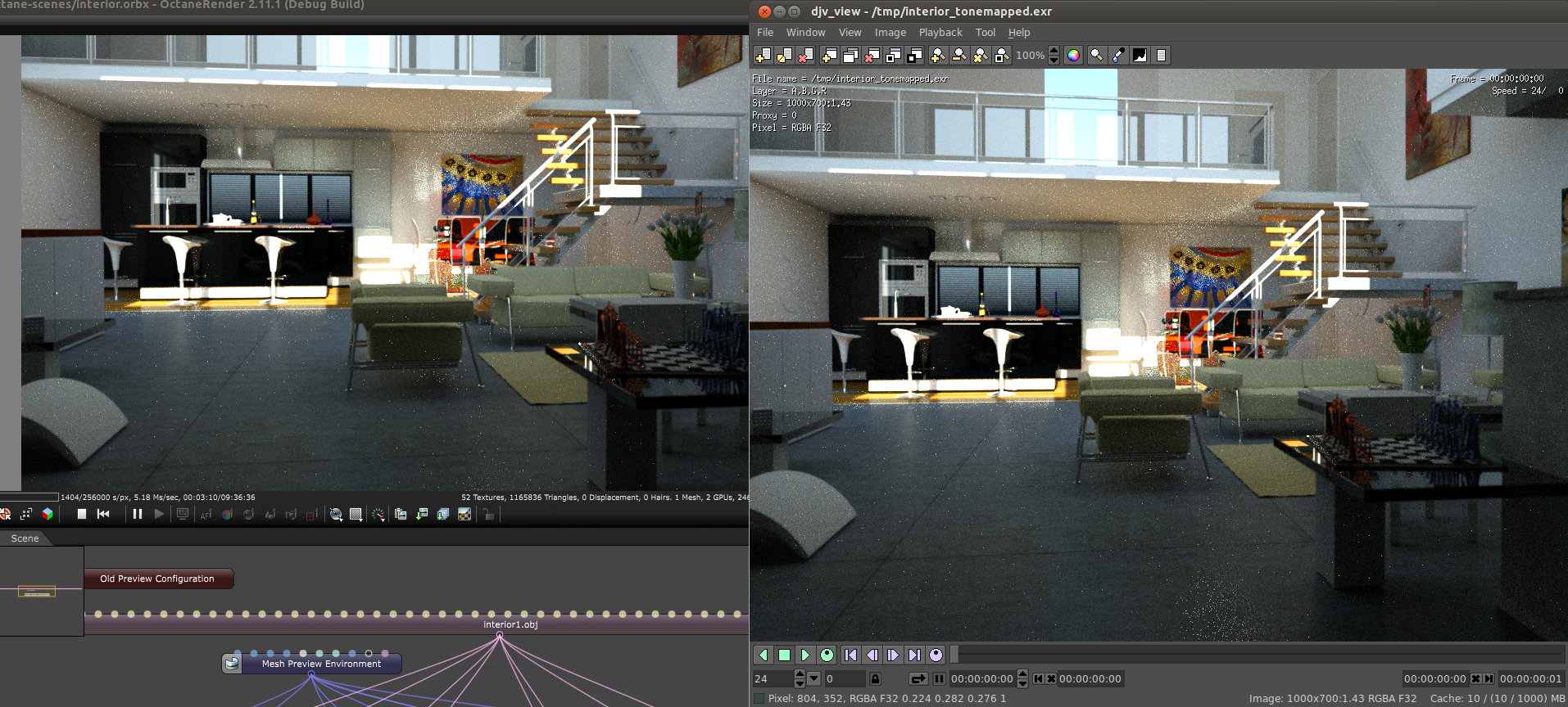

I cannot reproduce that issue here. The images look the same in my viewer and in Octane:
Can you post a screenshot of the image while you're viewing it and the .exr file in question? What program are you using to display .exr images? Could it be that the viewer itself is applying gamma correction (i.e. correct to 2.2 - default display gamma)?

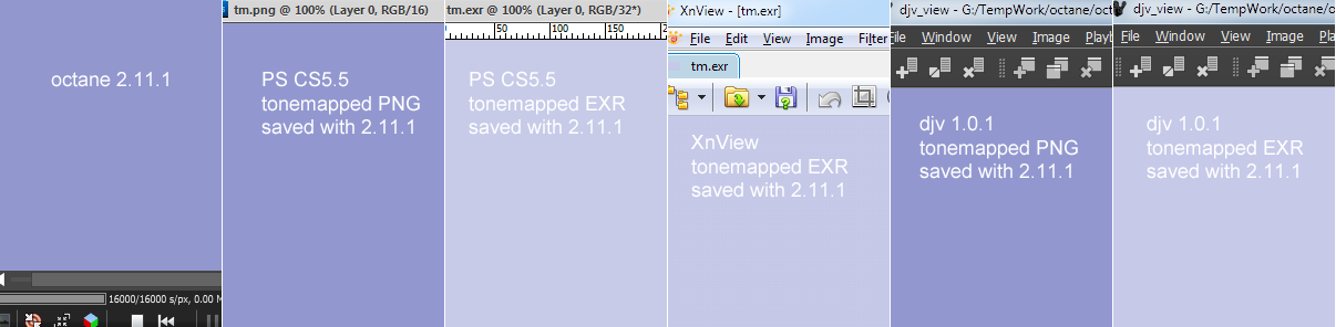

I'm using 3 different programs to view the EXR: Photoshop, XnView and djview. All 3 display the tonemapped PNG correctly, but the tonemapped EXR doesnt match.stratified wrote: Can you post a screenshot of the image while you're viewing it and the .exr file in question? What program are you using to display .exr images? Could it be that the viewer itself is applying gamma correction (i.e. correct to 2.2 - default display gamma)?
As you mentioned, the viewers ARE applying a display gamma of 2.2 (or sRGB in photoshops case) but this is correct behavior, because EXRs should be in LINEAR space.
Here is a screenshot. I have also attached a zip containing the OCS and the saved tonemapped PNG/EXR files.

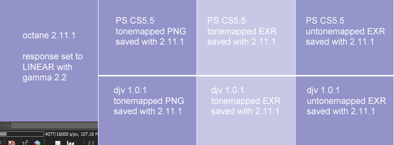

Here is a better test. I have set the octane camera response to LINEAR and the gamma to 2.2 so we can compare the tonemapped and untonemapped images.
I have attached a screenshot. The project files and saved images are also in the zip.
As you can see, the untonemapped EXR is being saved linear (1.0) so photoshop and djview (also xnview which I didnt add here) display it correctly. The tonemapped EXR is being saved with a 2.2 gamma burned in, so it displays washed out.

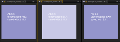

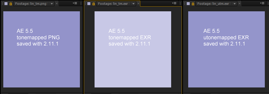

EDIT: I have also tested this in After Effects CS5.5 and have exactly the same results. The tonemapped EXRs appear washed out, while the untonemapped EXR and PNG are correct (screenshot added)

Yes, that's correct: If you save an image tonemapped, well, then it's tonemapped, i.e. has the camera response curve applied to it. If you select a camera response curve other than "Linear/Off" the result will be non-linear. Most response curves have a gamma of ~2.2. I tried to remove that "implicit gamma" a while ago, but got blasted for it and quickly reverted the change (see http://render.otoy.com/forum/viewtopic.php?f=24&t=41404).funk wrote:Here is a better test. I have set the octane camera response to LINEAR and the gamma to 2.2 so we can compare the tonemapped and untonemapped images.
EDIT: I have also tested this in After Effects CS5.5 with linear workflow set up and have exactly the same results. The tonemapped EXRs appear washed out, while the untonemapped EXR and PNG are correct.
EDIT: The problem is that all HDR viewers assume that EXR images are linear and apply a tonemapping to sRGB on top of the already tonemapped result we saved which is wrong of course, but the viewer has no way to find out if an EXR image is already tonemapped or not.

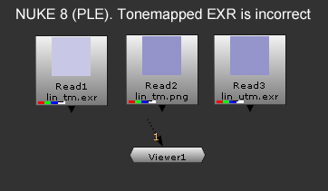

Thats correct. Every application I have tried assumes the EXR is linear. Photoshop, After effects, djv view, xnviewabstrax wrote:
EDIT: I also just tested NUKE (personal learning edition) and got the same results.
So, in conclusion if the major compositors (AE and NUKE) assume linear EXRs, I think this should be fixed in Octane (only tonemapped EXRs need to be fixed).
