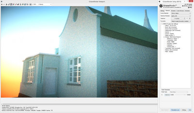

Ok, but can we then please have the menu attached to the render window? Something like the image below.
This would be a huge change to the plugin Seeker. In .NET (the Revit API), the code is attached to the window, so merging the Viewport and Setup windows would mean re-structuring all the plugin code - and this change may not be something that all users want.

I understand. It's a shame that the .net framework does not allow for nesting windows in a more flexible way. Could we consider in future? Perhaps we could do a pole? I am sure most Revit users would agree with the benefit of a simplified windows environment.
Seeker
