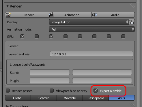

You may excuse my lack of knowledge, but how exactly do you guys export from Blender to Alembic?
My search for Alembic exporters ended in 3 year old test builds (2.60) on graphicall or some other, rather old mentions to possibly use it as point cache in the future.
Do you compile you own Alembic exporter builds? Is there an addon I don't know of?
The reason I'm asking is simple: At the moment I cannot use/test Octane 2.0 standalone's motion blur feature. The 2.0 Blender addon isn't released and OBJ exports no animation data.
Sorry for the off-topic question.
i7-920 - 6 GB RAM - GTX770 + GTX560Ti - Win 8.1
JimStar
Posts: 3846
AndreasAtteneder
The elephant was not seen by us.:mrgreen:
AndreasAtteneder
Posts: 13
Joined: Wed Feb 12, 2014 12:32 am
Location: Austria
LOL :D
Altough i feel a bit dump now, the excitement for the new discovery overwhelms :)
To my excuse: on my screen-setup the "Export alembic" string was shortned to "Export ..." ;)
anyways, thanks for the quick answer!
