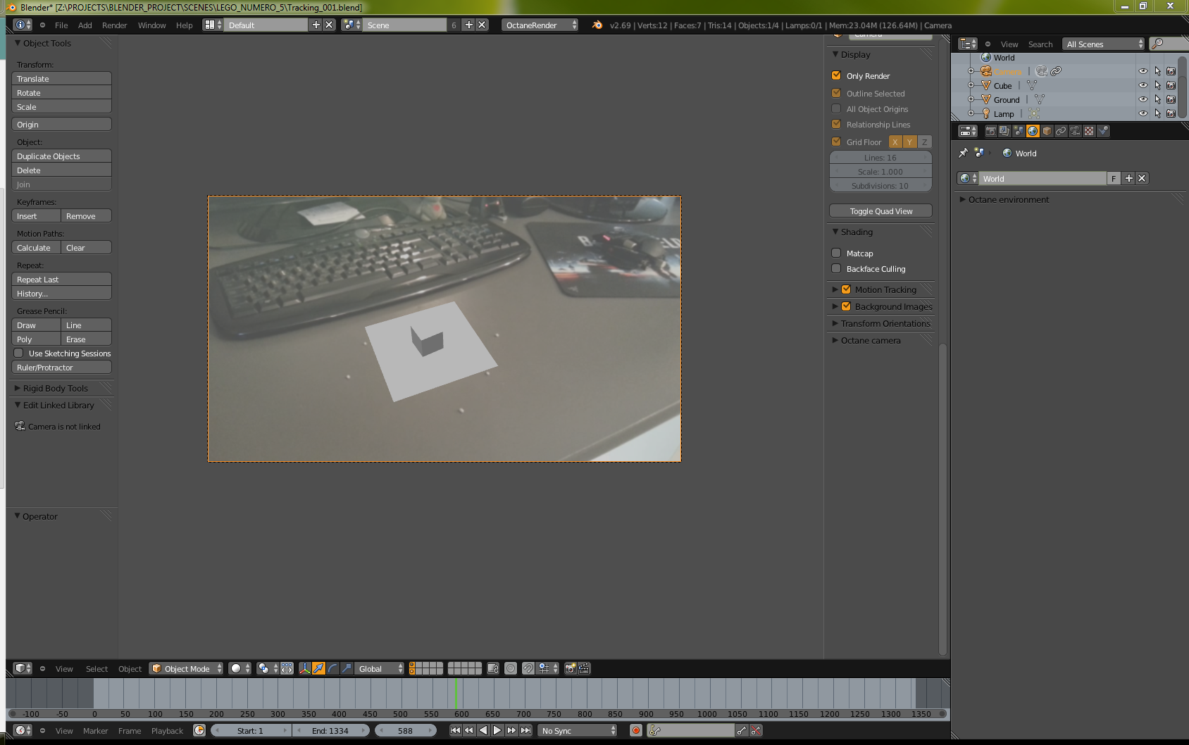

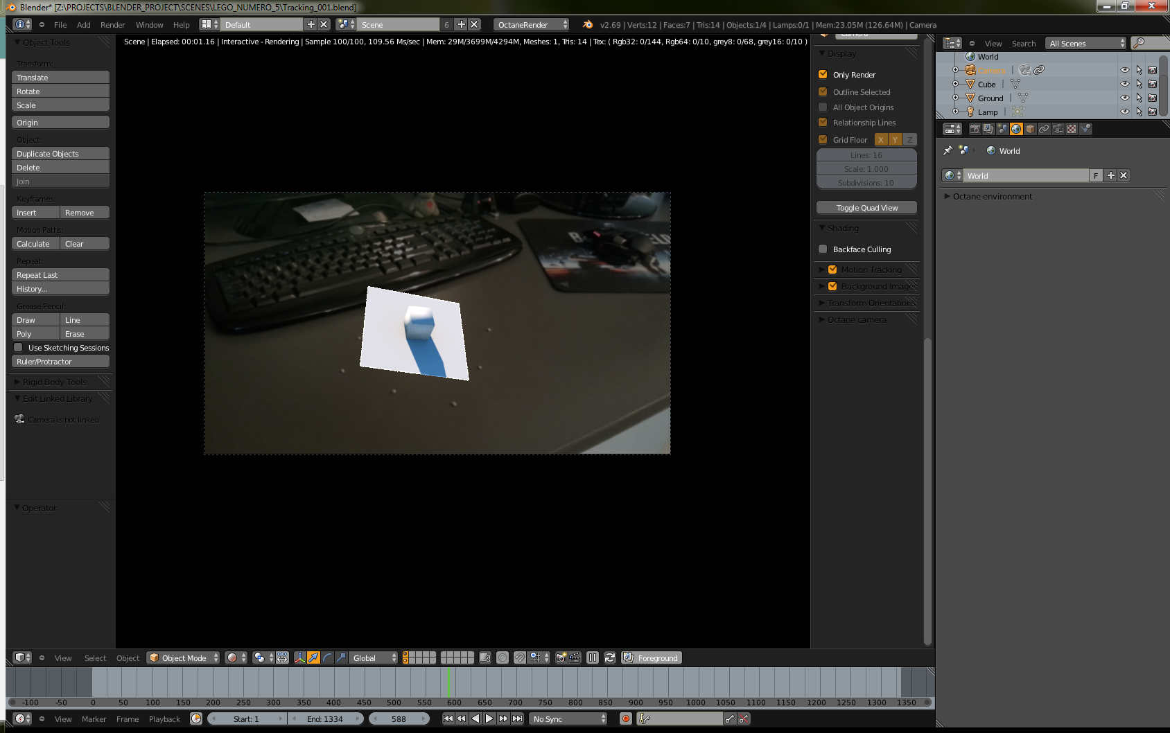

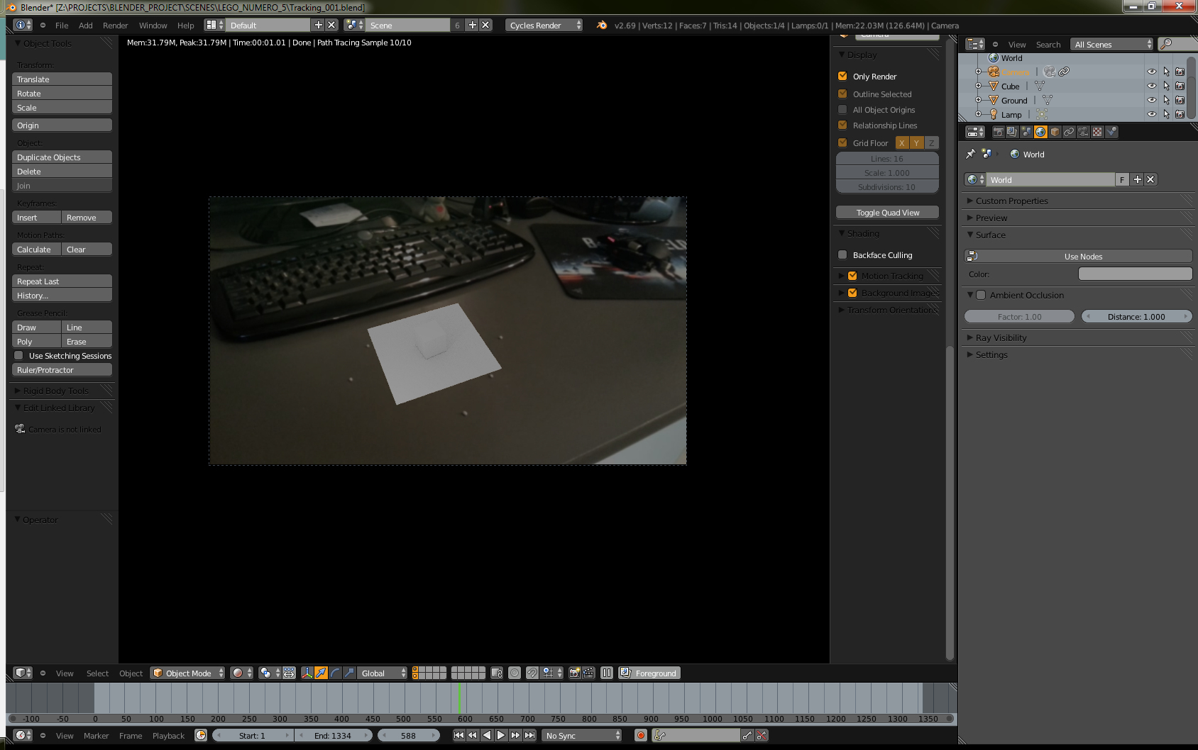

I found something strange. The camera is not well transfert from a Tracking data, look below the screenshots.
Hope will fix
Matt

Also saw, when you rotate the environment on Z with Octane transform, it turns on the Y axis of blender and not on the up axis. Also too, Alembic for me works only in /tmp\, not at all in other places. In viewport rendering, sometime, the shaders at not rebuild at all or do error and not render. stop the interactive mode, relaunch and all working good as soon as made a new connections in shaders. Shaders also, need a rgb spectrum in mix or float value to work properly, instead not take care of values.
Hope can help to fix Blender Octane,

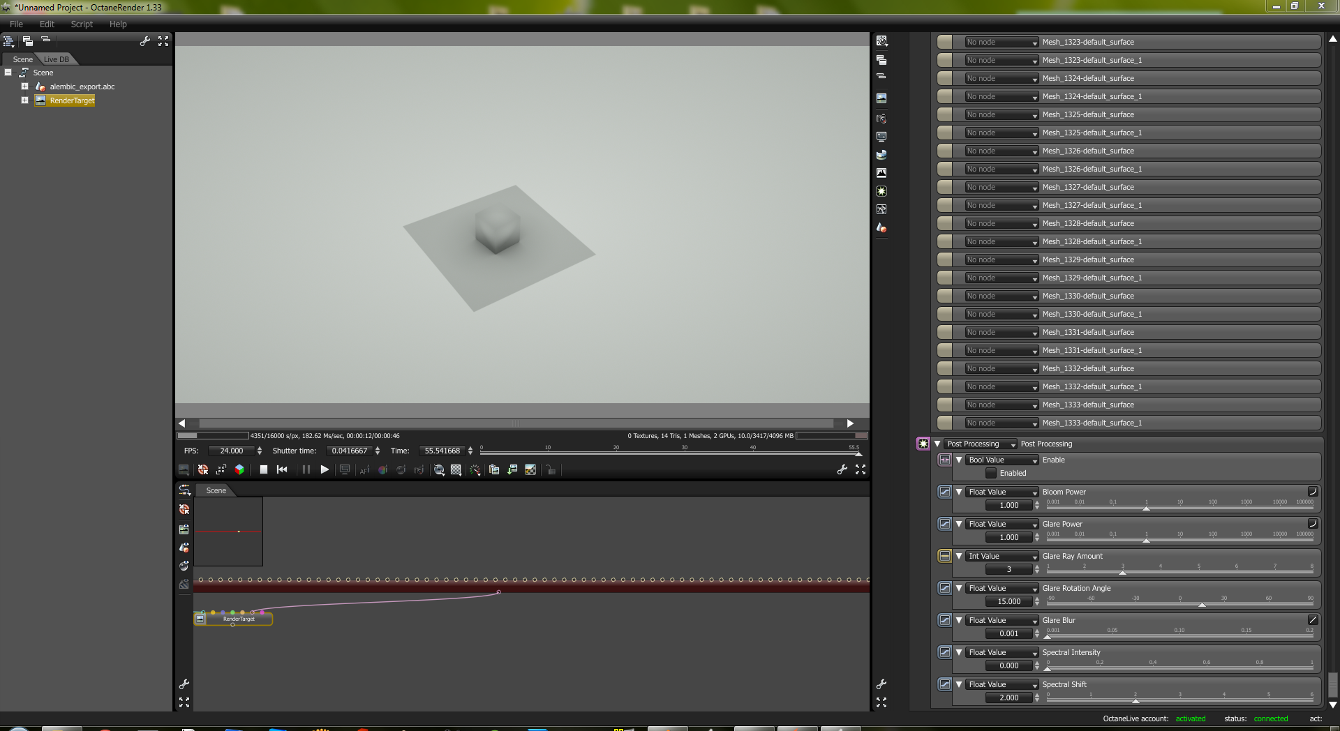

Also this, when alembic is exported ( when it wants ;) ), the alembic haves one materials per frames. exemple, I had 1333 Frames exported and build 1333 materials. It's quite unefficient. Also, the exported alembic have the same problem that the plugins, not match the real camera mouvement. I think, due to the mouvement and the rotate axis from IBL, two axes were permuted in code.
Hope can help again to debug this fabulous plugins !!!
Thanks,
Matt
aLeXXtoR
Posts: 294
Joined: Sat Oct 29, 2011 5:38 pm
Location: Russia, St. Ptetersburg
Hi!
I had this issue too — it seems that this happen when you have not-node-based materials. When I changed all materials in the scene to nodes everything became normal.

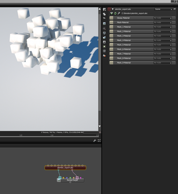

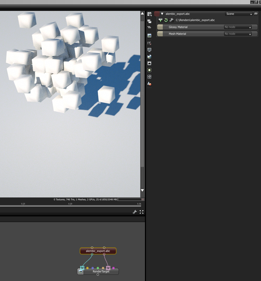

Posts: 3845
aLeXXtoR wrote:it seems that this happen when you have not-node-based materials. When I changed all materials in the scene to nodes everything became normal.
This is not the issue, it is stated in description of this new feature. This behaviour is normally expected if you export non movable geometry. If you decided to not move the already existing geometry - the new geometry is reloaded every frame. Another geometry - another set of its material pins.
aLeXXtoR
Posts: 294
JimStar wrote: This is not the issue, it is stated in description of this new feature. This behaviour is normally expected if you export non movable geometry. If you decided to not move the already existing geometry - the new geometry is reloaded every frame. Another geometry - another set of its material pins.
Sorry, seems that I've missed it... Where I can read more about this?
I have a number of "non-movable objects" marked as Global. And animation mode in Render panel is set to Full — but now I get just one material for all frames. It seems that I don't get this feature right. :lol:
Win 10 Pro 64bit | GeForce RTX 2070 SUPER 8Gb | AMD Ryzen 7 3700X | 32GB RAM
WebSite
Showreel
JimStar
Posts: 3845
aLeXXtoR wrote:Sorry, seems that I've missed it... Where I can read more about this?
It seems something wrong is set in your scene.;)
This is what is exported with all meshes set to "Global" and animation mode set to "Movable proxies" (the same mesh in all frames):
And this is with all meshes the same "Global" and animation mode set to "Full" (the different meshes in every frame):
