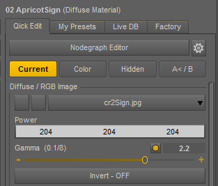

the object layer node is part of the geometry (was available only in the new octane api = not in 1.2) but nge is about materials only so it can't be in the nge anyway.
the problem i have with them is: they really slow down rendering, so it is not a good idea to generally place them into the geometry hierarchy (for every mesh object). they will be most probably going to be extensions to be controlled via a new octanerender property group in the scene node parameters (like in the camera node), where they can be explicitly turned on and off.
on the other hand the plugin already uses another (faster) method to completely hide objects, that i a) like to keep (because it is faster) and that is also going to be a simple switch of any material, like this:
