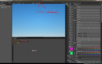

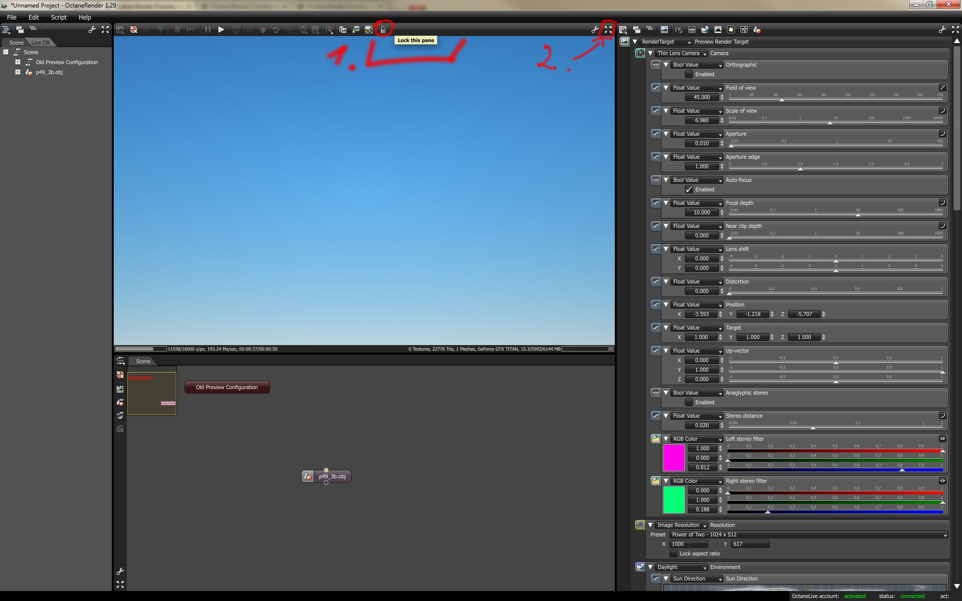

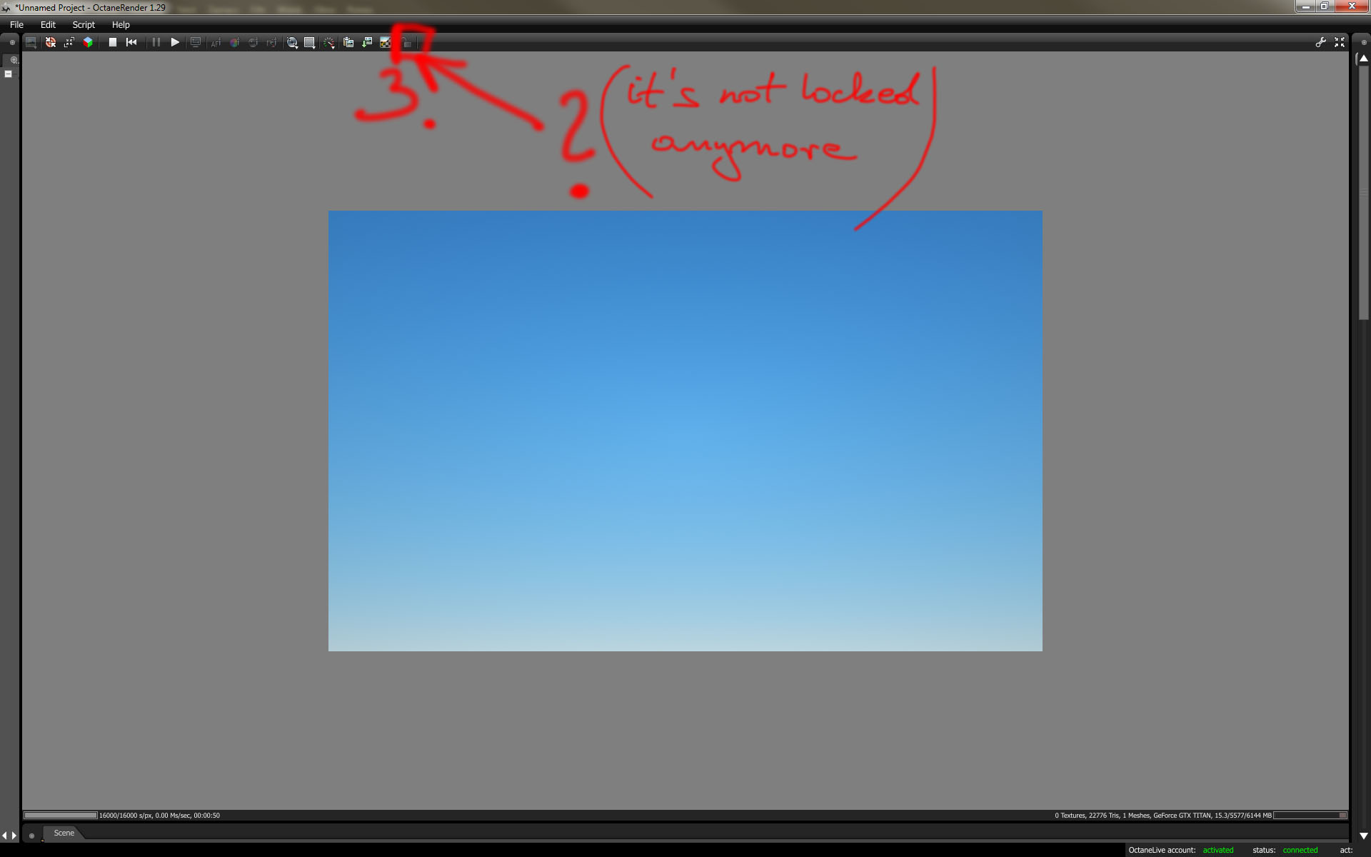

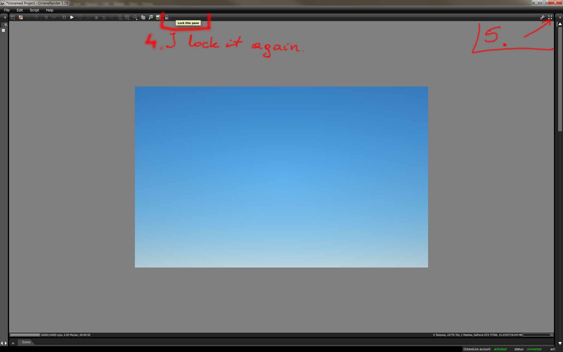

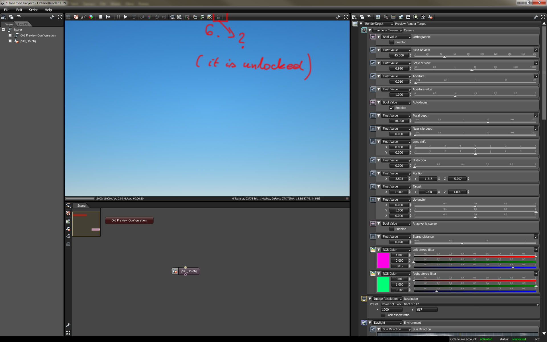

smicha
Posts: 3151
Location: Warsaw, Poland
abstrax wrote:
smicha wrote: ...
As I mentioned some time ago, the lock button (the padlock) is not working - when I maximize the preview window it is being deactivated (I use dual monitor setup).
Hmm, can't reproduce it here. What exactly are you doing? Thanks.
Here are the screenshots.
abstrax
Posts: 5516
smicha wrote:
abstrax wrote:
smicha wrote: ...
I see now. Thank you.
