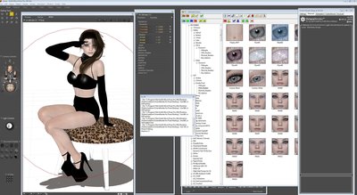

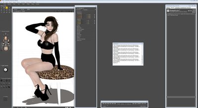

Me again... hate to be a pain...
But this is what I get after loading the scene I was just working on with the 1.23.0.13 version...
Notice there is no material list tree unless I right click on it and select expand all.
Second image is without "Extended Library" script open or running.
LOADING EXISTING SCENE - ERROR AFTER LAUNCHING OCTANE_WITHOUT EXTENDED LIBRARY OPEN.jpg
There has been a change made to Octane 1.24 in the transform positions code with the plugin is not handling correctly - I need to check with Otoy prior to fixing it.....back to you soon.
