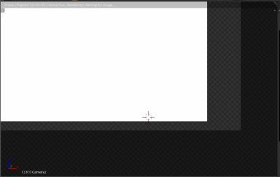

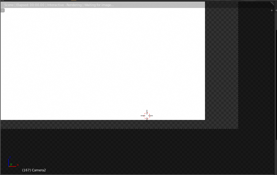

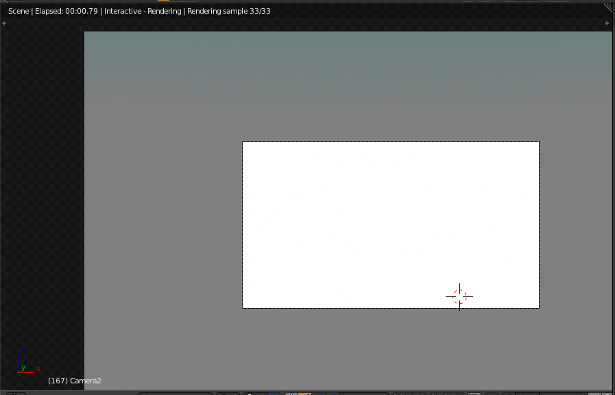

would it be ok to post questions here regarding material creation :?:
possible Bug? regarding Renderpreview;
When you have pressed Render and are using Renderpreview again and are still within the cam and scrolling out or in or panning to the side you can move the preview and you are somehow able to see the Pixel length of the image without the correct view from the camera
outside of Camera you won´t be able to pan or move the renderpreview anymore.
Win 7 64 | Geforce GTX570 + GTX260 | i7 3770 | 16GB
JimStar
Posts: 3852
myclay wrote:would it be ok to post questions here regarding material creation :?:
Yes, I already wrote somewhere about it, perhaps just in closed alpha-testing threads... Will try to explain here.
You got this behavior due to camera view is shifted inside viewport. In this case there are only two ways for the plugin to fill the resulting gaps on sides of image
- change the FOV accordingly and render the much bigger image and not use rest of this image which is obscured by viewport
- get the same exact shifted region of the image from the engine
But the Octane engine, as you know - does not support region render so far. So, the second approach is unpossible.
And the first approach - can increase the render time by few times when the shift is high enough...
So, so far - it is only the compromise solution when you use viewport camera shifting...
