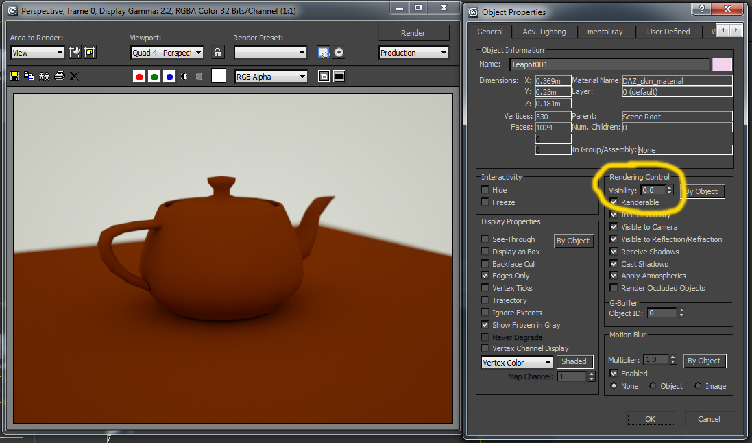

Currently working with a character rig that hides/reveals certain parts
using the OBJECT VISIBILITY option in 3dmax. I noticed that OR max plugin
still renders objects that are set to VISIBILITY value 0 (ergo, should be
invisible to renderer).
Image attached show simple test scene where the teapot visibility is set to 0 (off)
but where the object still shows up in the OR max plugin render.We can rework the rig to come up with a different solution for reveal/hiding objects ... but would be really nice to know
this isn't a bug specifically on our end.
Assistance appreciated Otoy team.

with octane i'm not sure you can play with visibility.

Himajiqmud wrote:Hi Karba
This is my first post, so apologies if this has already been addressed elsewhere.
Having a lot of fun with OR max plugin, great tool Otoy team.
Congrats on amazing work on OR tool so far.
Best Regards
At the moment you can switch off renderable flag
