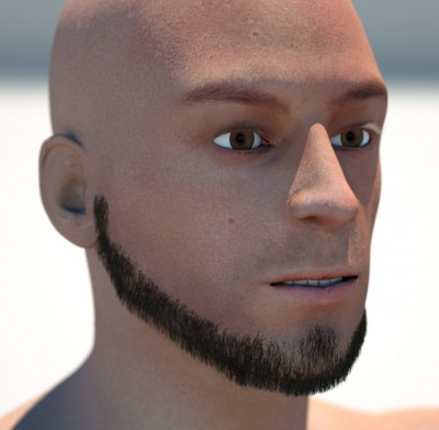

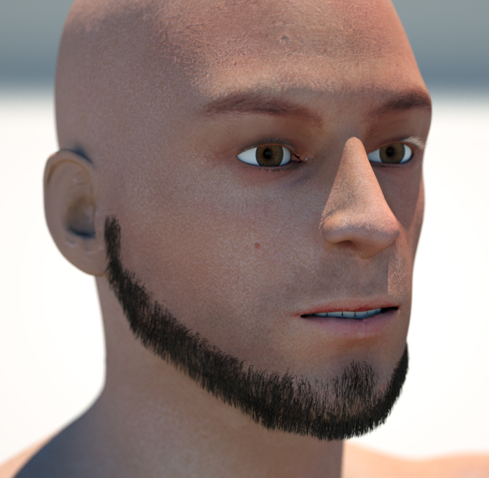

Just to add to that (and post a quickie render). When you GoZ your characters head or whatever part to ZBrush as a subtool and then add your fibermesh hair and accept it, you will now have two subtools. That is, the character and the fibermesh will be two separate subtools. Just select the fibermesh and GoZ it back to Poser. Poser will ask if you want to import it as a hair prop, click yes and select the part of the body you made the hair for. The fibermesh will import and fit exactly on the body part as it did in ZBrush.
Like I mentioned, this is just a quickie render, the fibermesh took all of two minutes to make and GoZ back. It can be made much better, but it's almost 6am here and I've been out all night and need to fall into bed asap.
