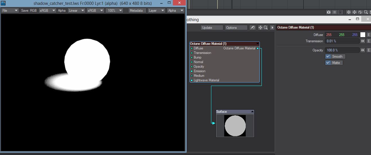

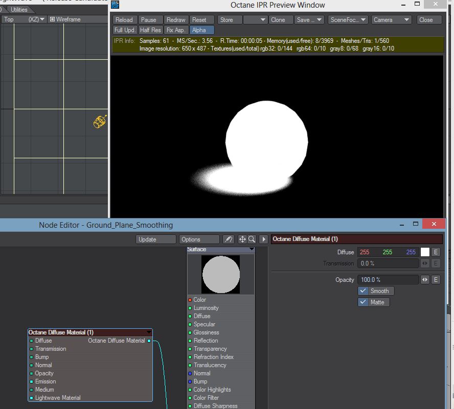

I've discovered another bug. The "shadow catcher" method from the standalone doesnt work in the LW plugin.
On pg 117 of the octane 1.10 manual it tells you how to set it up. In the standalone, we can see the shadow catcher working in real time. In the IPR we just see BLACK where the matte materials are.
Once you save an EXR from the standalone, you can see the shadows in the ALPHA channel. If you do the same in the LW plugin, the alpha channel is saved without shadows

Here is a quick test scene in LW and standalone using a shadow catcher. The LW version saves no shadows in the alpha

Thanks for the scene. You are right, there is a problem with the plugin and the fact that Standalone doesn't add a default transmission node to the diffuse shader. Plugin by default add a float value to the transmission input, and set it to 0%.funk wrote:Here is a quick test scene in LW and standalone using a shadow catcher. The LW version saves no shadows in the alpha
I am not sure why, but if you have this value to 0%, shadow catcher (using the Matte switch) doesn't work. Workaround is to set the transmission to something greater than 0% (0.01% is fine), and with this value plugin works like standalone.
I am going to see if is possible fix it.

I fix this bug for the next release. Now with "Matte" enabled, default "Transmission" is disabled (no node is added to the shader input). Anyway you can plug any texture in the transmission input if you need transmission+matte for something.funk wrote:Thanks for the workaround Juanjo. The alpha button on IPR is working fine here
