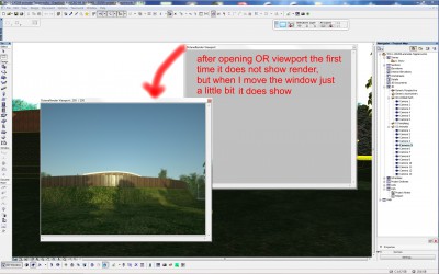

I encountered two things:
1. after opening OR viewport the first time it does not show render, but when I move the window just a little bit it does show.

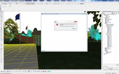

2. when not opening the OR viewport before AC photorendering I get a material-not-loaded error. If OR Viewport needs to be loaded a message might be better instead of going through the errors.
This looks like a Windows display adapter problem. Is it random or reproducible every time?
Yes, when you open a photorender, ArchiCAD is renaming some materials! For example, a material name of "metal chrome (polished)" is send to the photorenderer as "metal chrome", so the ArchiCAD plugin cannot match up the materials, so it pops the warning. I made a change in the last patch which substantially reduced the incidence of this, but it is still sometimes occurring. Artur has sent me a test scene where this is still happening so I will investigate this futher tomorrow.
Paul
Seems like random.

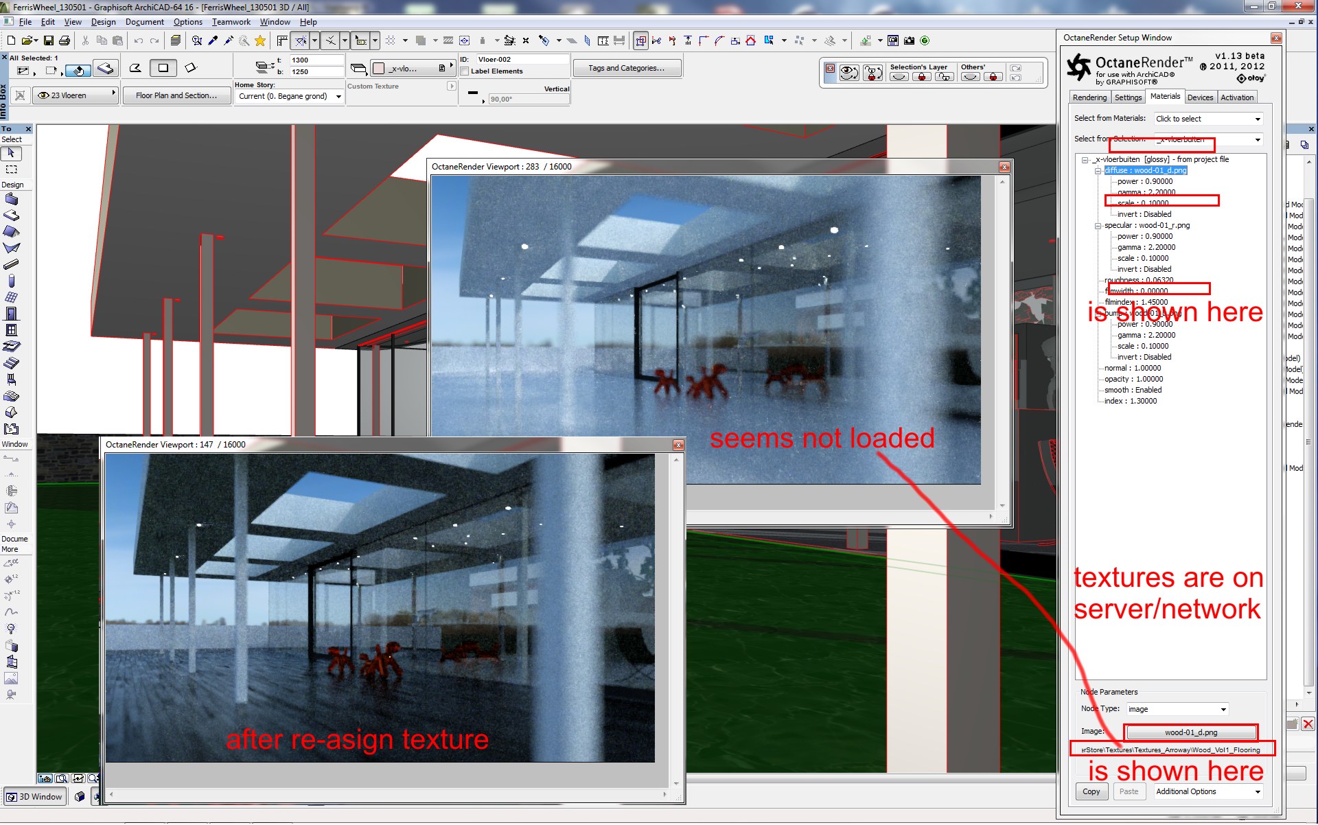

No problem here, but I want to report this.. maybe it is something worth to you.
I started a project from a while ago and the materials were shown in the materials,
but the were not loaded in the model.]
I think this has to do with the location of the materials. They are on my server, so they have to be loaded over the network? Or are they cachec local anyway?
Or maybe it has something to do with the fact that I updated the plugin in the meanwhule.
Anyway when re-assiging the textures, save, close and re-open the AC and plugin everything is fine.
greetings, Jeroen

Hi - new version posted - pls see http://render.otoy.com/forum/viewtopic. ... 84#p137984. This should remove the majority of unmatched material issues in the Photorender. If you find any situation where the photorender is not rendering a material that the Octane Viewport is, pls let me know.
Thanks to Artur and Jereon for assisting in tracking the issue down.
Paul
