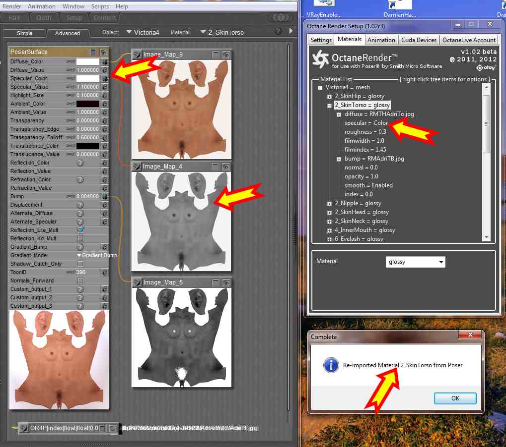

Ken, on further inspection, this appears to be working correctly. The screen shot you've provided is showing 2_SkinHip, but the Octane node in the screen shot is 2_SkinTorso. Would it be possible to send a screenshot where the materials are the same? And pls rightclick the material in the Material tab of the plugin and "Re-Import this material from Poser" first.
Ok, here it is. The results were the same. One question: when the plugin re-imports a material node from Poser, is it getting the info from the actual Poser material or the nodes it had previously stored along with it?
It will read it from the nodes stored in the Poser Material (if there are any). The next version has an option to delete any store nodes. Maybe that is your issue? Do you have stored nodes on those materials?
[EDIT: I just looked at the material screenshot, and you do, so I think that is the issue. Select all the node and delete them and then re-convert].
That was it - the plugin was not getting the specular maps because it was not in the stored shader nodes when the plugin created them. Deleting the stored nodes in Poser allowed the new maps to be loaded in the plugin - finally! :D
