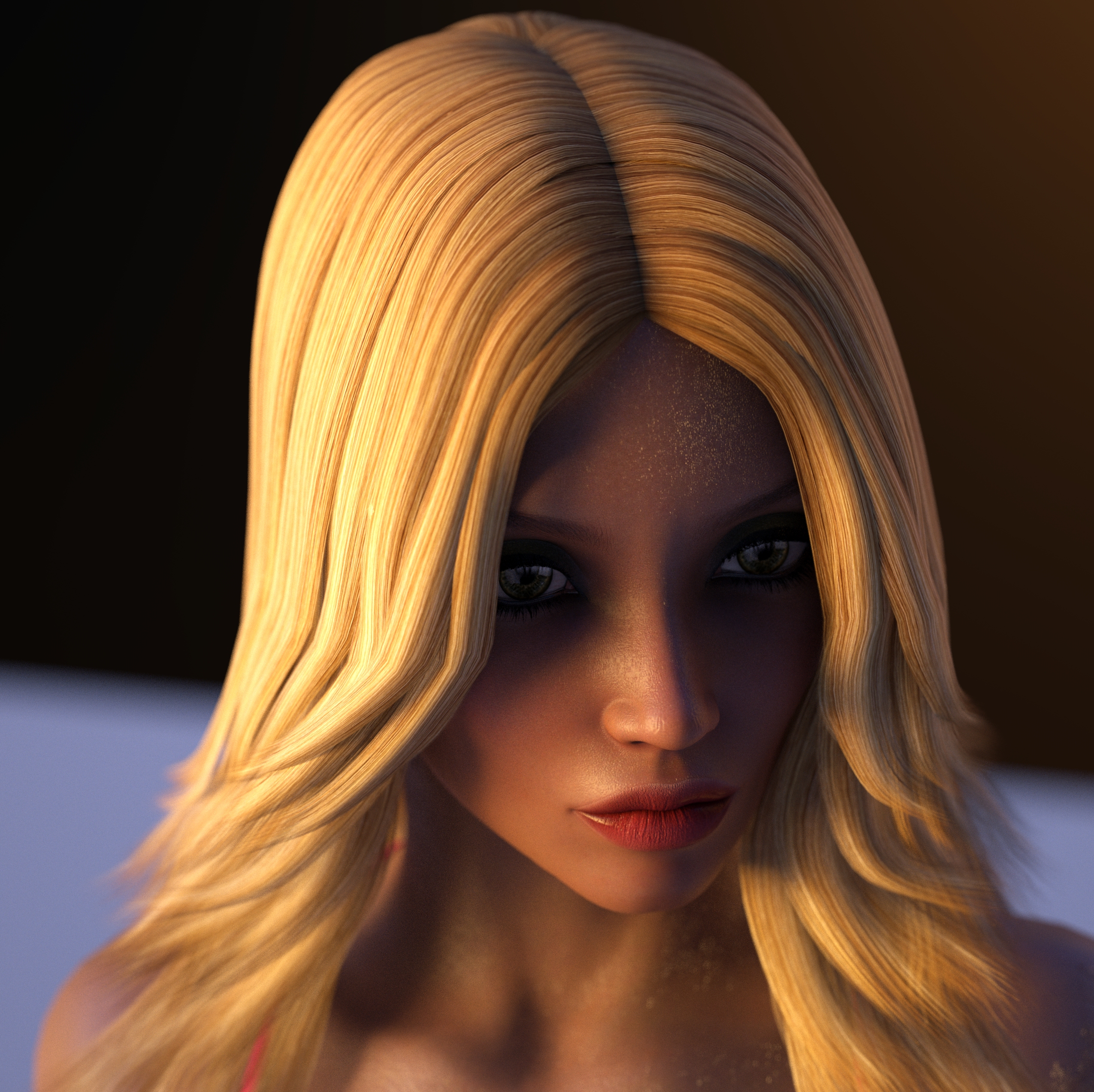

Im bussy rendering a more complete image... I think I could dampen the shiny skin a bit by increasing roughness. Just figured this out today... Gona play with it a bit see what I learn.. and see if I can combine this with sss to get a real as possible look.

Updated Image. I tried exporting and then importing the face material to the rest of the body retaining existing image maps ... but it seems like on the different body parts the Bump map image for specular is stretched .. making weird patterns on some body parts. I see if I can find a way around this.
Updated Image.
Updated Image.
The latest version converts the image scale parameter from Poser - so I suspect when you import with "retain existing image maps", because it is not replacing the texturemap, is it also not replacing the texturemap scale (which is a subnode of the image). Previously the texturemap would always have been saved with a scale of 1. I need to think about if this is the correct behavior or not....

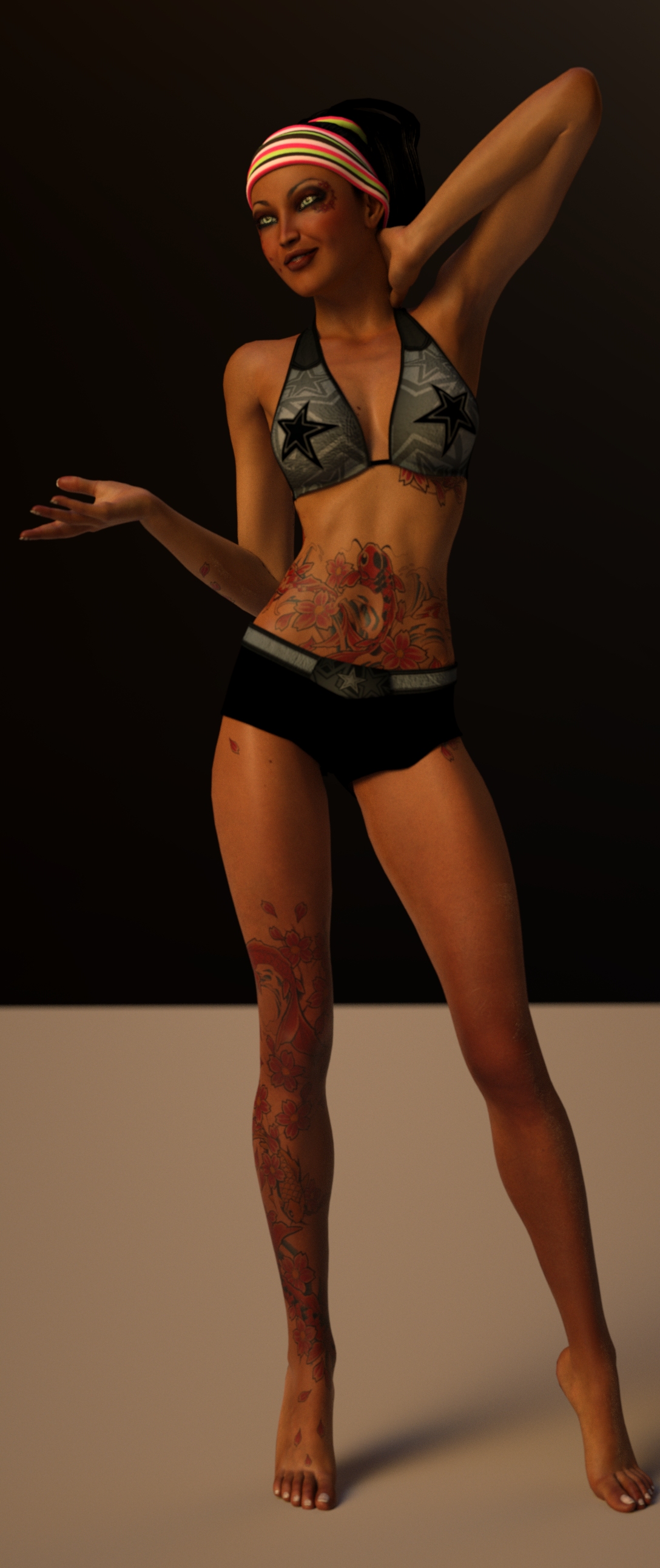

This is using that specular skin shader with a full character. you will notice she line on the thighs where the textures are not aligned

Hi Witpapier
I am reasonably sure this is because one of the maps is scaled, and the scaling got changed by the "paste retaining texturemaps". I have a new version (1.02r) ready which fixes this issue, and I will upload it later today. You can confirm that this is what is causing your issue by checking if any of the texturemaps in the Poser material for that figure has a u or v scaling.
