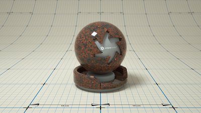

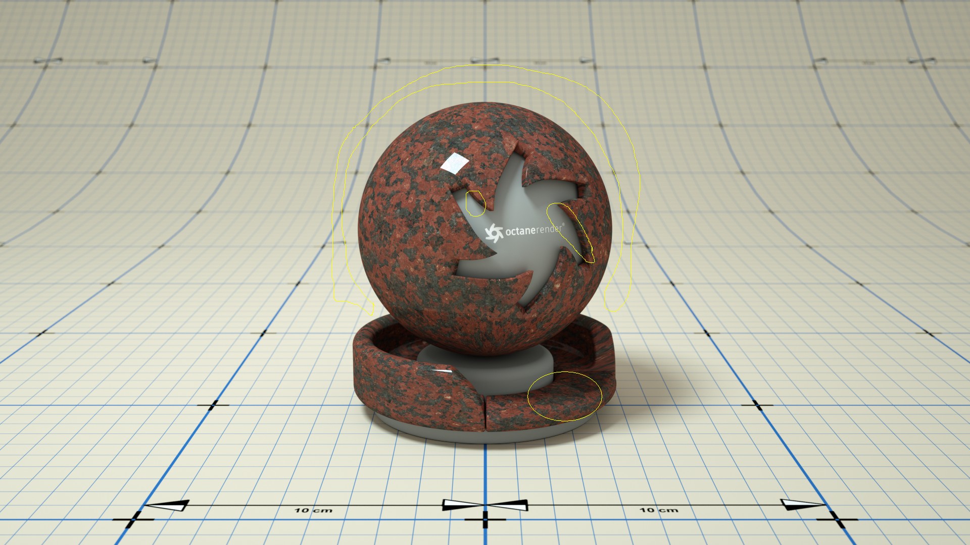

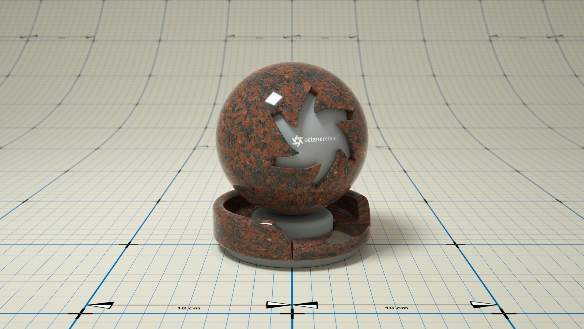

Is it me or is the new glossy / reflection system bad?
Check out this comparison of 2.58e vs RC3
Let me also include the Red Africa granite I made...
I tried to change the node for the new RC3 to make it look like the old one but failed
I can't get it to gave this nice reflection at the yellow parts (especially around the ball)
Linux Mint 19.3 | GTX-1080Ti | AMD FX-8320 (OCed 4.4GHz) | 16GB RAM
abstrax
Posts: 5516
Synthercat wrote:Is it me or is the new glossy / reflection system bad?
With beta 2.59 or beta 3.x we introduced correct handling Fresnel reflections, as well as allowing you to disable Fresnel completely. You now control the Fresnel reflection by the index input pin. A value <= 1 disables the Fresnel effect. Unfortunately it's pretty hard to automatically convert old materials and to calculate the correct index of refraction. Because of that the index value is set to 0 by default, which makes the specular reflection independent of the viewing angle. This affects all glossy materials that were created in older versions.
In your case maybe start with an index of 1.5 and then try to tweak both the specular pin as well as the index.

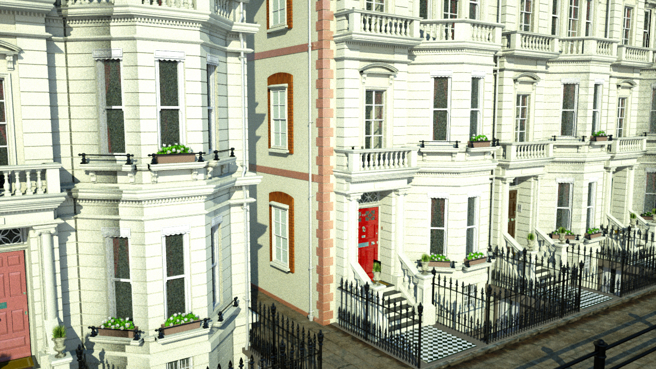

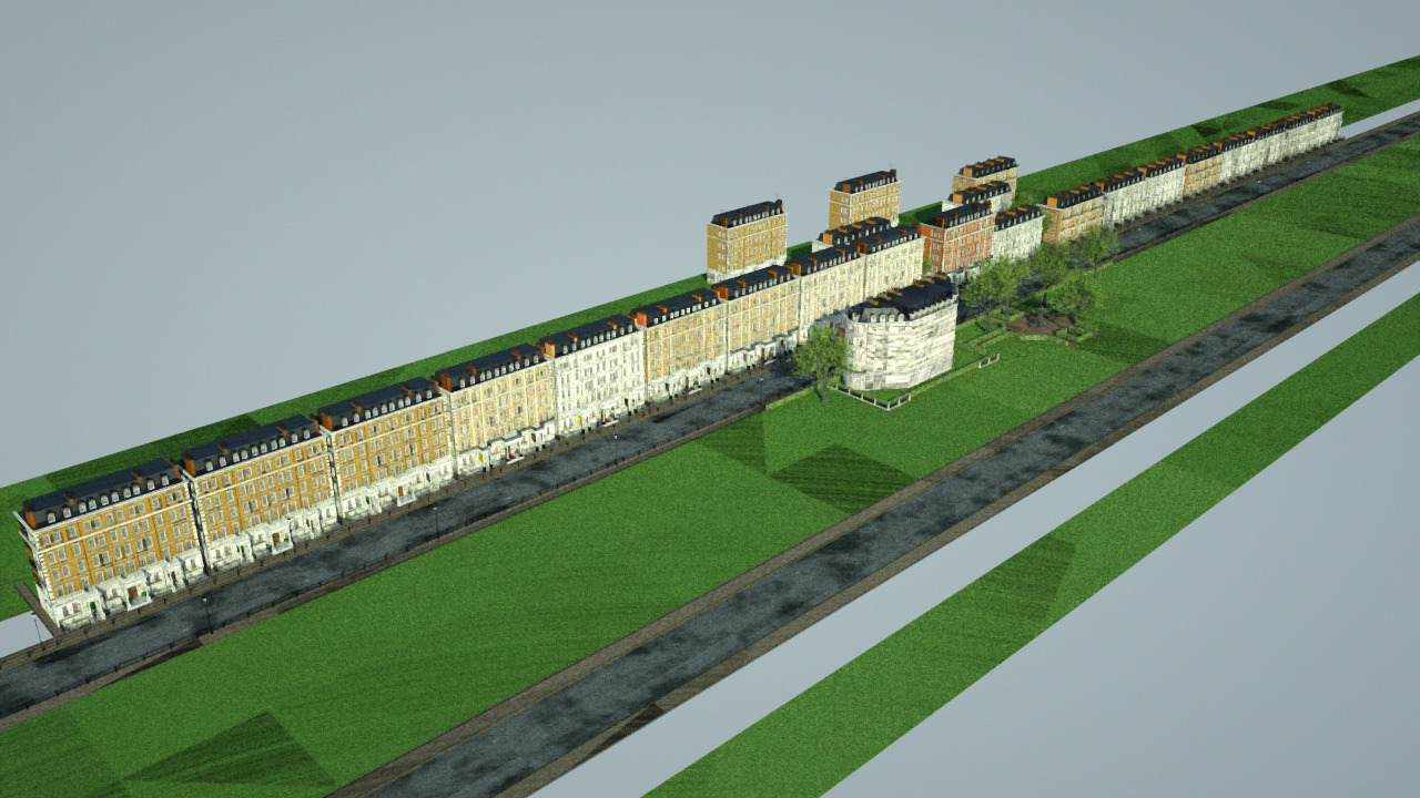

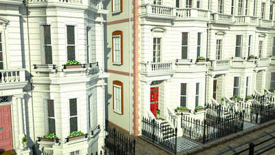

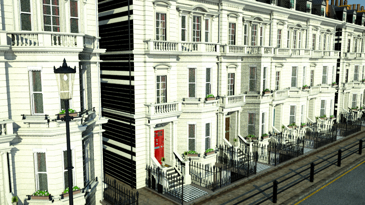

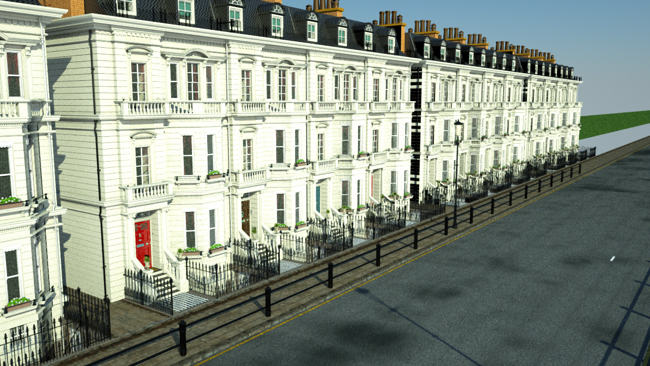

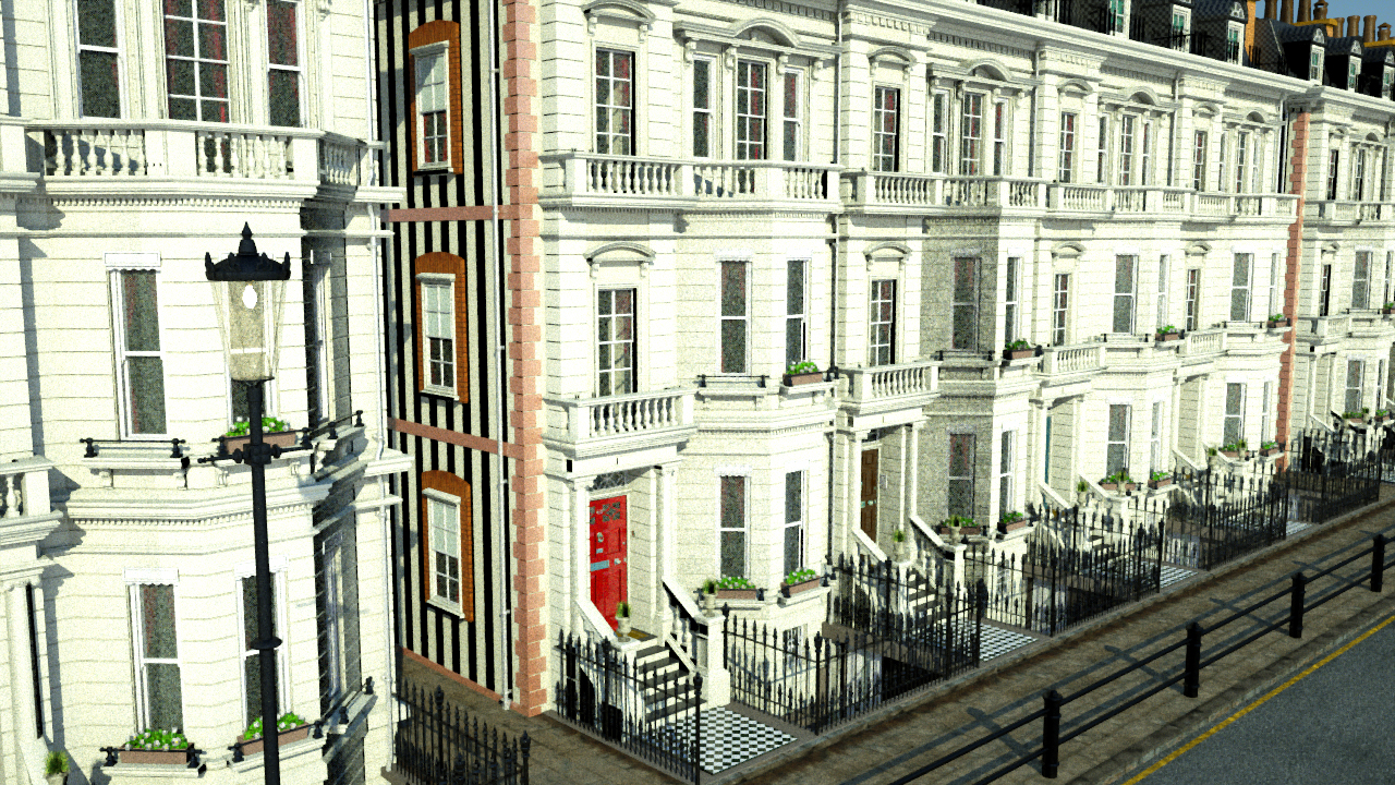

I am encountering the same trouble : fully transparent surfaces seen with a low angle appear pure black, with all Kernels.
An other bad thing occurs when the object or the camera is far from the center of the scene.
On my current London street scene, requiring a very large scene (currently more than 600 meters of length, the buildings far away from the center (more than 200 meters) show black artifacts, weird shadows, black strips (horizontal and vertical black strips, visible on the sides of the buildings, between two buildings)... and the ground green surface shows from high altitude weird patches like overlaping faces, but there are no overlapping faces.
in a serie of instanced buildings, only the buildings far from the center of the scene show the artifacts. If I move them closer by modifying their own placement values, under around 200 meters, the artifacts disappear.
This problem is also present in RC1.

ROUBAL wrote:On my current London street scene, requiring a very large scene (currently more than 600 meters of length, the buildings far away from the center (more than 200 meters) show black artifacts, weird shadows, black strips (horizontal and vertical black strips, visible on the sides of the buildings, between two buildings)... and the ground green surface shows from high altitude weird patches like overlaping faces, but there are no overlapping faces.
There is a problem with planes that are exactly axis-aligned which is hard to solve without a major speed drop and increase in memory usage. The artifacts on the grass may show up because the rayepsilon value is set too low. Do these artifacts also show up in RC 2?

ROUBAL
Posts: 2199
Location: FRANCE
@Roeland !
Does this landscape still render properly?
It is a scene that required 40 min to load on my system with 8GB of RAM only.
I finally got it : no noticeable artifact, but the scene is very different : no flat surface.
:arrow: Tested with Rayepsilon =0.0001 instead of 0.00001 : the artifacts have disappeared ! Thanks a lot ! I don't master every parameter yet !
