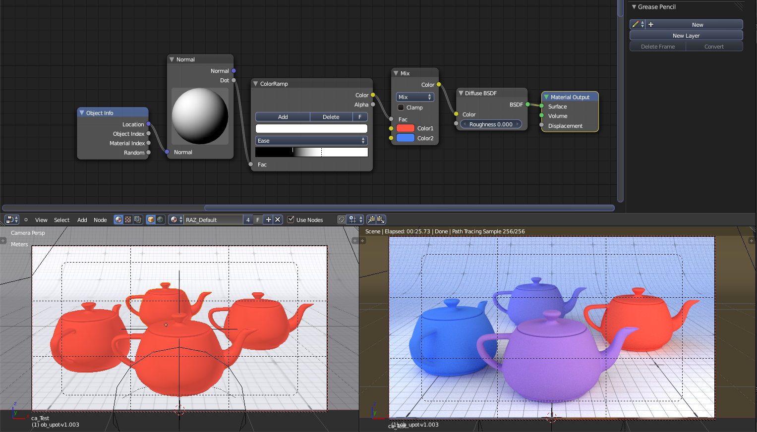

Now that instances are an integral part of Octane, the question about how to vary material or texture look across the same group of instances should be addressed. We need a way to produce a value that is to be used as factor in texture / material mixing. There are at least three different ways the users should have at their disposal to produce this value:
- Its exported from the modeling app together with the instance transforms in the .csv file (this is the most important and a must have option)
- based on location of instance
- randomly generated by Octane for each instance
The below example is from Blender. Cycles now allows to use "object info" node, with various outputs upon which to calculate a factor value for each object. All the teapots have the same material assigned, but the diffuse color is varied based on their location (in this case, it could also be random or by some arbitrary object index): The color ramp is used to smooth transition and thus achieve even more diversity.

Global coordinates don't give enough control and are useless if the objects move. If, for example, you would want to render a specifically patterned carpet with instantiated strands, you can't do it without each instance having some value assigned to it, upon which you decide what color (or any other material param you want to modulate) the strand will be.
