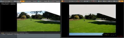

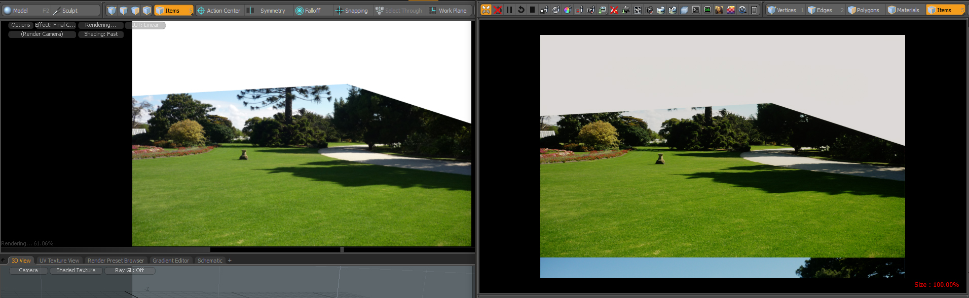

Thanks Paul, I updated the sample scene sorry there was a problem with the last one as well.
With your screenshot and testing please ignore the openGL viewport as this is glitchy with camera projection. Instead compare the Modo preview render with the Octane viewport ie:
The octane viewport on the right has a -2mm camera offset.
Is it possible to add this to the next plugin release, really much needed for ArchViz renders.

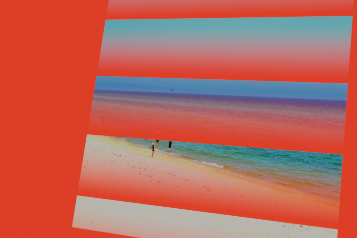

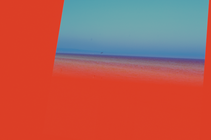

Hi Paul I'm having trouble with 'Border Mode' in Texture Images in the node editor. When I first load the scene it will default to 'wrap around'. Once I select 'clamp' in the floatimage texture node, it appears as it should. Any update to the Octane IPR will revert it back to 'wrap around'.
Sample scene attached.

Hi Dino
The Border Mode is being set from the Texture Locator Horizontal and Vertical Repeat. In theory, the Octane Image Border Mode combobox should be ignored in this instance, however the "listener" is picking up that it's being changed, so I will fix this so these changes do not get through to the Octane scene.
