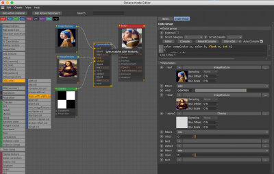

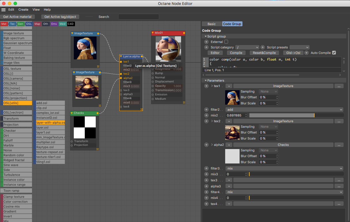

I agree with a lot of what you have said, but just FYI, there is already a pretty good OSL mixer node that includes support for a separate alpha. I do wish Octane nodes had multiple output pins for all sorts of basic info, especially RGBA for image nodes, but that seems to contradict their "One and Only One Pin" philosophy, no matter how basic and useful more might be.
Multi Mix with Alpha OSL node

i knew some OSL thing was in the work (i think i've mentioned it) but for me, using mixer 100 times per day, OSL is a no-way since everytime i've to load code in the node.
There are already several slow-down factors in Octane workflow and i would not add new ones :) This is something at the root of any Nodal toolset and i really think it must be native.
Anyway, while we wait for Otoy taking care of nodes, it can be surely useful - can you please point me at a link so i grab it ?

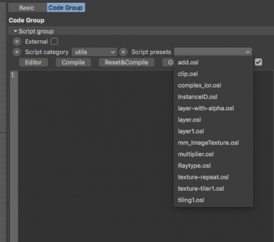

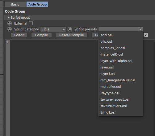

Depending on which form of Octane you use the most, you might want to submit your request directly with the plugin devs. The screen shot I posted in my previous reply is from the C4D plugin, where Ahmet has added a direct GUI interface for all the .osl scripts in your library in the Node Editor, so you can make the nodes directly, and they are nicely sorted into categories. Very handy.
There's also this interface in the C4D equivalent of the Node Inspector, which does a similar job. This sort of UI seems like it would work fine in Octane StandAlone in either the Node Inspector, and/or the OSL Editor.
OSL Node Pulldown Menus, C4D
Part of what lead to these GUI elements in C4D was a discussion about how OSL is very powerful, especially with the number of handy scripts that ship with Octane, but is underutilized by a large fraction of users because the scripts were too deeply buried. This remains a problem with Standalone.
Here's the script in question, if you don't have the plugins resources handy. It looks simple enough to mod of you need more layers.

thank you, very kind from you.
Tried it, it works but in Lw OSL do not have a GUI so i've to manage everything via plugged nodes, which makes it really unconfortable (i..e blending mode needs a node with integer value and i've to guess correspondances between 1,2,3... and add, multiply, etc).
Hopefully this kind of stuff will become native so everyone will be able to use it seamlessly :)
