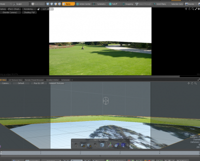

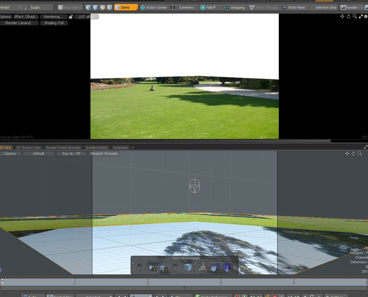

face_off
Posts: 15822
Location: Adelaide, Australia
EDIT: Looking at the release notes it looks like it may have been version 3.2.0.110 but that may have been Front projection mapping was broken altogether. IS there a way to download and test older versions of the plugin?
I'm sure it was working at some stage as I use the vertical camera offset on almost all my scenes to achieve a Tilt-Shift camera effect pretty much essential for ArchViz scenes, however it's possible I'm remembering this functionality from the Lightwave plugin. Is this not possible in Modo?
Hi Dino. That new scene looks like the following in the Modo renderer - so something is not right.
I am certain that the Modo plugin has never supported having the Camera Film Offset effect a texture Front Projection - sorry.
Paul
