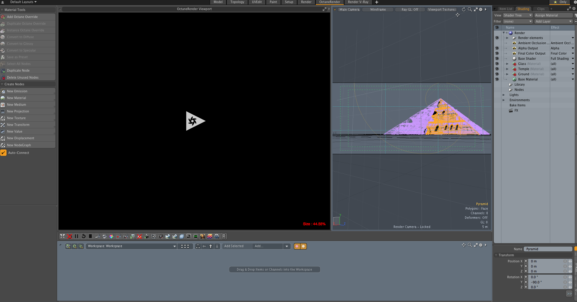

Hi Paul,
I would like to know if you could help me. I opened up modo and rendered using the latest stable build of the octane plugin and everything was fine. A few hours later I rendered again but the render viewport has the octane logo on a black background and the scale of the image in red in the corner but nothing is rendering, its just static.. Would you happen to know what I can do to fix this please. My graphics card is working fine as I just tested vrayrt gpu. Ive tried restarting etc but no luck.
Thanks Mate
Oh, I fixed it. I turned my second graphics card off by mistake. Nevermind.
