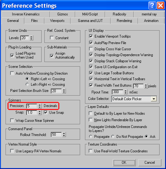

Hello RS Team
The roughness value is also not going below 0.001 for specular material.
Best Regards, Jitendra
Karba
Posts: 2300
jitendra wrote:Hello RS team,
Why the camera preset for dsc315_1 to dsc315_2 not available under 3ds max?
I cant use the 3dmax workflow without those presets because, I have existing product renders which were created with dsc315_2 presets... :(
Please help.
I will add it.
jitendra wrote:The roughness value is also not going below 0.001 for specular material.
This is problem of 3dsmax.
You can set it to 1.0 first and return to 0.0 back
You can set precision else as it shown in this image
jitendra
Posts: 143
Joined: Sat Oct 16, 2010 6:09 am
Dear Karba,
Thank you so much for your help.
I am so happy...
Warm Regards
J
