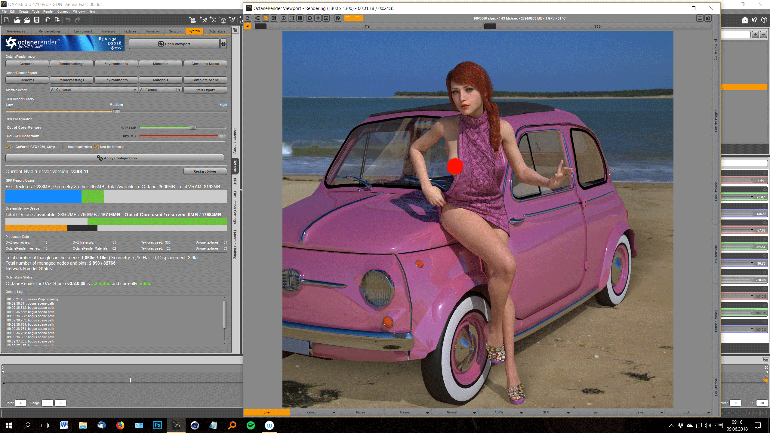

I also noticed in the Octane Log the msg "bogus scene path". I wouldn't have thought it possible for Octane to produce that Log event in the DazStudio plugin. Can you provide a screenshot of the Octane Log window scrolled up from that message?
I now have a new video card: Geforce GTX 1080 8 GB RAM. let's see if there are also such problems with the plugin.
I found out if I install 2 GPUS (1080 / 8GB, 970 / 4GB) then Octane recognizes only the 4 GB ram of the weaker GPU. That's a shame because I could theoretically install 3 GPUs in my PC, I have 2 GTX 970 with 4 GB RAM which would probably increase the rendering performance, but then I do without the large RAM.
Here I have managed this bogus scenario and made a screenshot

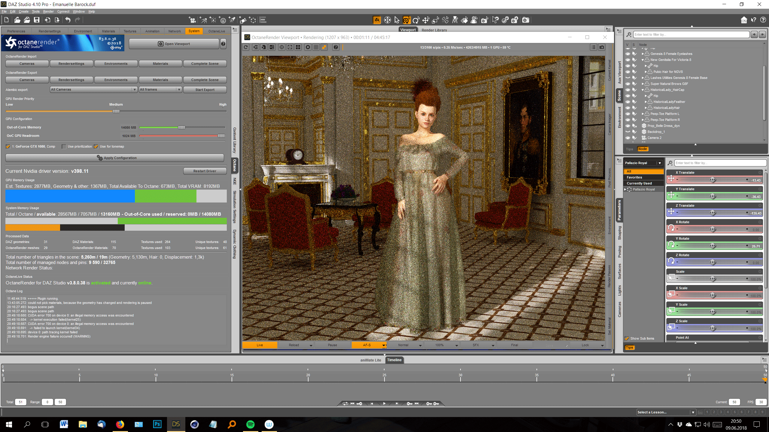

I set up a slightly more elaborate scene and when I changed something about the texture of the dress, the error came.
Neither reload nor anything else bring the renderengine back to work.
If you have saved, you can still render the scene after closing Daz Studio and rebooting.

Can you pls try with the WIP next build (built with Octane 3.08.1). https://render.otoy.com/customerdownloa ... _Win64.exe
